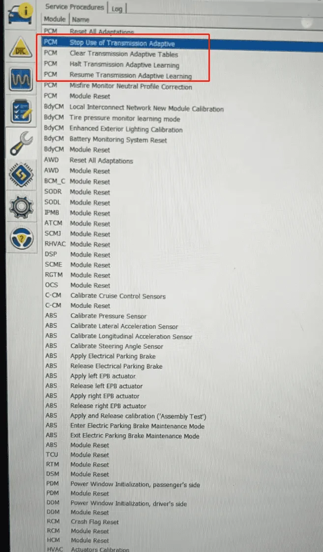

Finally got to drive the truck around today. Happy to report none of the weird adaptive shifting behaviors yet that I encountered after past resets. I have a long commute tomorrow and that will be a better test if adaptation behaviors are truly deactivated. More to come…

If I understand correctly, one reason for the adaptive learning is to prolong tranny life. Is disabling it a good idea?
Also, for those of us with a performance tune, is the adaptive learning operating like stock? I think my tranny is still shifting much better with the tune.

This is just my perspective, but even with the FP improving the shifting, 3-4 shift still had some significant flare at times. Annoys me to no end. The flare is part of the adaptive behavior as when I reset the adaptations there is no flare for the first day of driving. After that it returns. So this theoretically should solve my particular issue.
In regards to transmission life, I have zero concerns there because this transmission is extremely beefy for the Ranger application. Given all the high torque thrashing modified Mustang and F-150 racers put it through and it taking it, the small amount of stress the 2.3 EB puts on the 10R80 is nothing by comparison.

My plan is to reset to base, then lock it. Drive it a bit to see how it performs. If I encounter / notice slight hiccups, I'll activate learning until it clears up, then lock it again. Then keep it locked until the next hiccup. Rinse and repeat as required.

I am not clear as what you refer to as 'flare'. Could you elaborate?
Also, is there any difference in Ford Performance tune and say, Livernois in the adaptive learning?
How do you 'lock it' at a certain point in it's adaptive learning?
It’s a momentary delay in shift with a slight blip in rpm simultaneously between gears.
Turn off ( Halt 3rd option in red box) adaptive learning at that point using Forscan.

When do we call this experiment a win or loss?
