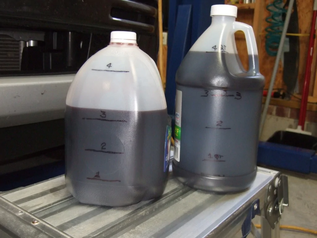

Boy. I'm having that old feeling and memories return just reading your experience. I had that and much more in my truck at 12K miles. I cured it with several members ideas and mental assistance. But I still don't fully trust the transmission enough to have stopped working on the issue.
I tried most everything to cure the issue. I feel like a broken record here, but i"ll say it again. First, what didn't work or made matters worse in no particular order. This is my personal experience and a sample size of one. I'm not stating this will correct anyone's transmission.
What didn't work for me
  • Taking it to the dealer. My 10R80 began failing early on, before the tidal wave of failures. They told me it was working as designed! "They all do it." I never went back. It seems Ford has finally came around and actually starting to take people seriously when they show up with 10R80 syndrome. And that is a good thing.
  • Turning off Adaptive Learning. I did this in Forscan. Things went from bad to downright horrible! I quickly turned it back on.
What did work for me.
  • Changing the fluid and adding LubeGard Platinum. The 1st fluid change made a remarkable difference. 95% of issues resolved. I did the math and changed the fluid 2 more times over the next 1,000 miles. I wasn't happy with 60% clean fluid, and was targeting 95% clean fluid, and 3 changes removing 7.5 quarts each time got me there. Taking out 7.5 quarts req'd me to let the truck sit for 48 hours before performing the fluid change, 24 hours resulted in 5-5.5 quarts being removed.
    (It's not supposed to be this black! 18K miles on the truck when the fluid was changed.)
  • Adding the MBS "FitzStick". It made doing the task above so much easier. I parked the truck and waited patiently for Fitz to work his magic. I had already purchase another generic dipstick on the market, but was disappointed with it. It still hangs on the wall in my shop. The Fitzstick allowed me to easily replace the fluid by sicking it out the dipstick tube using an inexpensive electric pump that came with everything you need to do the job. 45 minutes and the fluid was replaced with the exact amount that came out. All without a drop being spilled and me crawling under the truck.
  • Resetting the Adaptive Learning Tables and Performing the Adaptive Learning Drive Cycle. After the above I drove the truck for a few thousand miles, and things were much better, but I was gun shy and vigilant, monitoring for any symptom that might present itself. I found little telltale signs of slightly abnormal behavior. I performed this simple procedure and the transmission immediately tuned itself into near perfection. Don't attempt rhis before having changed your fluid. You'll only be masking the problem.
Enhancements that extend fluid change intervals and the life of the transmission
  • Adding an aluminum transmission pan. Cooler tranmsission temperatures matter - ALOT. I purchased the PPE deep pan that hold 1.75 quarts more fluid. It has a drain plug and aids in keeping the fluid cooler.
  • Scangauge III. Necessary for me to easily track dynamic engine and transmission PIDs. I can see shift slipage, real vs targeted and transmission temps realtime as I'm driving around, and I have learned a great deal from observing transmission behavior vs temp ranges.
  • Keeping the transmission fluid temperature between 155F-165F. My transmission is flawless when it is operating in this range. The higher the temps raise the more the anomalies present themselves. They are slight even at 200F, but they are their. Further, transmission fluid begins to rapidly deteriorate the higher the temperature. To this end, I'm currently in the process of building a transmission cooler that keeps the fluid as close to the temp range as possible.
  • Optimizing the shift pattens of the transmission. Use tow or sport mode, or purchase a tune, rather than use the normal drive mode. The extreme low RPM shift patterns and resultant lugging on exacerbates the stresses on the clutch plates and fluid life. It needlessly loads the drivetrain at the worst possible power curves. Ford traded longevity on the alter of EPA goals.

  • The Fitzstick allowed me to easily replace the fluid by sicking it out the dipstick tube using an inexpensive electric pump that came with everything you need to do the job.
Any chance you could post a link for that pump? I’m having trouble finding the right diameter tubing to fit down my Fitzstick. I have a PPE pan to install, but I’d like to minimize the mess as you did.
