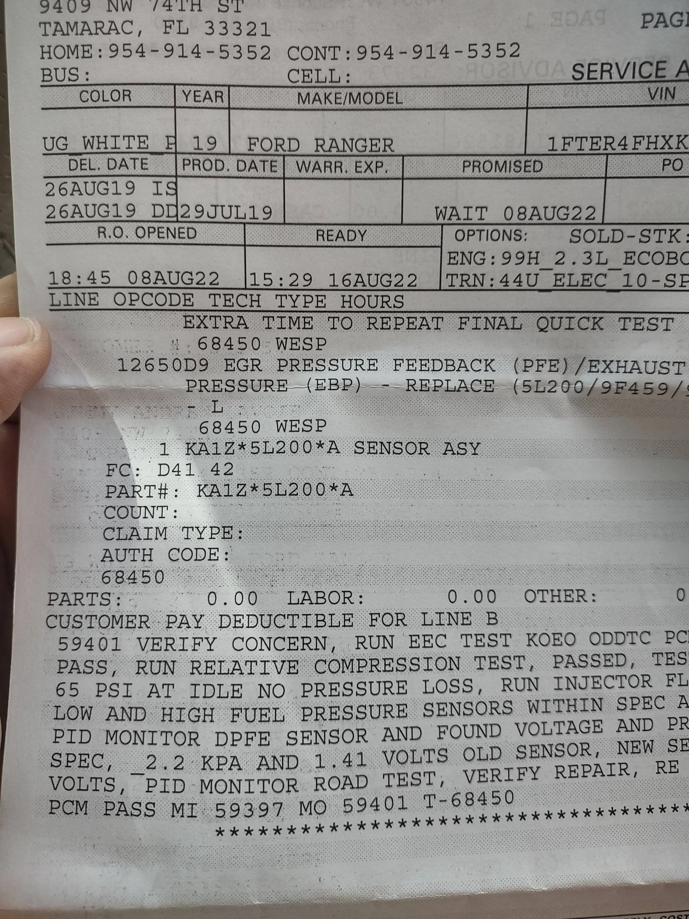

Glad you finally got it fixed right and a new TC out of it too. lol I ordered an EGR valve to have on hand as it seems imminent this WILL happen soon. They're on national back order but should be off by next week.
Do you happen to have the part# handy for this?

Thank you FX4Offroad. Part KA1Z-5L200-A (EGR flow sensor) did the trick. Runs like brand new! For those of you who have not tried this, it worked. The hose clamp system is an 'ear clamp' system. You will need the ear clamp crimping tool (get the dual front and side jaws), ear clamp cutting tool (for removing the old clamps), and a variety set of the ear clamp rings.
