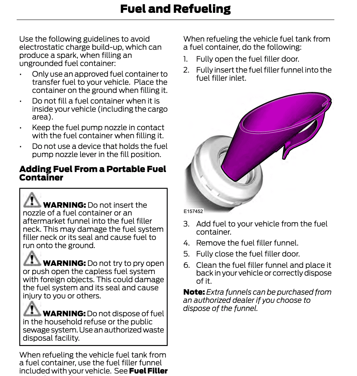

Have a regional grocery and convenience store chain that gives you fuel points for buying groceries and a discount on up to 30 gallons. I’ll take three five-gallon cans with me. At home I have a power steering fluid funnel that’s about 2 feet long and slides into the capless filler just fine. I cut 2” off the end so the hole was bigger and it flows faster.

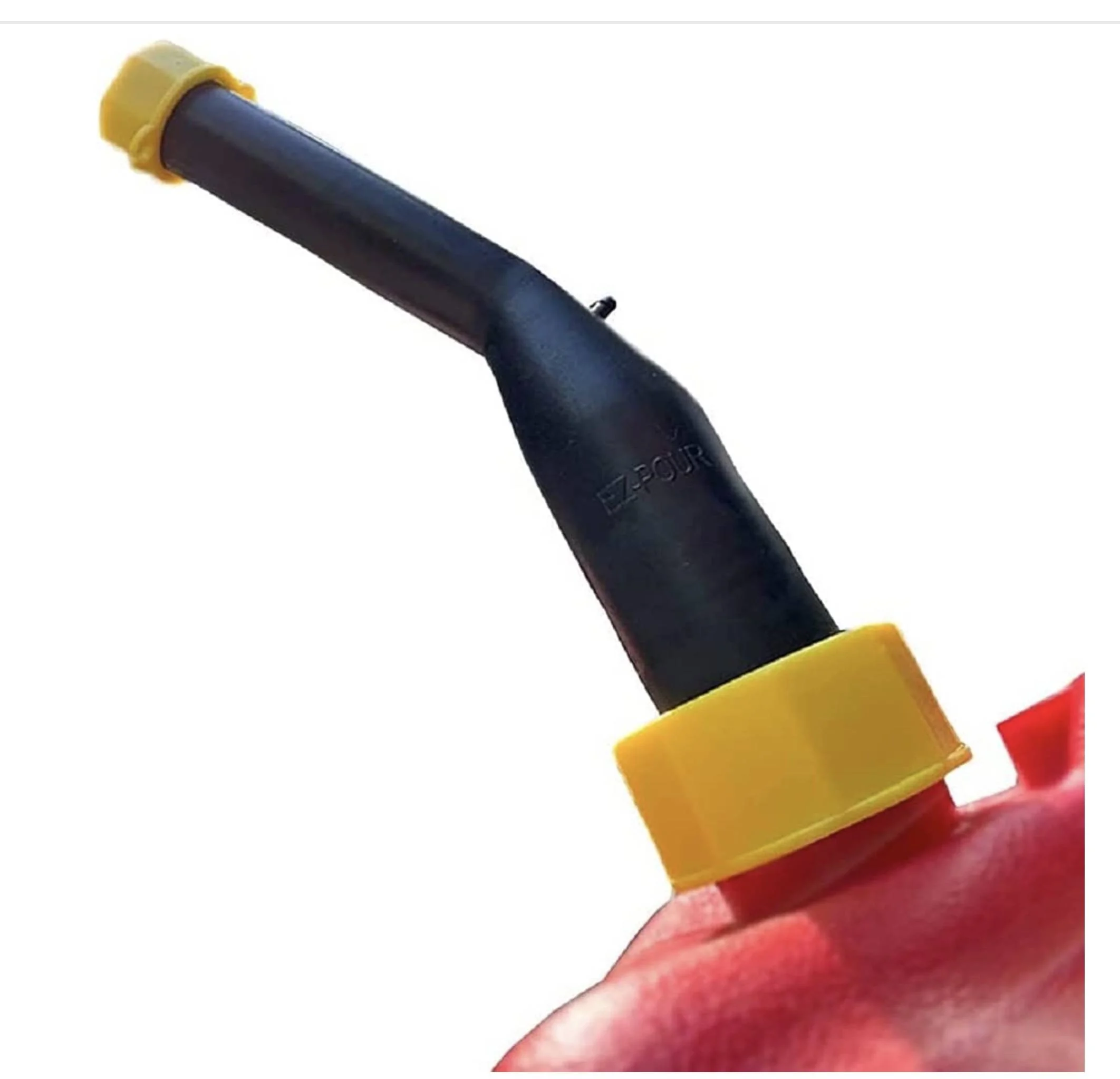

These 5 gallon gas can spouts from Amazon fit the capless filler perfectly without spilling gas. I installed a vent with a cap on the can to allow the gas to flow much faster, empties the 5 gallons in about 30-45 seconds.

Yes, these fit the 5 gallon poly gas and water cans, I wasn't happy with the included vent so bought a better one.
Spout
Vent
Gas Can - The can is great but the included spout is crap.
