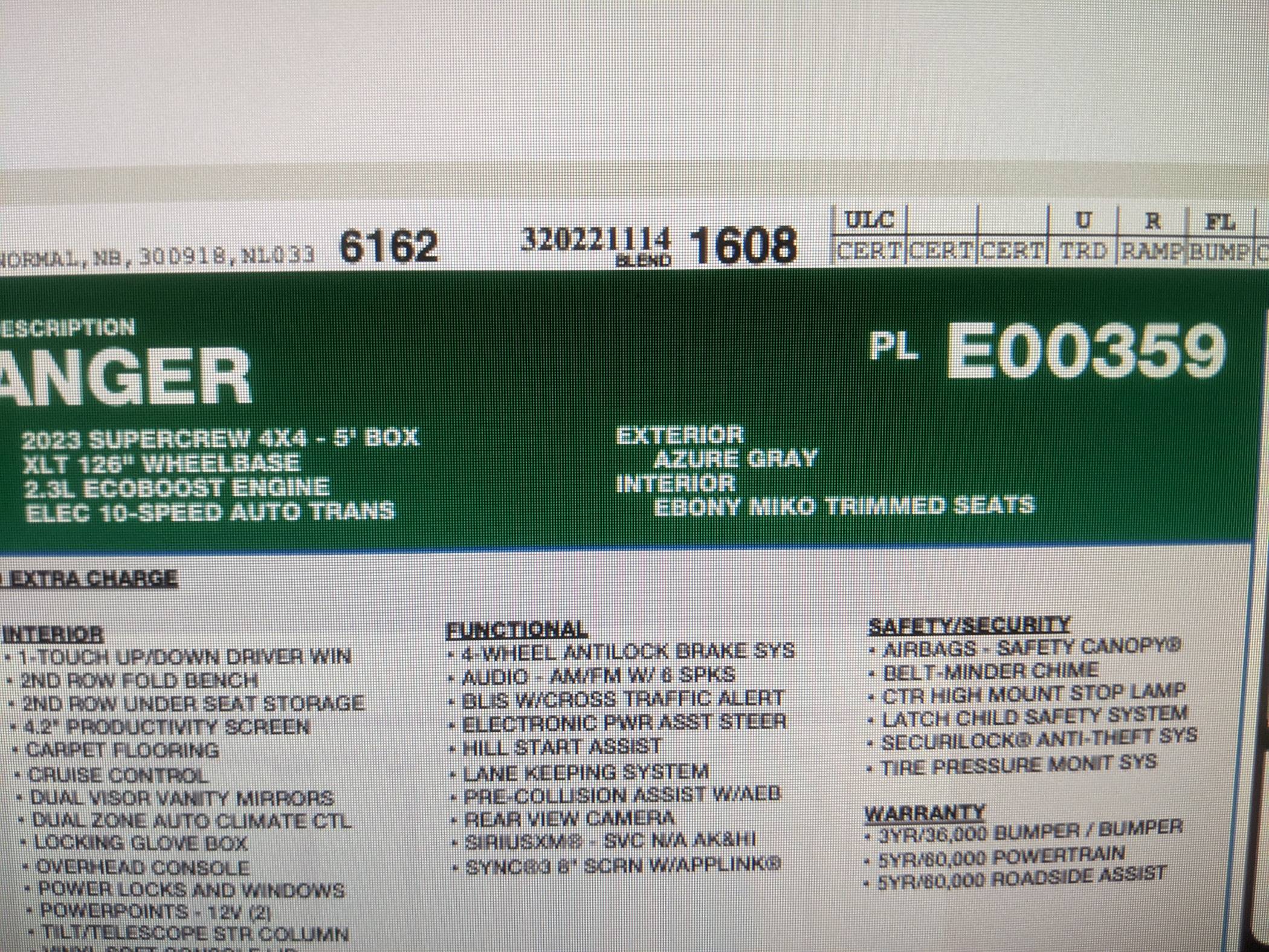

When was your build date?
October 2022....I took delivery Dec 2022...
Vin 00359 of 2023...
Edit - the dates sounded wierd. Blend date was November not October of 2022.
Per the TSB yours should have the updated CDF drum ( 08/22 and beyond). They still can reflash the trans and if that doesn’t improve things then they will address the valve body ( clean or replace). But for vehicles built after 08/22 the they wouldn’t proceed with the CDF replacement.
