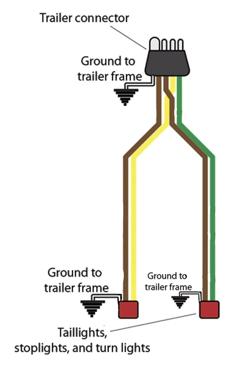

Howdy yall,
I recently picked up a trailer light kit, and I've finished wiring everything up, but I've had no luck getting any lights to turn on. I've plugged in a 4-pin connection tester, and everything worked fine there.
I've got all three of the ground points (one from each taillight, one from the connector) clear of paint and attached via self tapping screws. The ground points at the front is on the trailer tongue, and was also prepped the same way. I'm not sure where I'm going wrong here.
Any ideas? Surely there's not something obvious I'm missing? All my connections (four) were made with heat shrink butt connectors. I appreciate any help.

Each taillight has a white ground wire running from it that are both individually grounded to the trailer via a self tapper.

Also, I have a spare 7-pin to 4-pin adapter. I've tested this adapter with the 4-pin connector tester, and the lights on the tester lit up properly, both running and turn signals. I've read conflicting information on if they have resistors built into them or not. I've tested the lights both with and without the adapter, and neither have worked. But from what I've read now, the problem lies in the lower power draw from the LED lights, as you @ControlNode figured.
