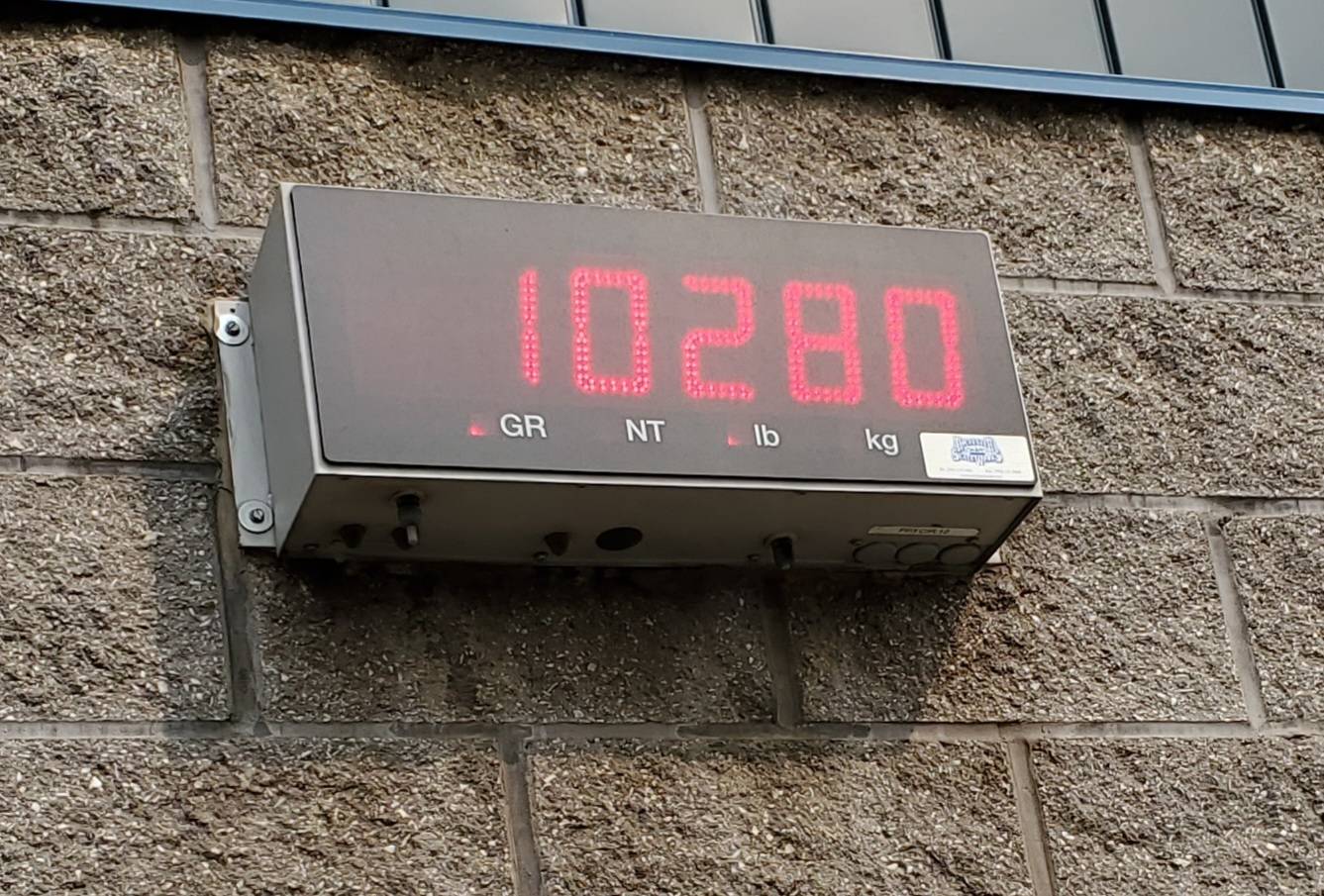

I have a rough country lift and have towed some pretty big loads, Zero Issues
a few weeks ago I got a picture at the scrap yard with 5100 lbs on my trailer plus the 5100 lbs of my truck
10200 and didnt know it was back there, I think you will do just fine :)
I probably use and abuse my truck more than most here, I will push it to its limits and take one for the team so we know just what we can get out of them :)

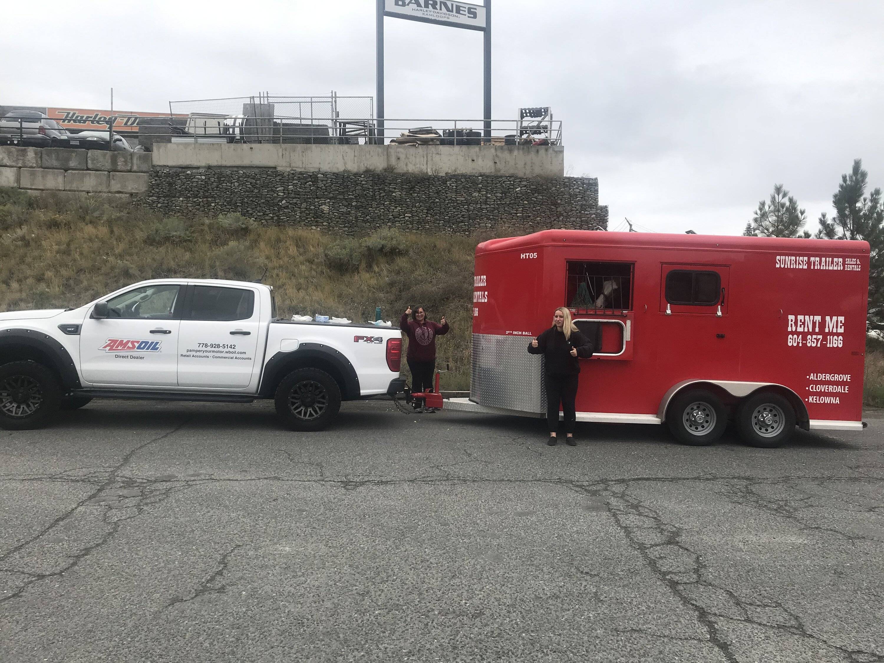

5600Lbs with a 2.5” leveling kit. Little bit of a squat but no problems at all towing through mountain passes across 2 provinces.
That is more than a little squat sir...... Either get different springs in the rear or get a WDH for the trailer. It will make the towing experience much more pleasant

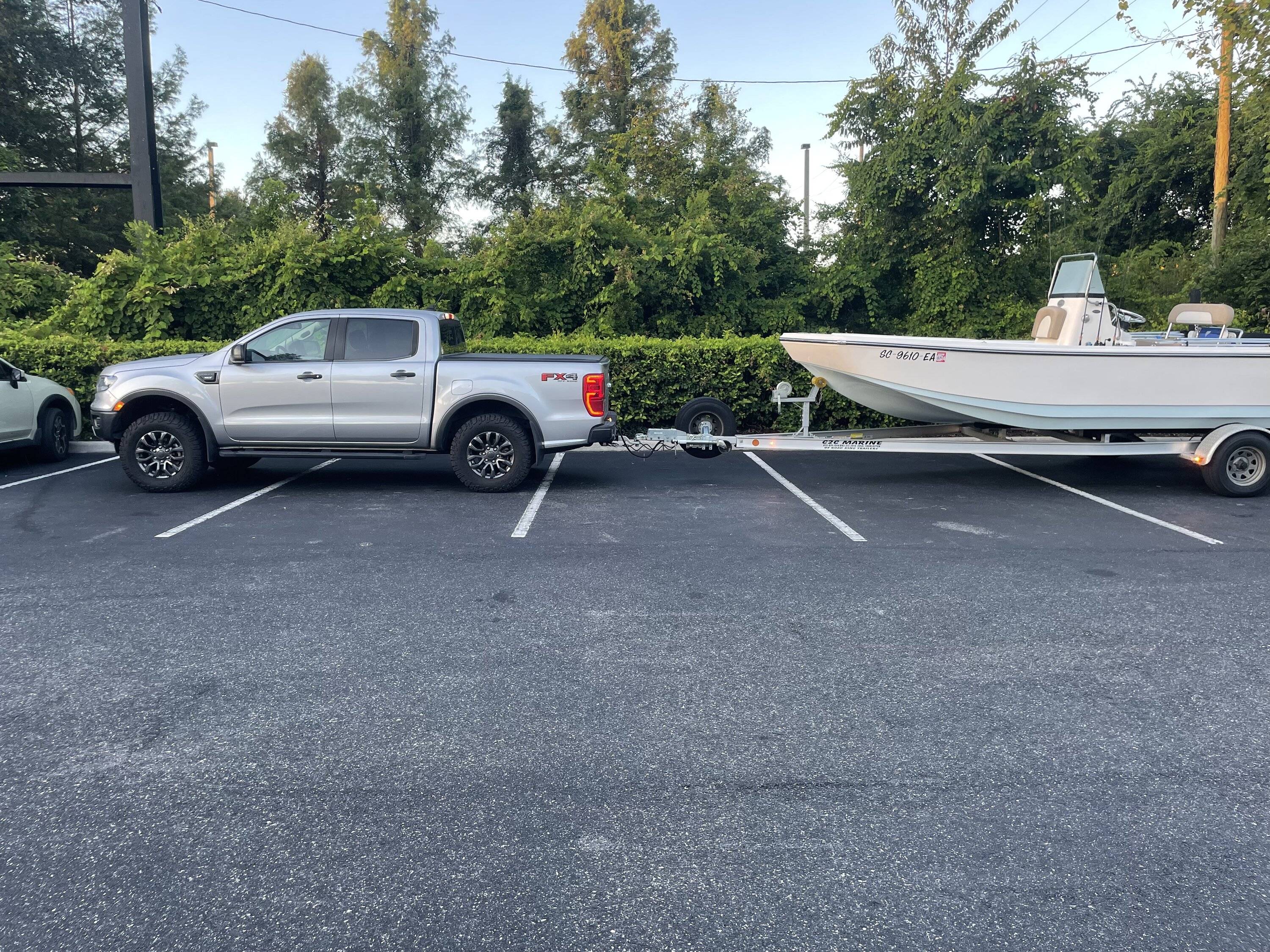

I towed 1200 miles with a 2.5in level with 265/70r17 tires with no issues at all. The bed was crammed full of stuff as well.
