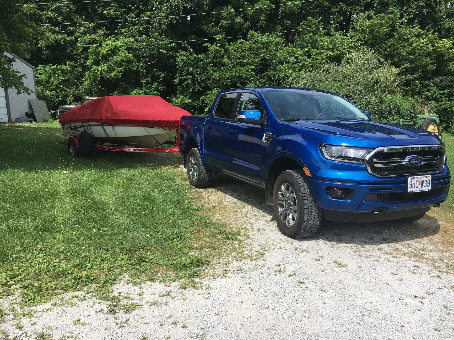

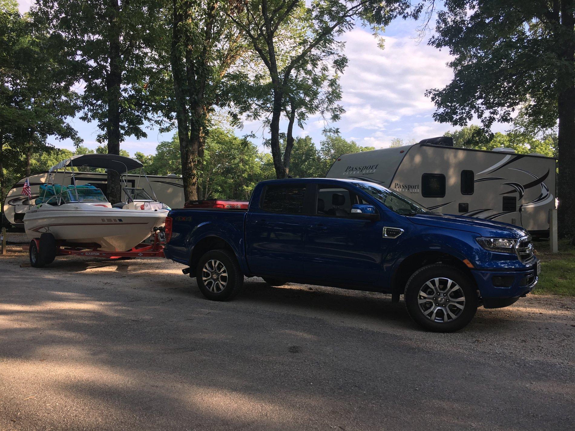

On the way home from the lake last night I must have gotten bright light flashed 5-6 times on a 50 mile drive. It’s not like I had a ton of tongue weight either. It must be really bad with an actual full load. Do the LED headlamps have a traditional screw adjustment? Any other suggestions? Turning off the fog lights didn’t seem to help.

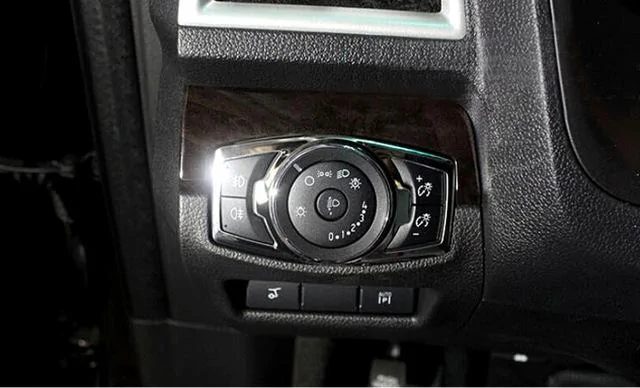

I was very surprised when I heard the lariat didn't have auto leveling or the in cab adjustment like the global Ranger & Everest has.

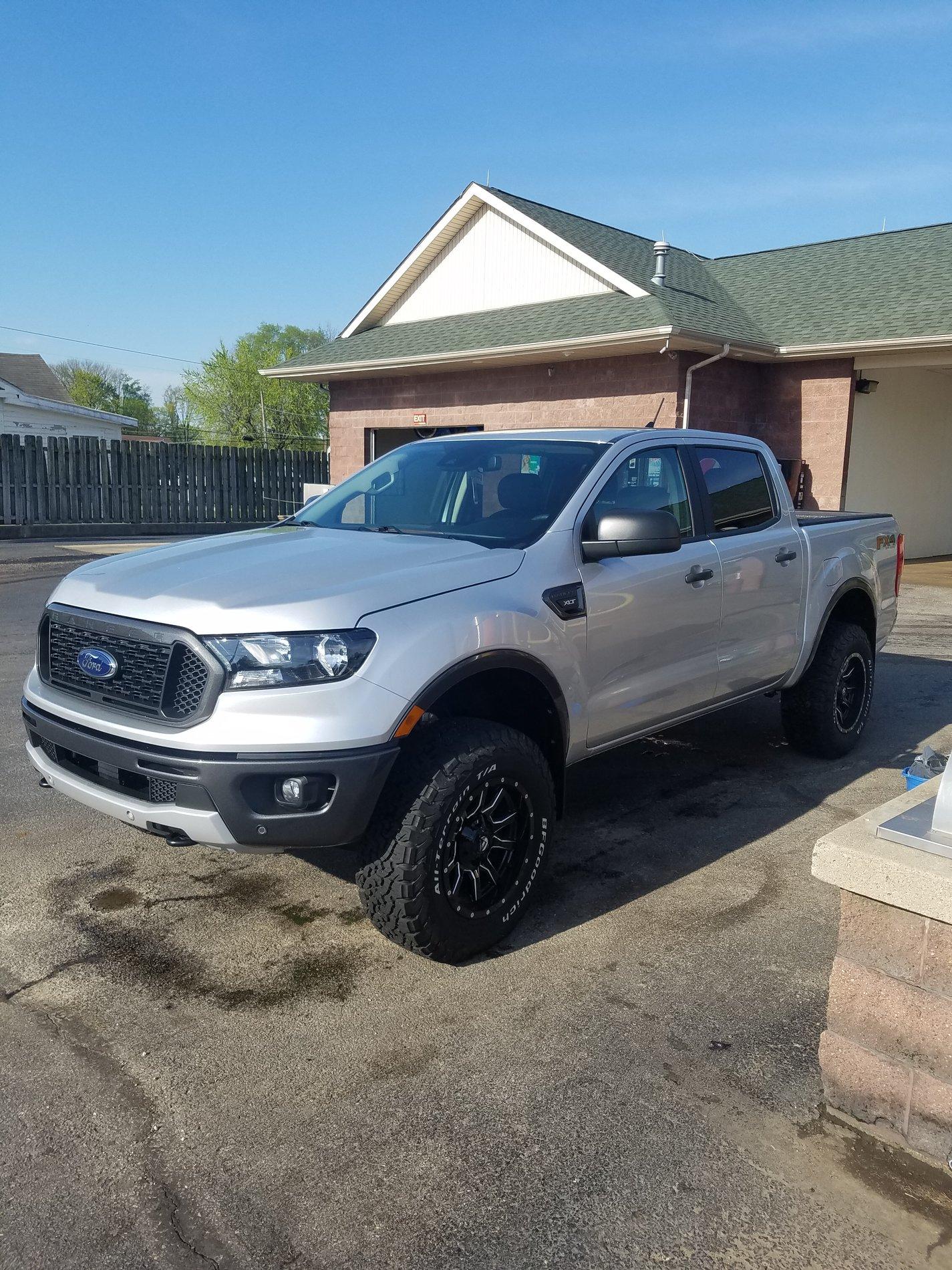

I did get flashed quite a bit when I got my 2.5in Rough Country leveling kit put on the first few days until I finally got around to readjusting my headlights now I dont get flashed anymore thank goodness.

I didn't get flashed but I could see I was lighting up people's interiors and overhead signs after my 2.5" Rough Country leveling kit. I adjusted them down by parking in front of the closed garage door, using tape as a reference, and then used a 1/4 inch ratchet + small extension and I think 8mm long socket. The adjuster screw is easily accessible, gotta crank it a few times to see adjustment
