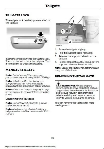

This might have been answered elsewhere - But anyone know how much weight the tailgate can support?
I think I remember reading it is rated at like 485lb according to owners manual
So really, probably about 550lb.
Per the Owners Manual: 485 lbs, unless you have a "load bed extension" then the max weight is 110 lb.
