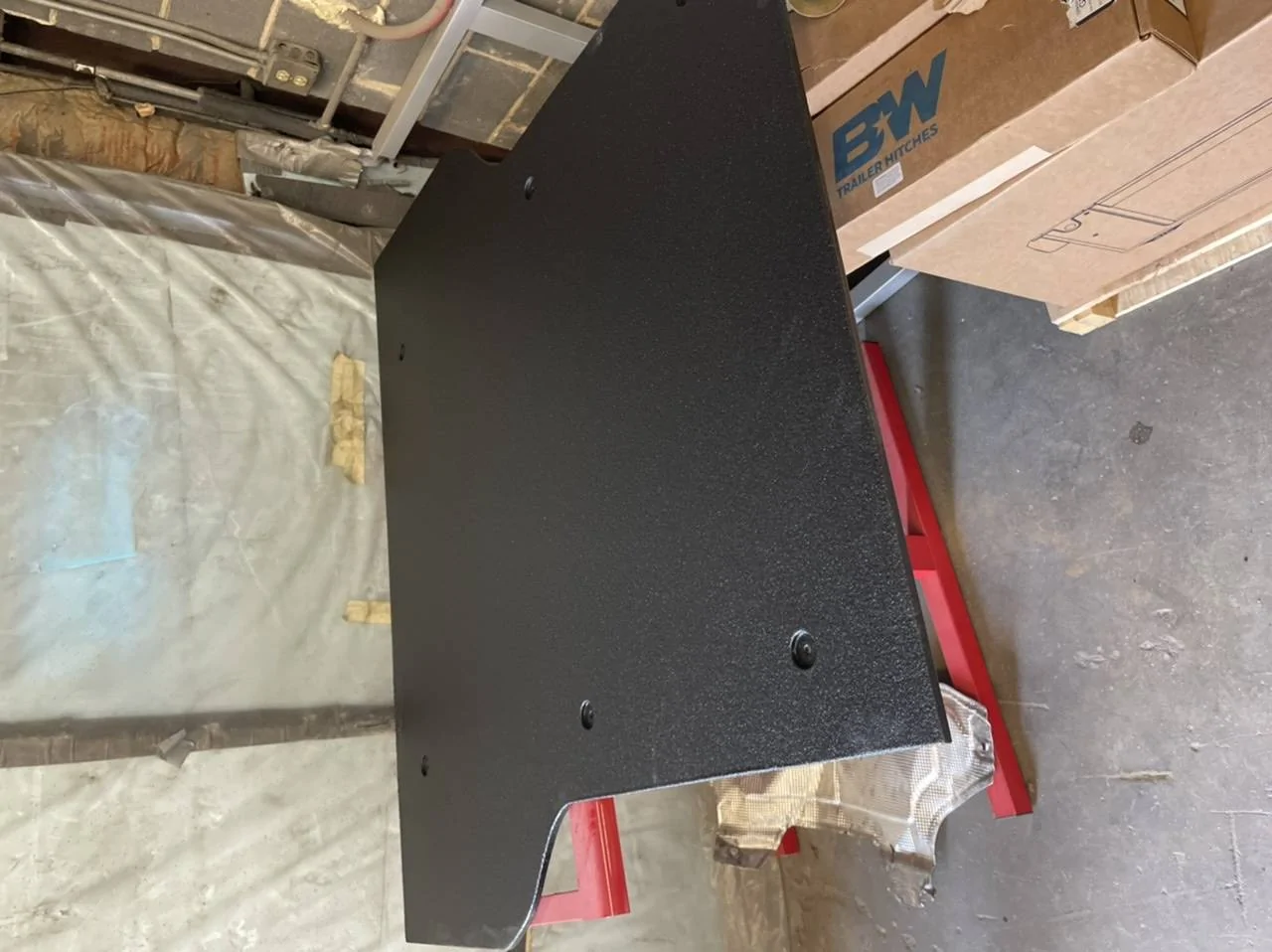

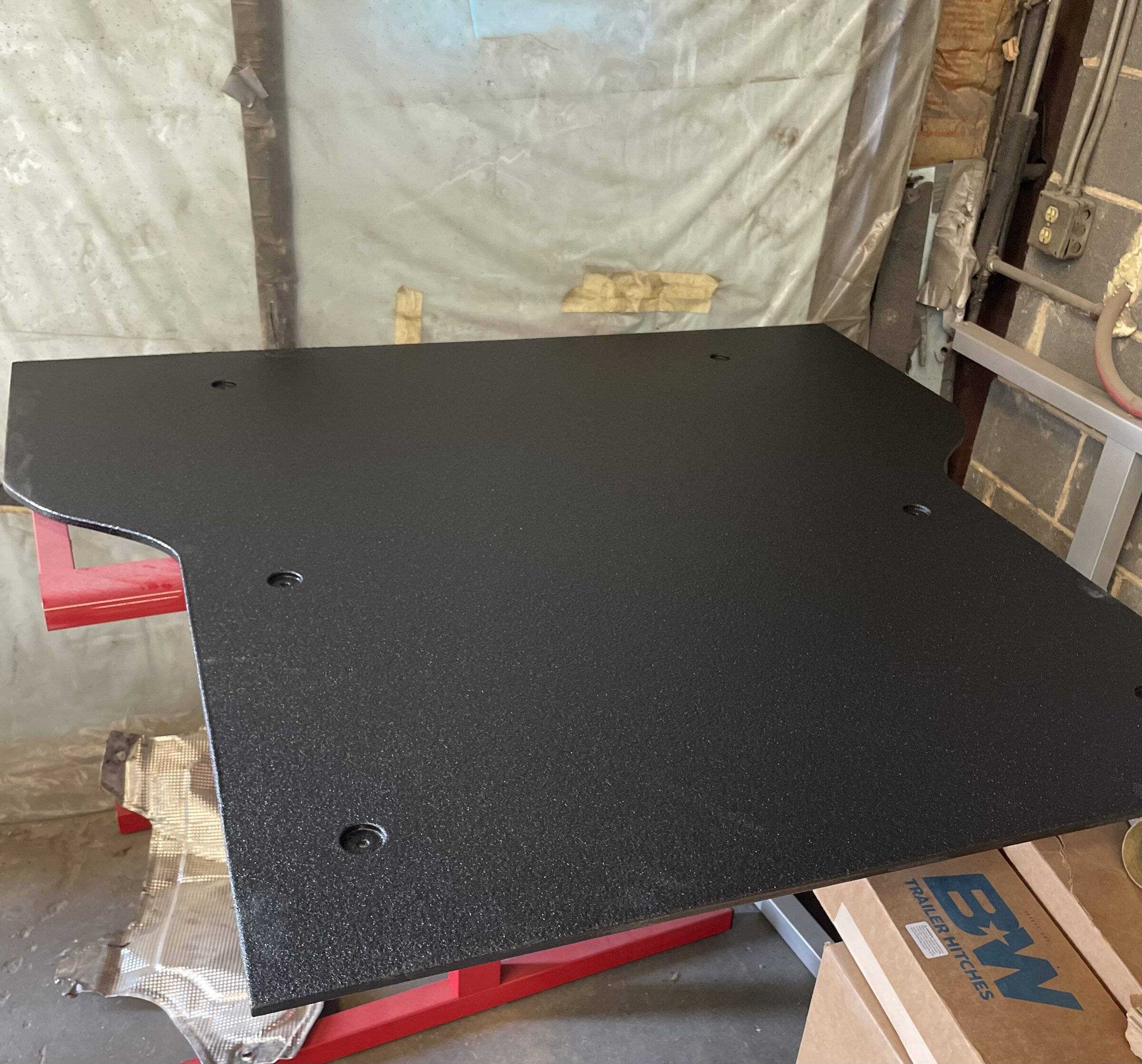

Got the gear plate bed lined this week. Getting everything coming in to start the electrical setup for the bed area. Victron Energy and LionEnergy will be the majority of the dual battery system going in the bed.
