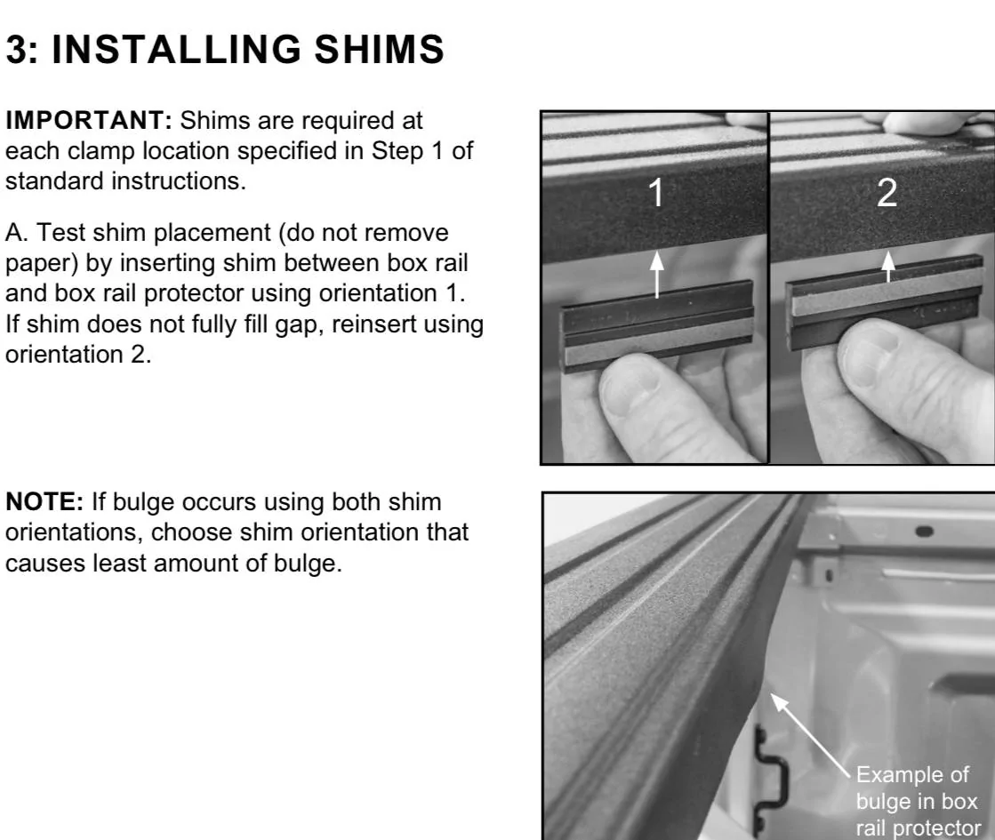

I have a new set of clamps and shims coming as well. Eddie was very helpful with the noise issue I had earlier and we got that resolved so the cover is nice and quiet. I’ll check which direction is recommended to install the shims.
Here is what the instructions say:
137,212
I have a new set of clamps and shims coming as well. Eddie was very helpful with the noise issue I had earlier. I’ll check which direction is recommended to install the shims.
/QUOTE]
The directions weren't the greatest as I'm sure you noticed. Eddie knew exactly which way they should be facing so you don't have to go through trial and error of the rails falling off. Hopefully this works out for you as it is a great cover just a PITA because the directions weren't the best. Good luck!

Ok, I believe I got it. I loosened the clamps and wrapped a vice grip jaws in electrical tape. I then worked the plastic bump back down to level out of the side rail cap and clamped the rail to the bed with the vice grip. I then tightened up the clamps.
I added the second set of clamps and shims that Access/Agricover sent me to hold everything in place but I think first getting the trim the rail and the truckbed flange lined up and clamping them with a vise grip really helped. The vise grip held the plastic rail cap and bed flange so the clamps could not create a twist.
