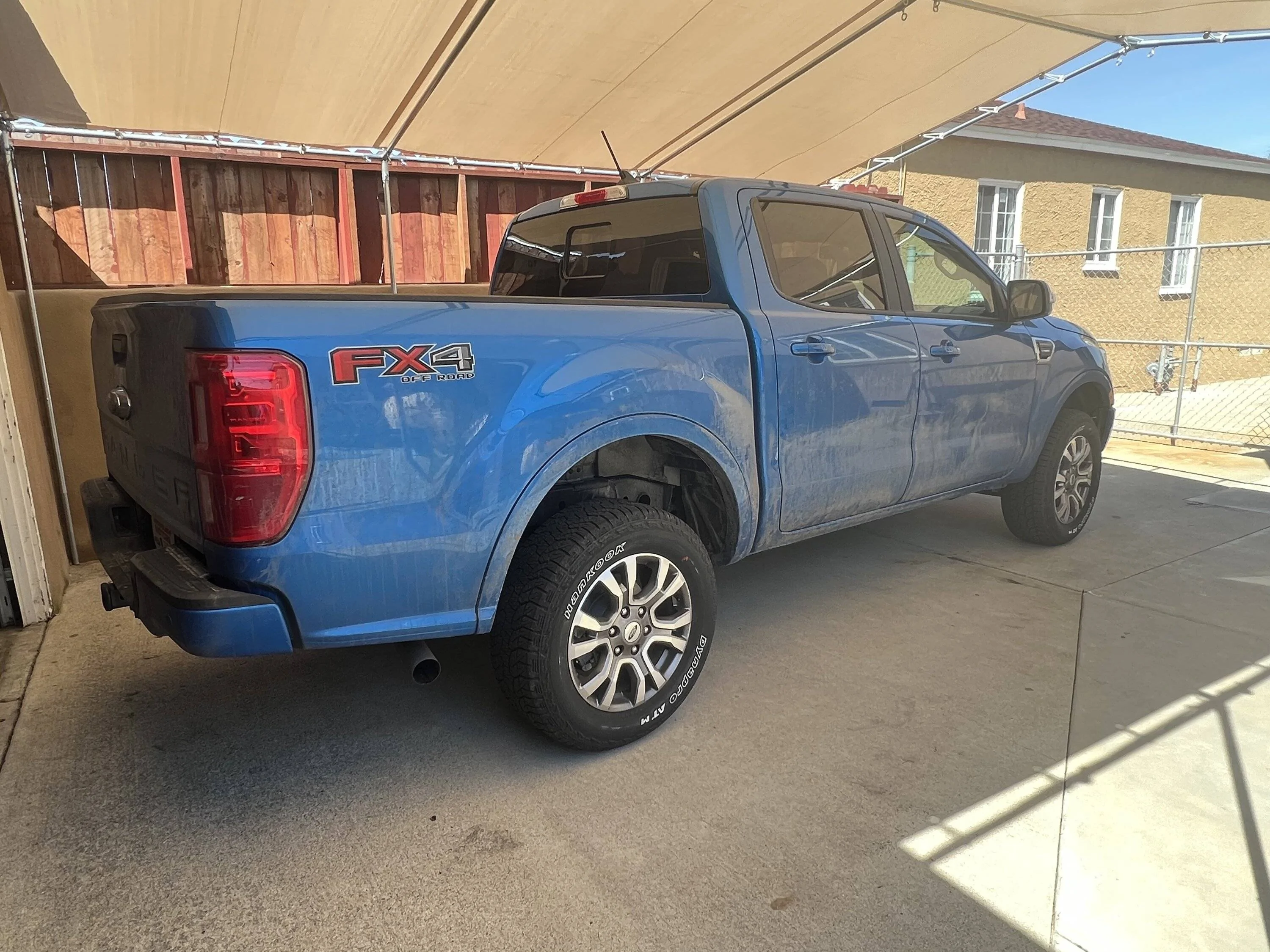

Basically, what size tire can I fit in there with what offset or back space wheel, 17 inch. 2023 Lariat FX4…. In 1 to 2 weeks I will be installing myself some camburg, upper arms, fox coil overs with reservoirs, which I believe are 2 1/2 to 3 inches. Trying to figure out what size tires could fit and what is the right offset – backspace. Thank you again. P.S. I did look at older posts and I did not find exactly my application, but close to it that’s why I am asking again and again thank you for your help..

If you don’t want to touch crash bars I think you can do 265/70/17 on stock rims. If you want bigger 275/70/17 May work but rub on stock rims. You will likely need to modify crash bars. 285/70/17 and you are on a lift with modified or removed crash bars. Stock rims should still work but a +25 or +30 offset will help. I’m only regurgitating what I have absorbed from all the threads as I haven’t upgraded yet. I’m torn between tremor size at 265/70/17 and going 33’ish with 285/70/17

I know you’re looking to lift so stock max size is only part useful, but 255/75/17 fit. I have these, a true 32” tire with zero mods, zero rub. Skinnies are better performing in nearly every scenario.

I ran 285/70-17 Firestone Destination XT's on my 2019 Ranger with the Old Man EMU lift and all I had to do to the front crash bars was removed the plastic and push them forward a little. Only had rub at full lock. The moment I backed off of lock(1-2°) it wasn't rubbing.
