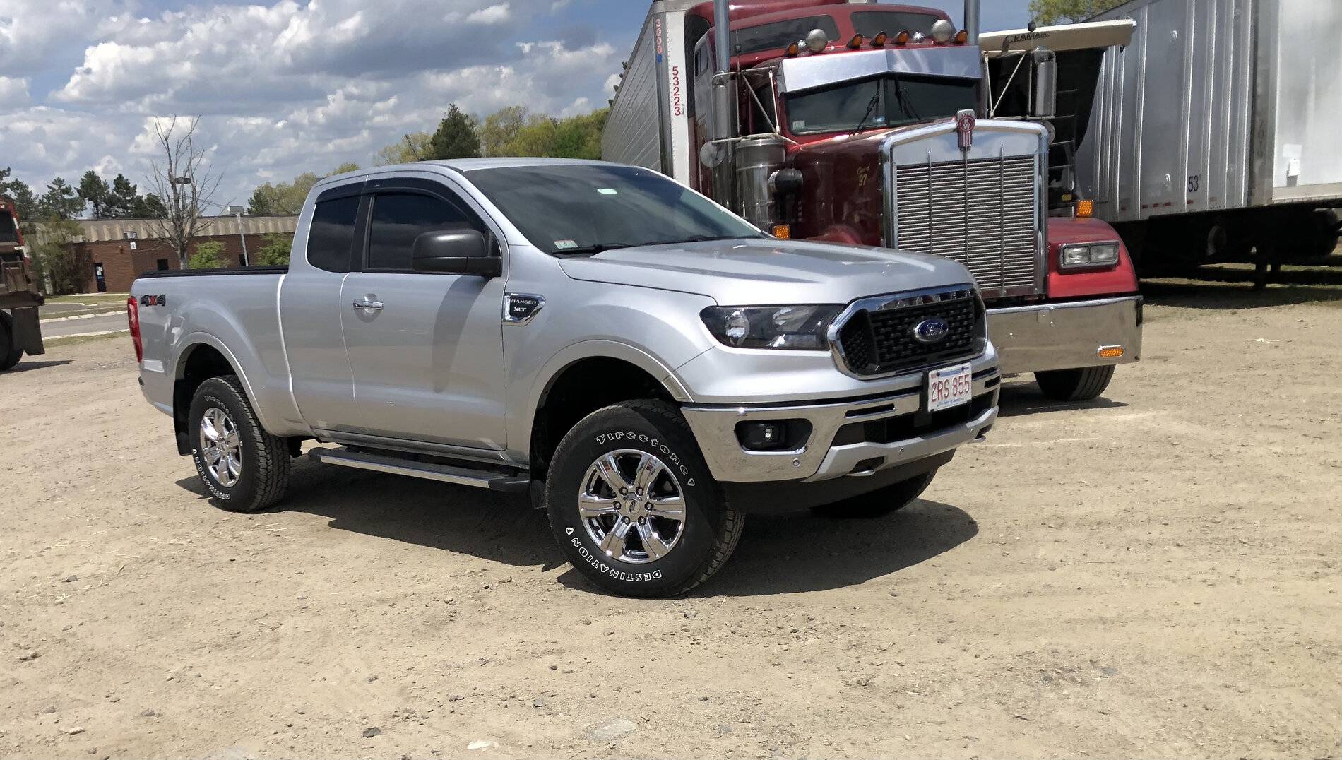

255/75r17 are 32.8” tall, which is what I have on mine
