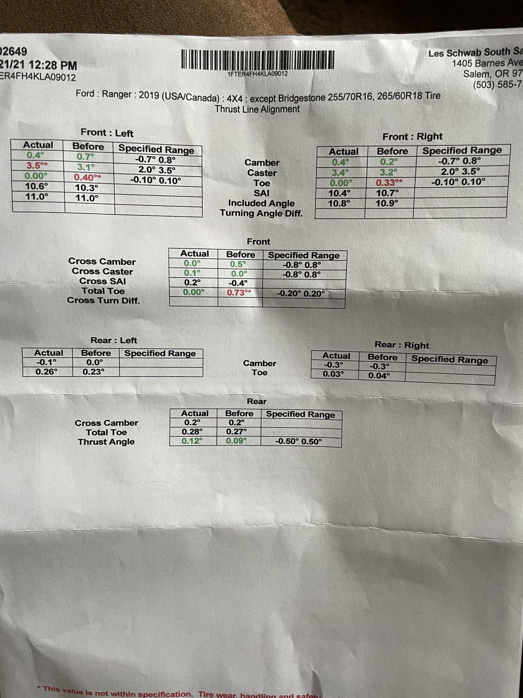

Tire shop can’t align my Ranger properly.
GitRDone
Andrew
Nov 25, 2020
446
1,245
Orlando Fl
2020 XLT
Real estate management
It’s hard to tell from this pic so let me know if I’m being to OCD.
this is how I have to hold the wheel on the freeway to go straight. It is not horribly off but just off enough to drive my ocd crazy.?

I don't think anyone answered, but yeah larger tires and a lift will cause premature wear like the tie rod. However, tie rods are cheap, why not replace it to be safe and take it to a better shop?

Why would they do the alignment with a loose tie rod? Your tow is gonna be off.

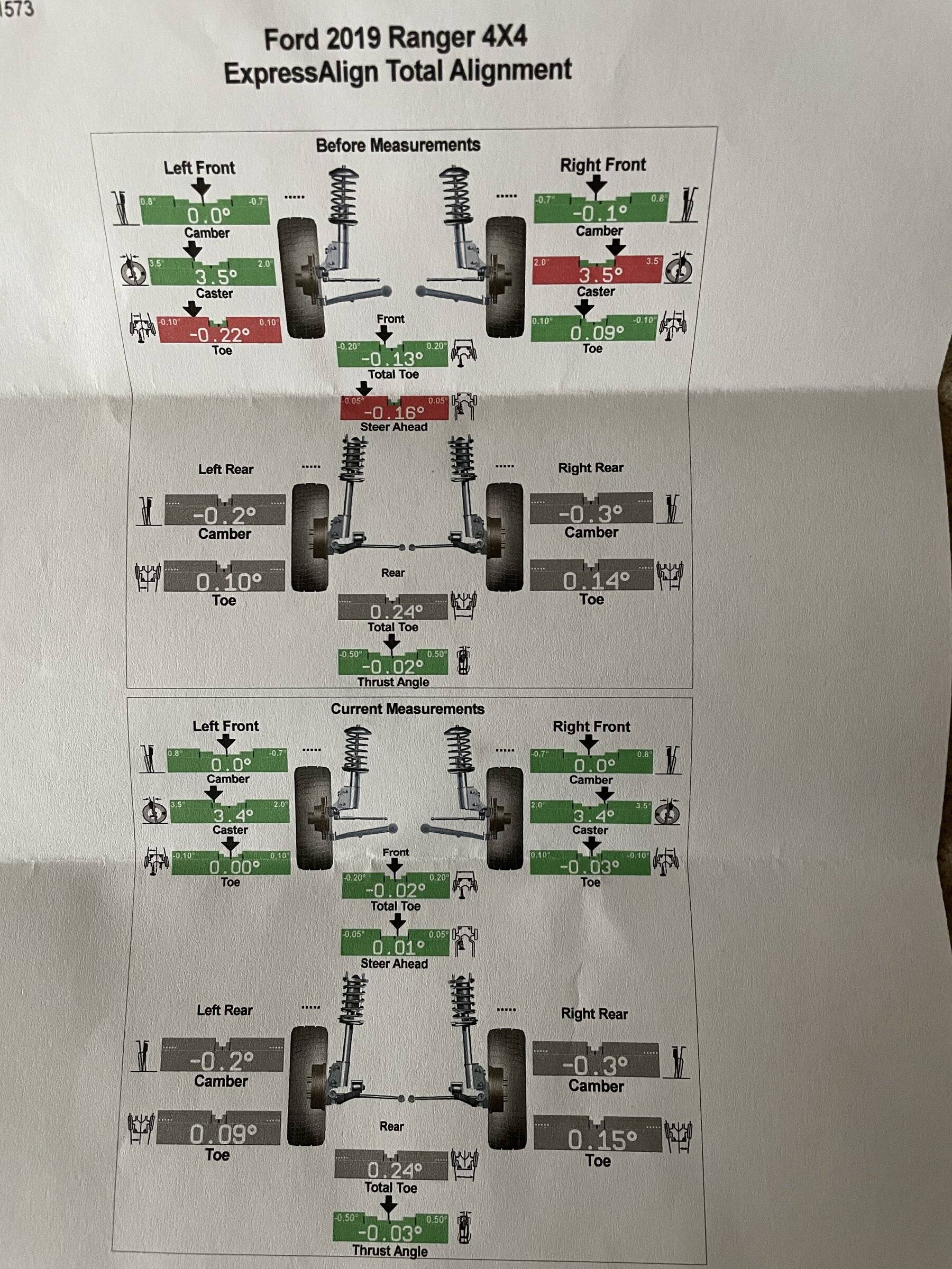

I have the same set up with a 2.5" level and 265/70/17 Nitto Ridge Grapplers. It can be aligned right just bring it to another shop who knows what they're doing . Here's my most recent alignment (Brakes Plus) which you can see the before and after.
you must have a decent brakes plus, I gave up on one nearby after they agreed to but then totally ignored the alignment specs I provided them - and they were only slightly different from factory. Very agreeable polite customer interface skills but execution badly lacking.
One of my supply managers recommended them as he has a Jeep and has had them do a lot of work on it and was happy with it. The customer service is really bad out here so it was nice to find a place I could trust to do the job right and has great customer service.
