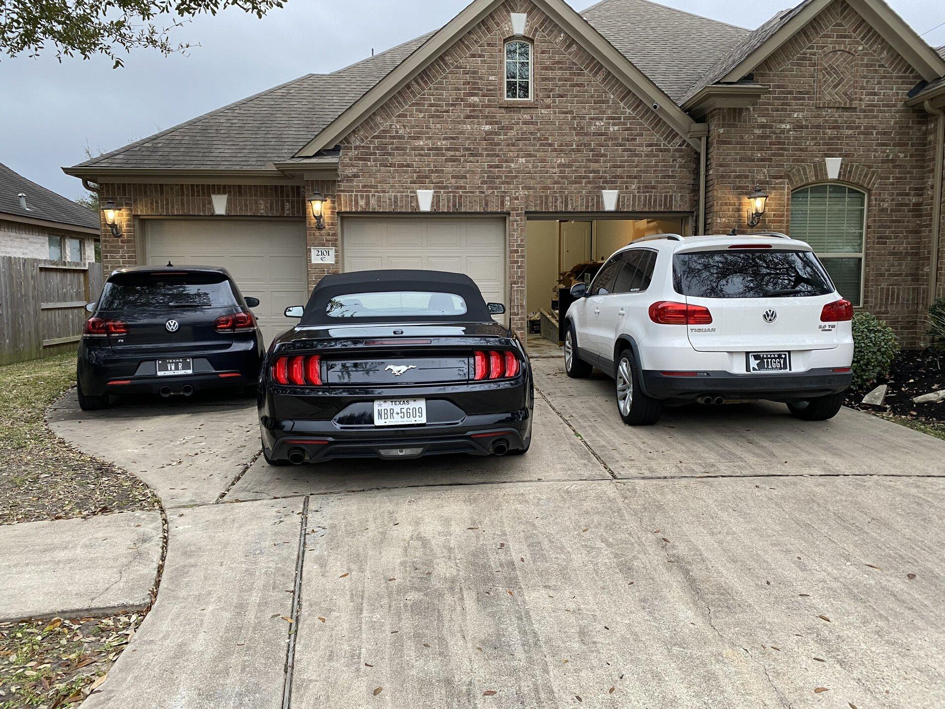

Ok, you KNOW the rules of the NET......Pictures of the stang and said wife or post will be deemed inapproiate and deleted.
Prepare to delete me ??

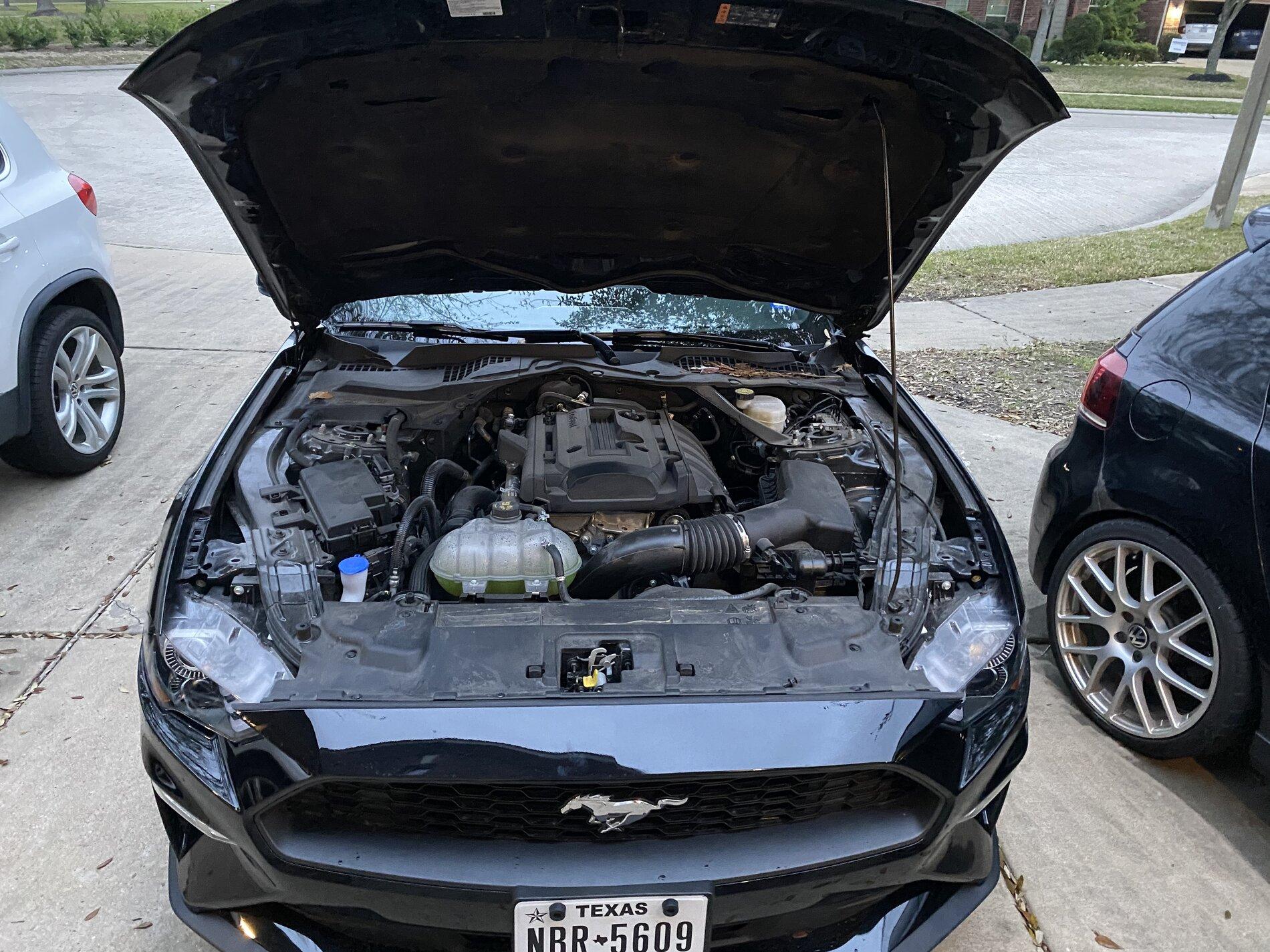

Oh my, what can “All My Mods” do to destroy this engine?? Ford, please tell me...

Before you flash that mustang....
Possibly, a different motor than the mustang?
“There is a thread on this forum (link below) that shows some of the engineering differences that the Ranger engine has. The head/top of the block is more like the RS engine, the inlet is basically the same as the Mustang. The sump and oil pump setup is unique to the Ranger.
The other known major unique parts are the oil cooler/filter setup and the electronically controlled wastegate (wastegate =/= blow off valve, the wastegate is in the turbine side, the CBV is in the compressor side).
I'd imagine the compressor bypass valve is the same part common to all of the 2.3 EBs. PS it isn't a blow off valve, it is a re-circulation valve.
Be warned that the way airflow is measured in these engines means that letting air out of the system at the turbo can cause fuel metering issues. It most likely won't be enough to throw a code as it doesn't in the RS etc, MAF is measured up near the air filter in the piping.”
Regards
Doc
https://www.ranger5g.com/forum/threads/2019-ranger-2-3l-ecoboost-engine-intro.1018/
Doc, that was just a joke.. not gonna flash my rental ?
