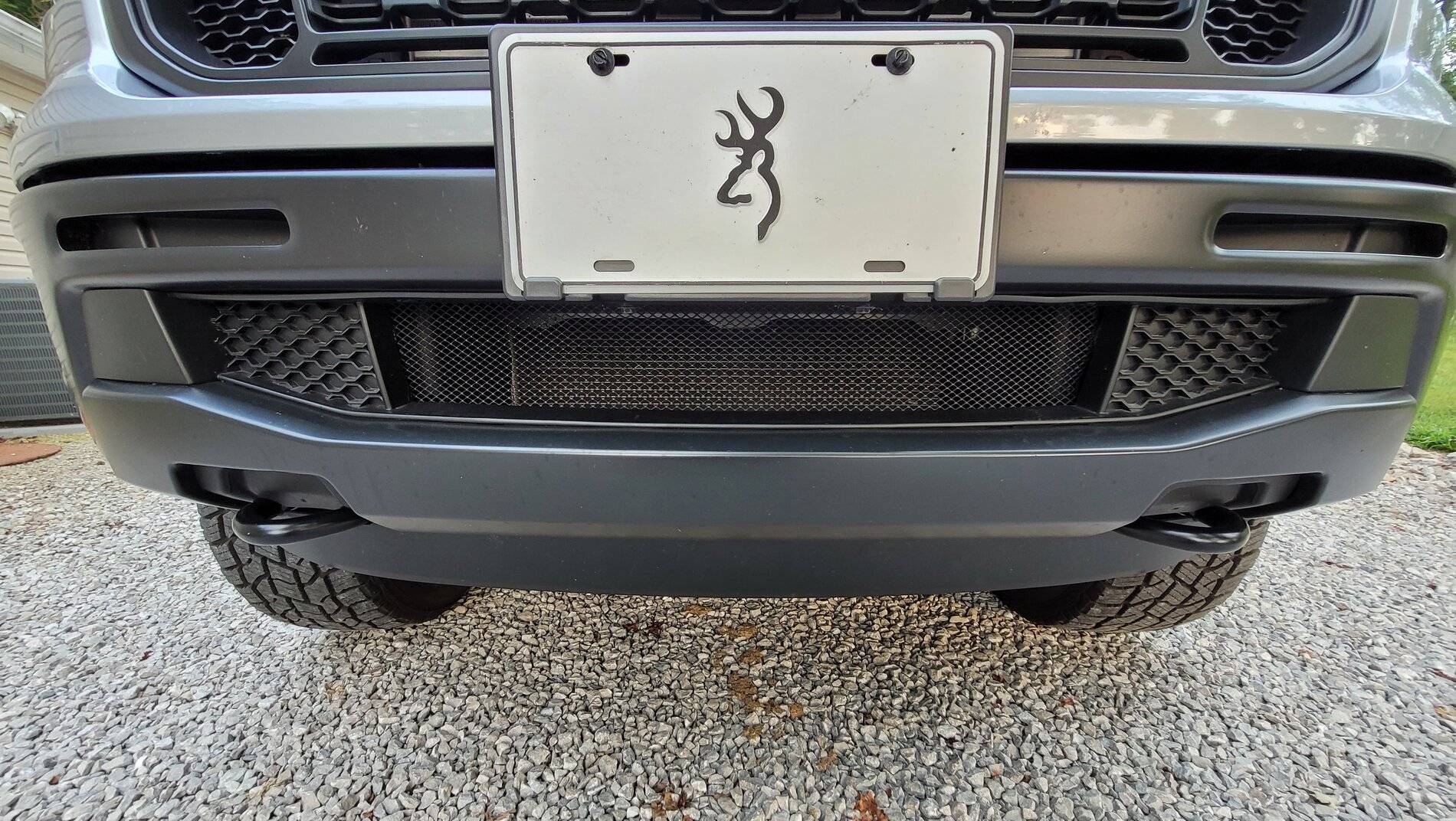

Just got my 2021 Ranger Lariat - no adaptive CC, was wondering why there was no protection for the intercooler. Ordered the Mountains2Medal grill. It attaches using the plastic rivets at the top of the opening instead of bolting to the license plate frame mount and double-sided tape like the Putco. Wish it attached at the bottom too. I'll post after the install and a year later - we'll see which one holds up better!

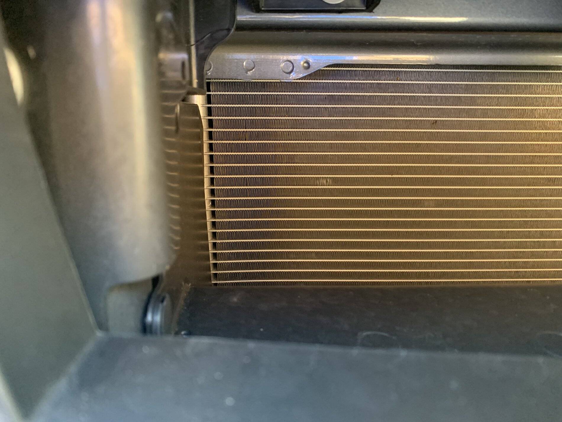

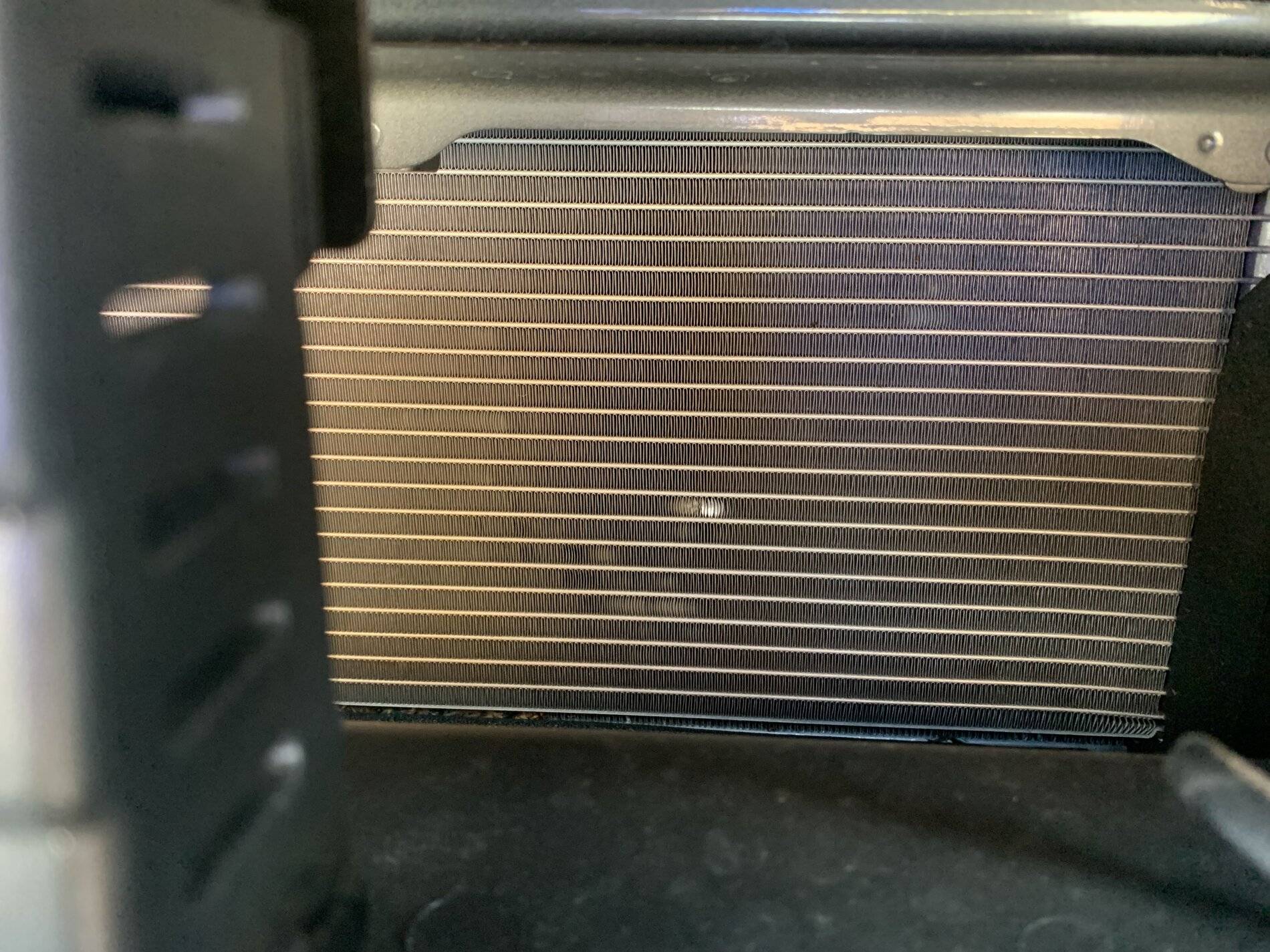

I just looked and I have some dents in whatever that is down there(ac condenser or radiator or inter cooler) already after 600 miles. Not sure if that’s OK or I should restrict some air to protect it

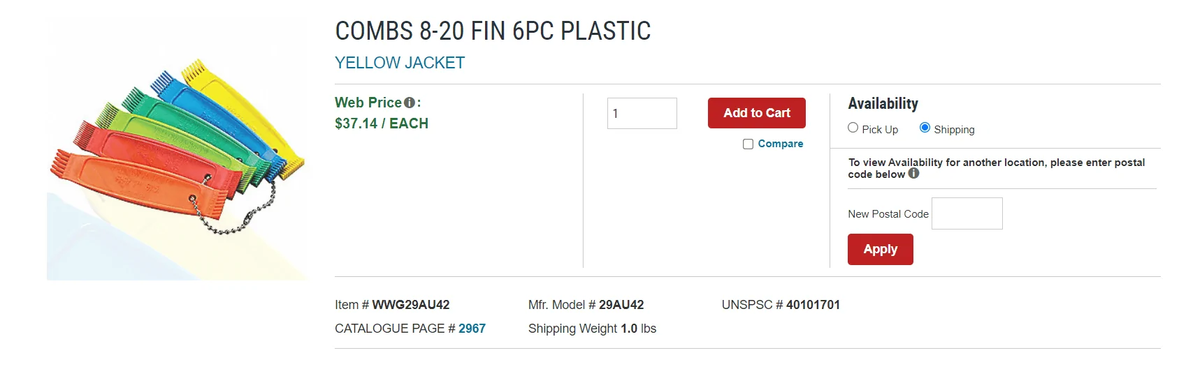

just get some radiator combs and take care of it.
Well I didn’t know this was a thing. I will get those. But since there is some damage already I just worry this will keep happening and maybe worse. I’m on the fence of leaving it open or not

I spent $5 on a metal black gutter guard from home depot. I trimmed it up, cut some tabs & bolted it to the license plate bracket. it's been good for the past 4000 miles. If anything happens to or it rusts I'll just go by another one.
