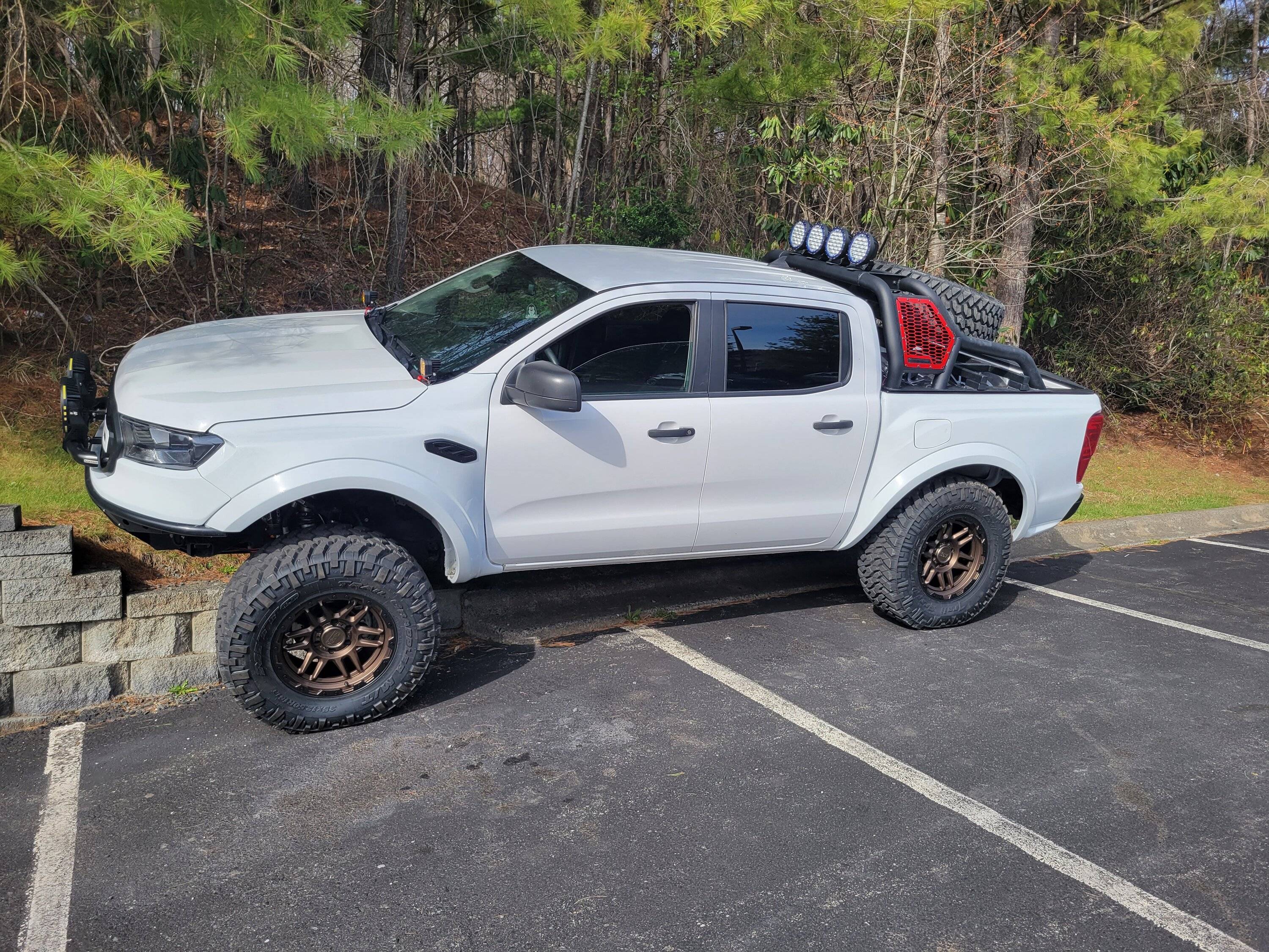

Eventful weekend. Hooked up the transmission cooler, transmission pan, and mounted the traction boards. Used some aftermarket mustang parts and made my own hoses. In total, drained 5.5 qts of transmission fluid and added 9 qts back. Had to do some high-school math to figure out how much I needed for the transmission hose length lol. Will say this wasn't as easy as I thought it would be. The heat exchanger on the transmission can't pass the shaft after removal thanks to the mounting design. Ended up cutting the lip off instead of dropping the shaft. Everything else (besides dealing with antifreeze and transmission fluid at the same time) was easy compared. Temps will hover around 170-180 degrees now.
