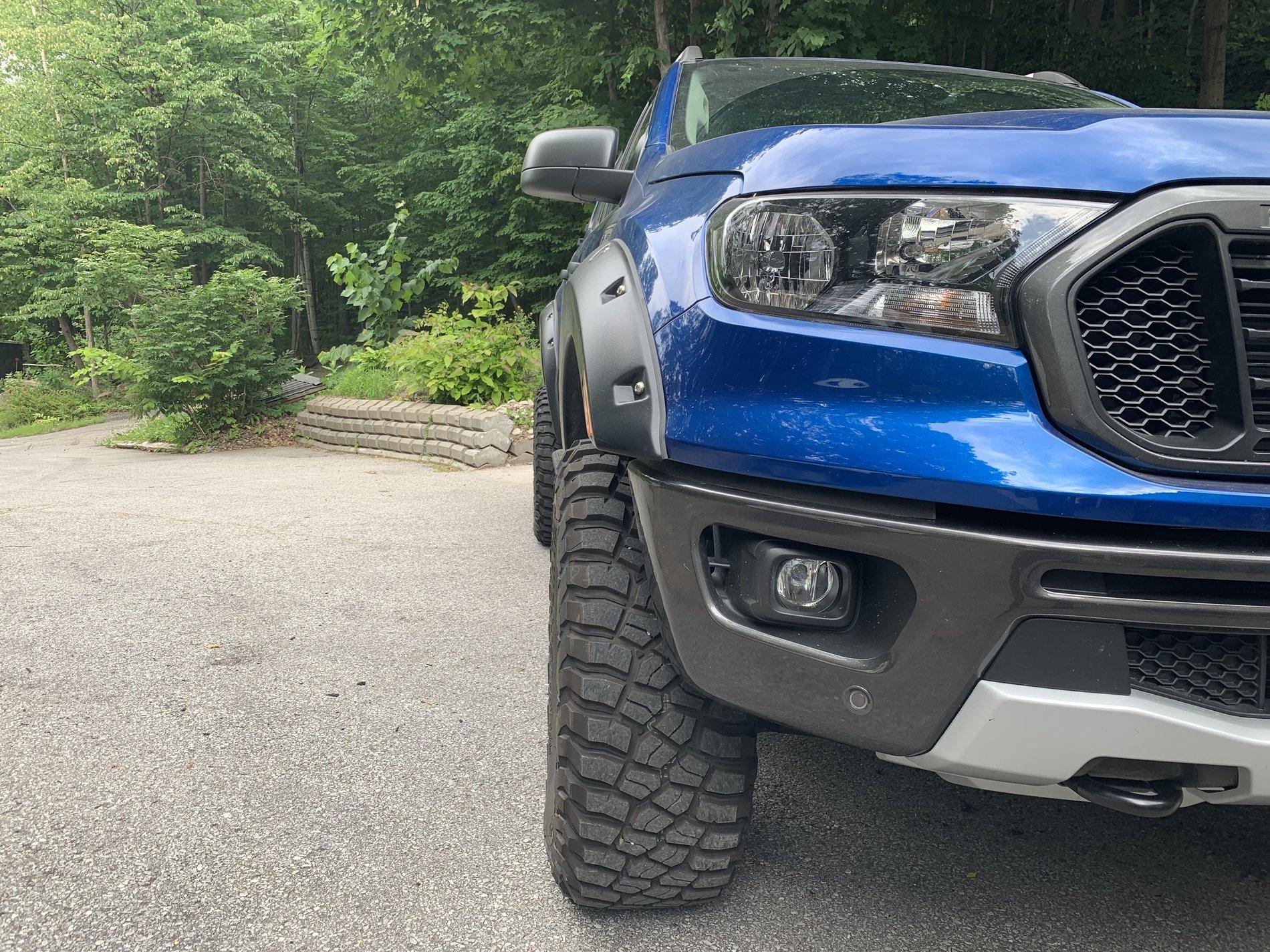

Had to vent cause I’m back to running stock tires since April 1st because warm weather (and local bylaws) prevent me from running my studded winter tires. Now truck looks really stupid with big flares and skinny tires!

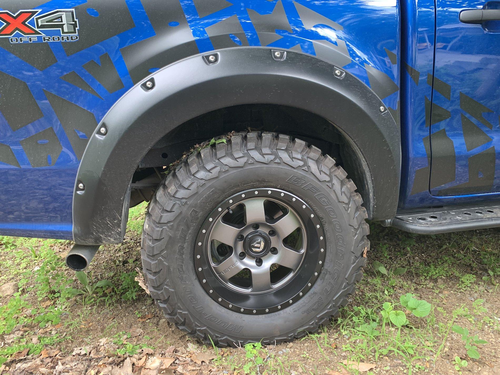

BTW 295/70R17 don’t fit with just a level kit, there’s a slight rub at full lock and when suspension is articulating, Will need the full 3-3.5 inch from the suspension lift. A 295/70 is roughly half an inch higher than a 33x12.5. Plus with the -12et on my Fuel wheels I’m a lot closer to the fenders.

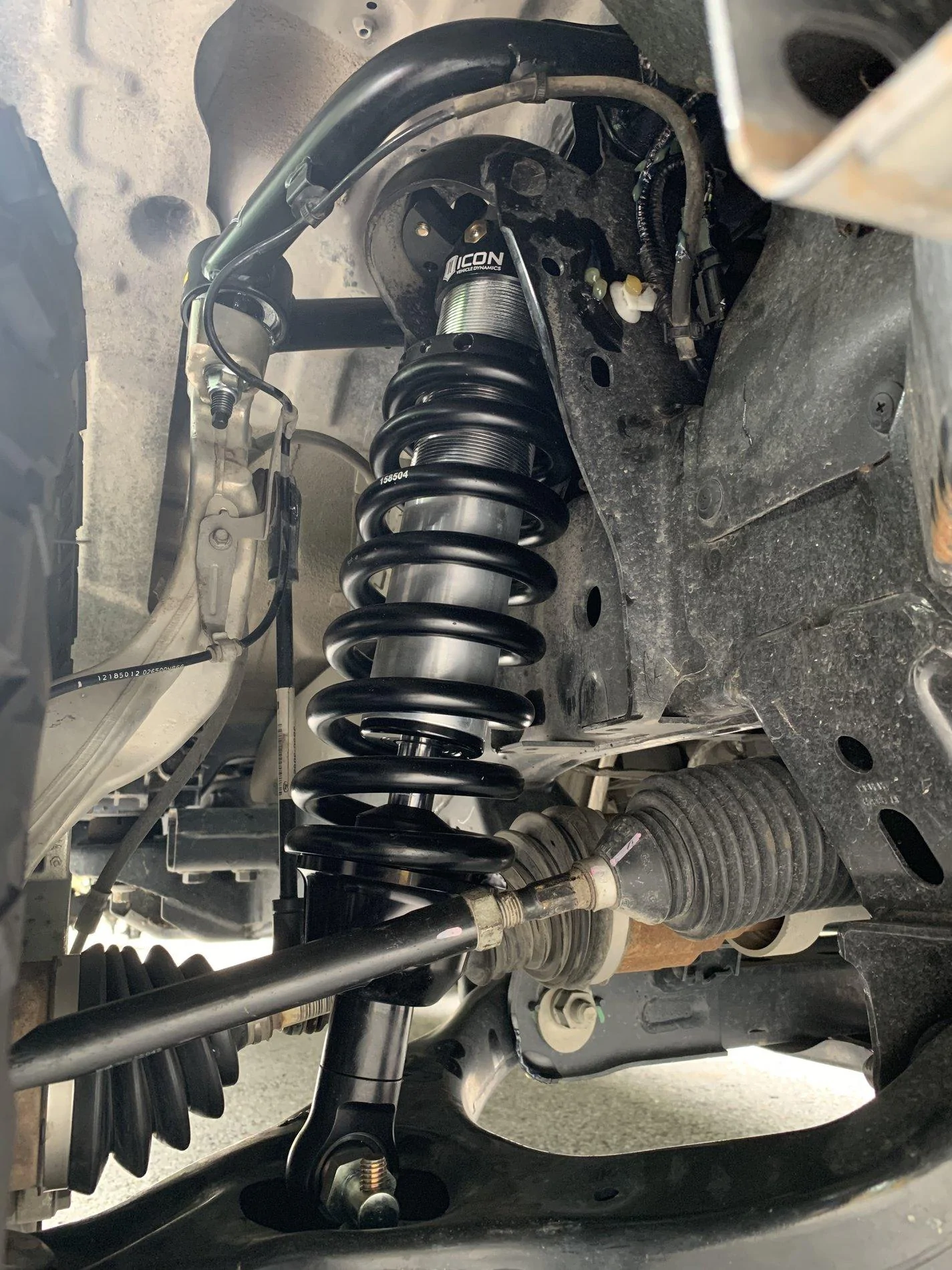

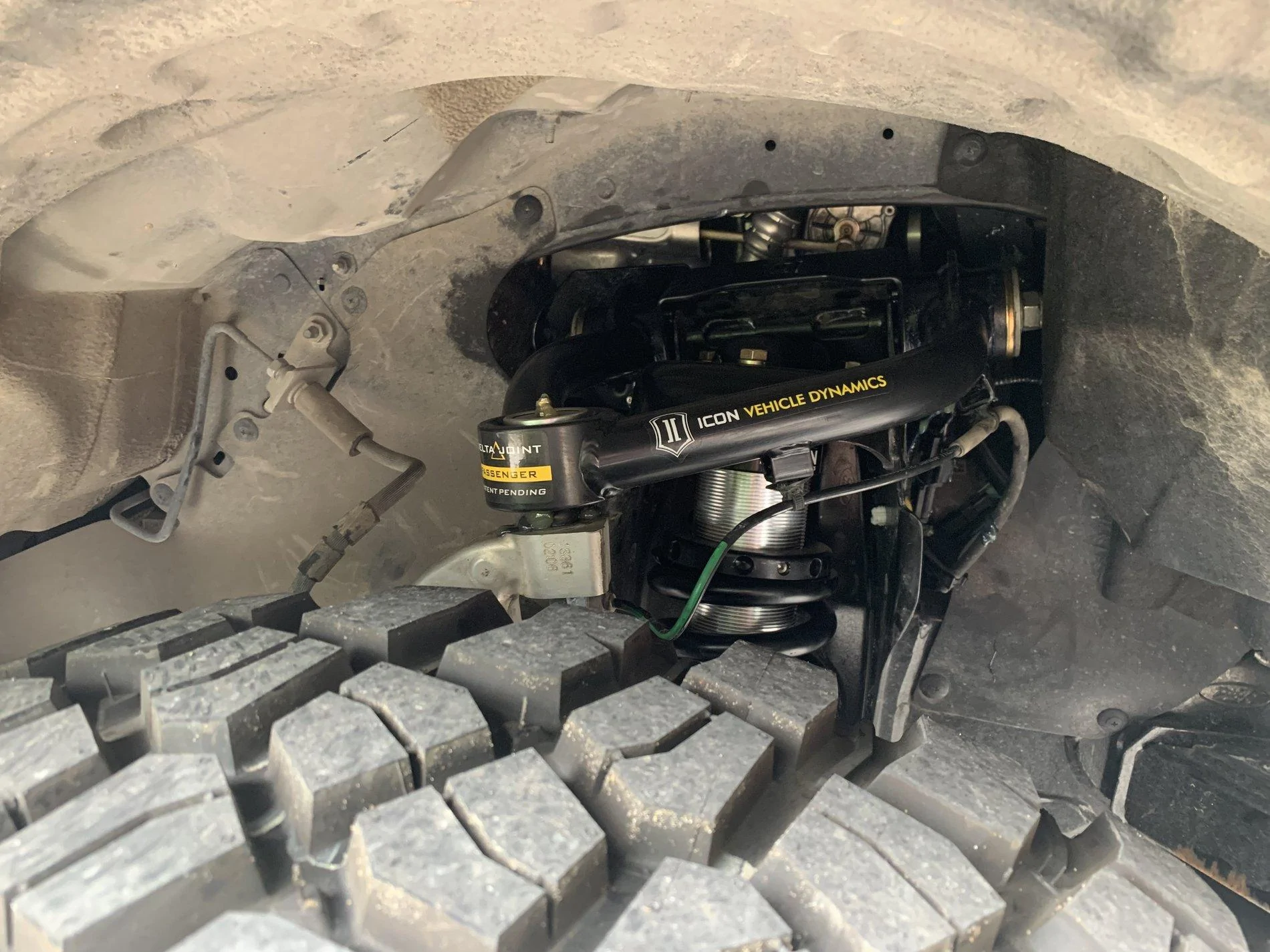

I’m hoping to update my build soon. Icon suspension kit has finally shipped. It hit a little unexpected delay at the border but was resolved, should be receiving this week hopefully.
Wildtrack roof bars are in from Thailand, so will install my Rhino-Rack platform on the roof at the same time I bring it in for the suspension work and wheels and tires.

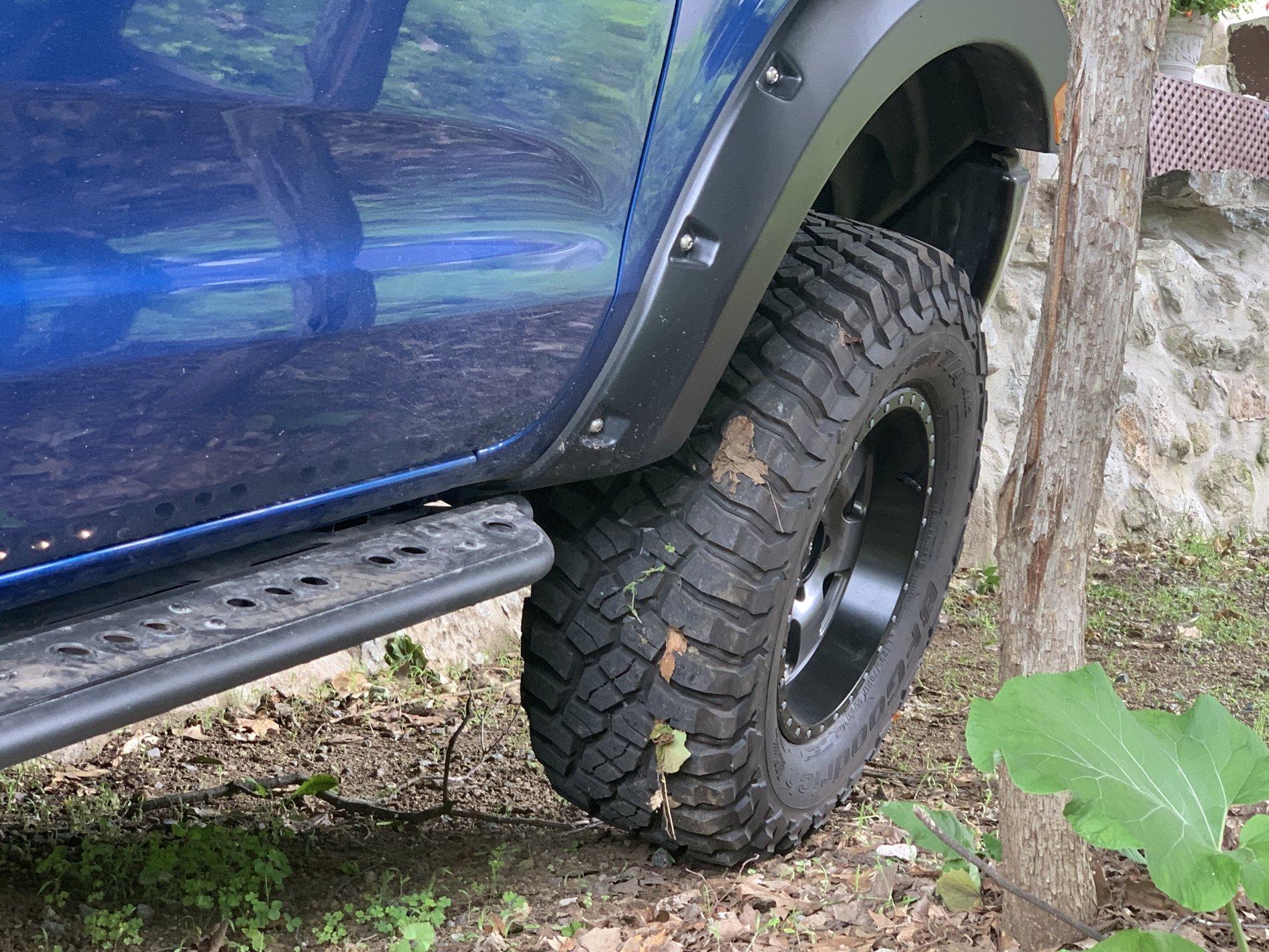

Are those rock sliders? They don’t seem to be attracted to the frame.
Although they are mounted in a very sturdy fashion, more so than regular running boards, they’re “Rock Sliders” in name only!

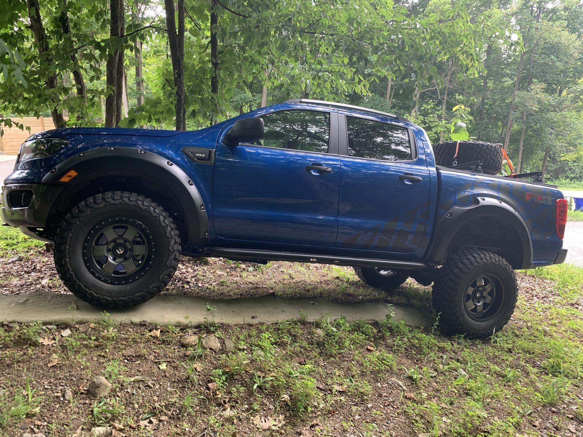

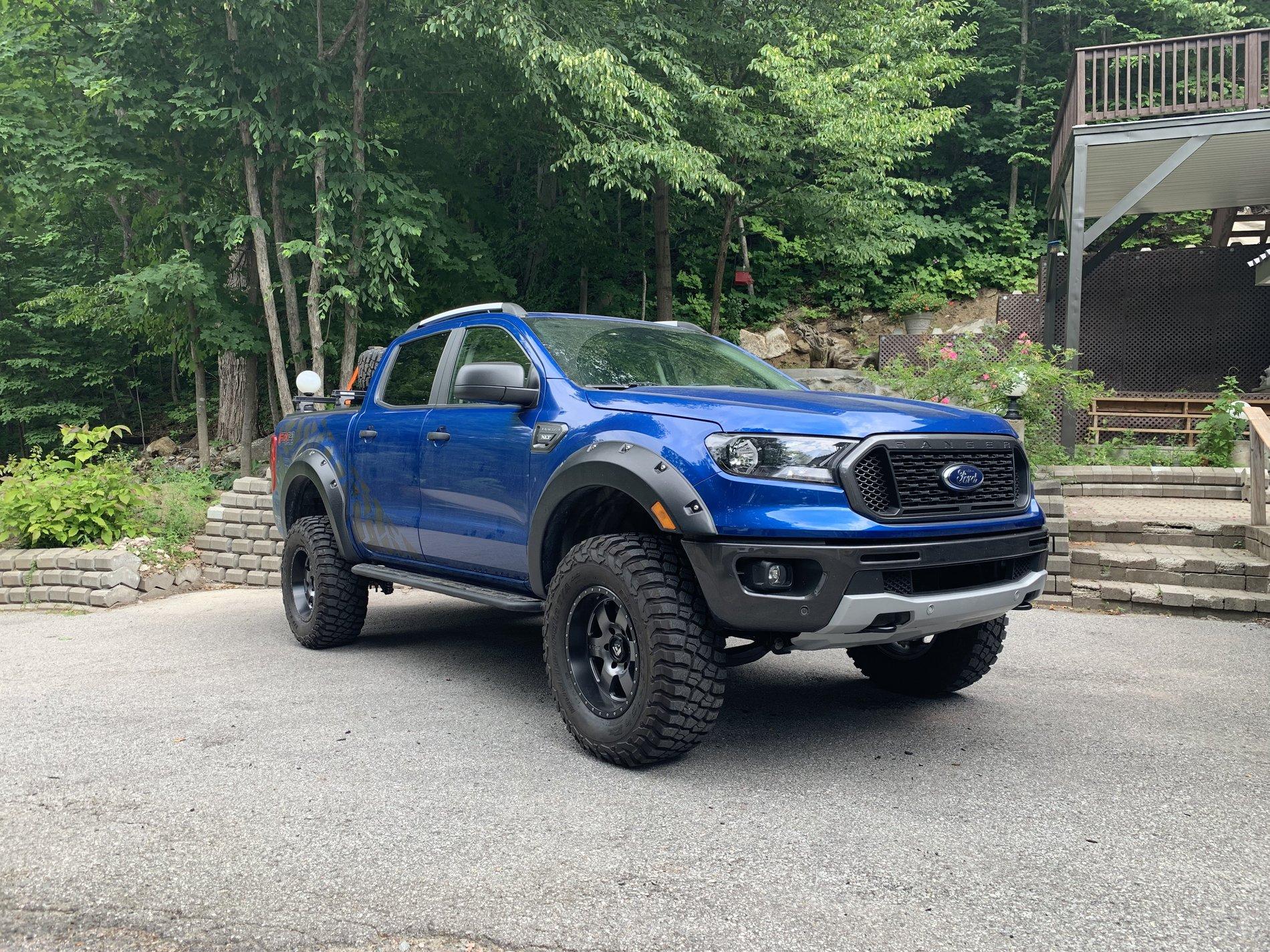

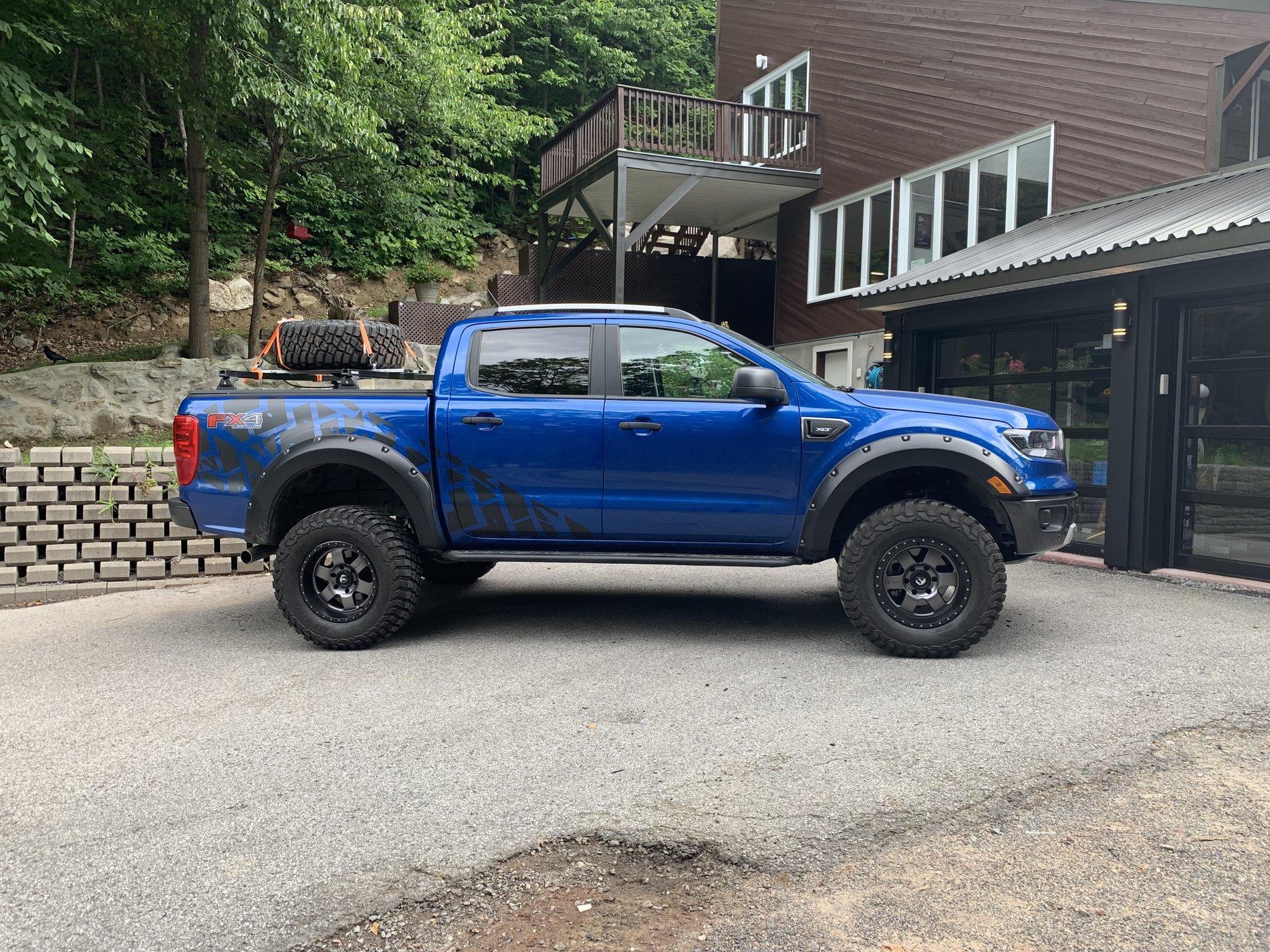

As you can see the -12et wheels push the tires right to the edge of the Bushwacker flares. Glad I found this site to help me come up with this stance: https://www.wheel-size.com/calc/ ... a little bit of luck was also involved to be honest!
Also Wildtrack bars are installed ... I find they look quite good actually! ... and next step is to get my Rhino-Rack platform installed up there.
