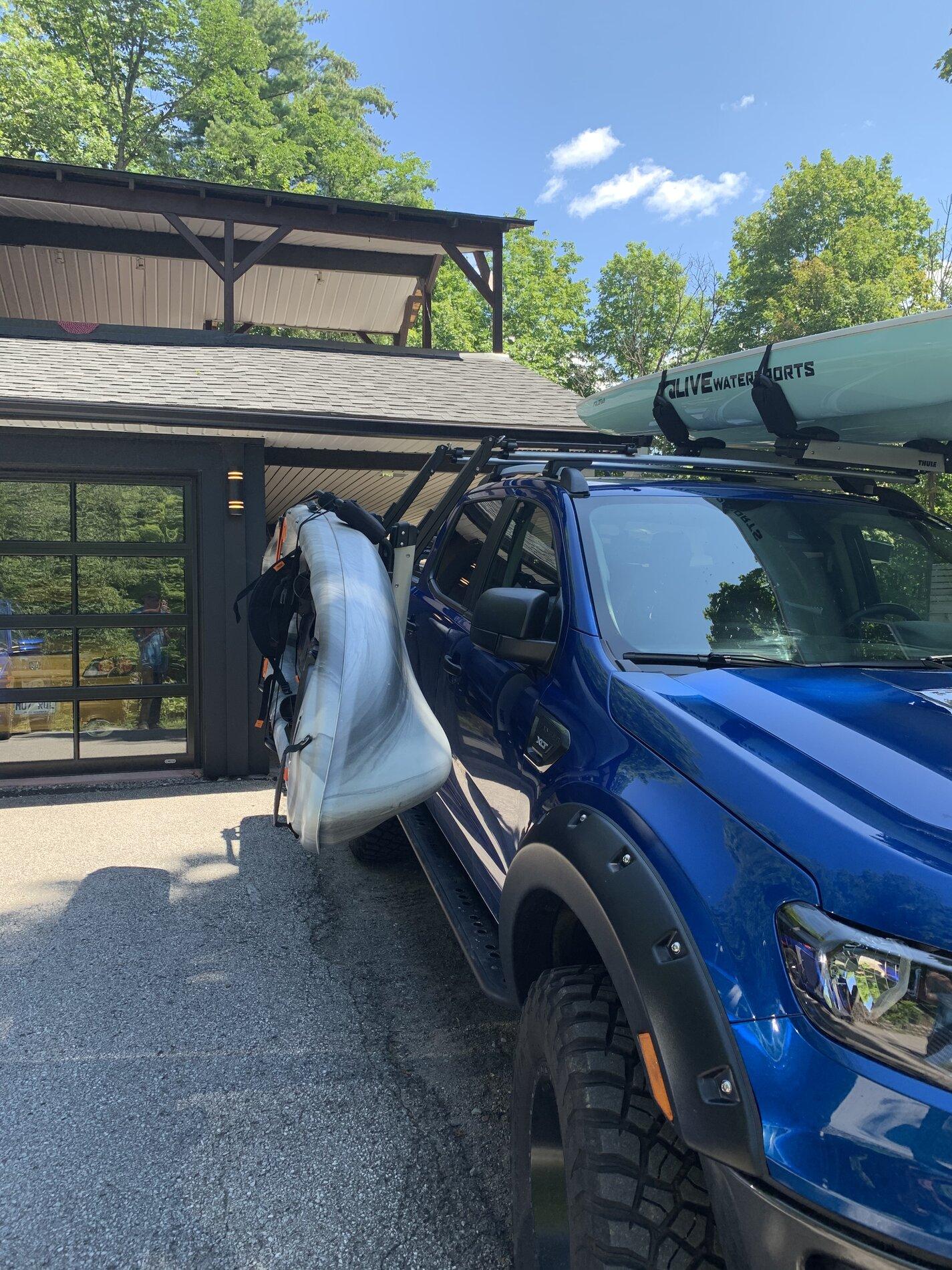

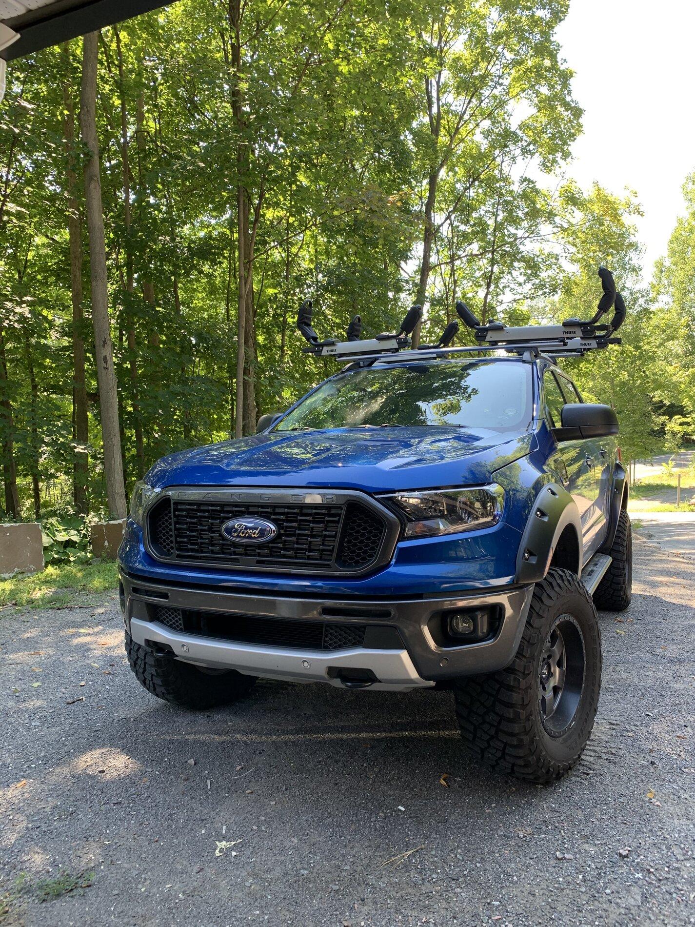

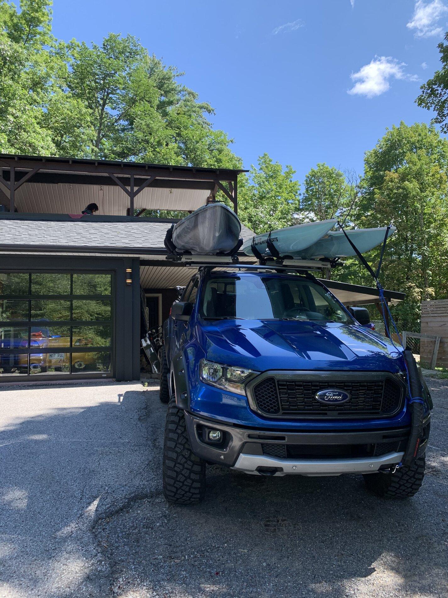

Finally using my Wildtrack roof bars. Just purchased a SUP and kayak and this is what that looks like:
Because of the height of the truck with 3” lift and 34” tires I had to get the Thule Hullavator. Initially tried a conventional J-rack but even at 6’ tall I was unable to reach the cradle. It’s even a hard job with 2 people!

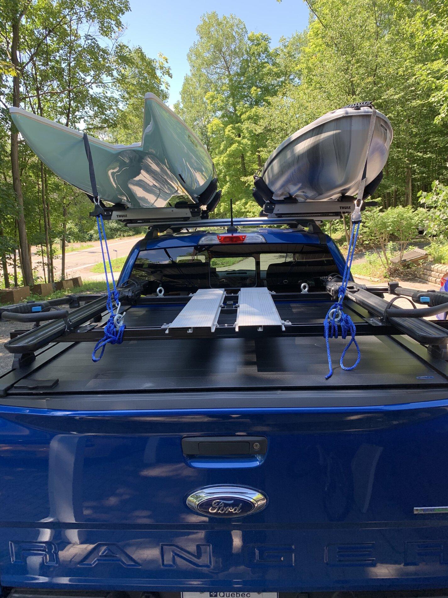

With this though, makes it easy to load even my awkwardly shaped and heavy (65#) SUP. Here’s a pic with the kayak:
So far very satisfied with it. Here’s a look from the back with my “2nd” roof rack installation (over the bed):

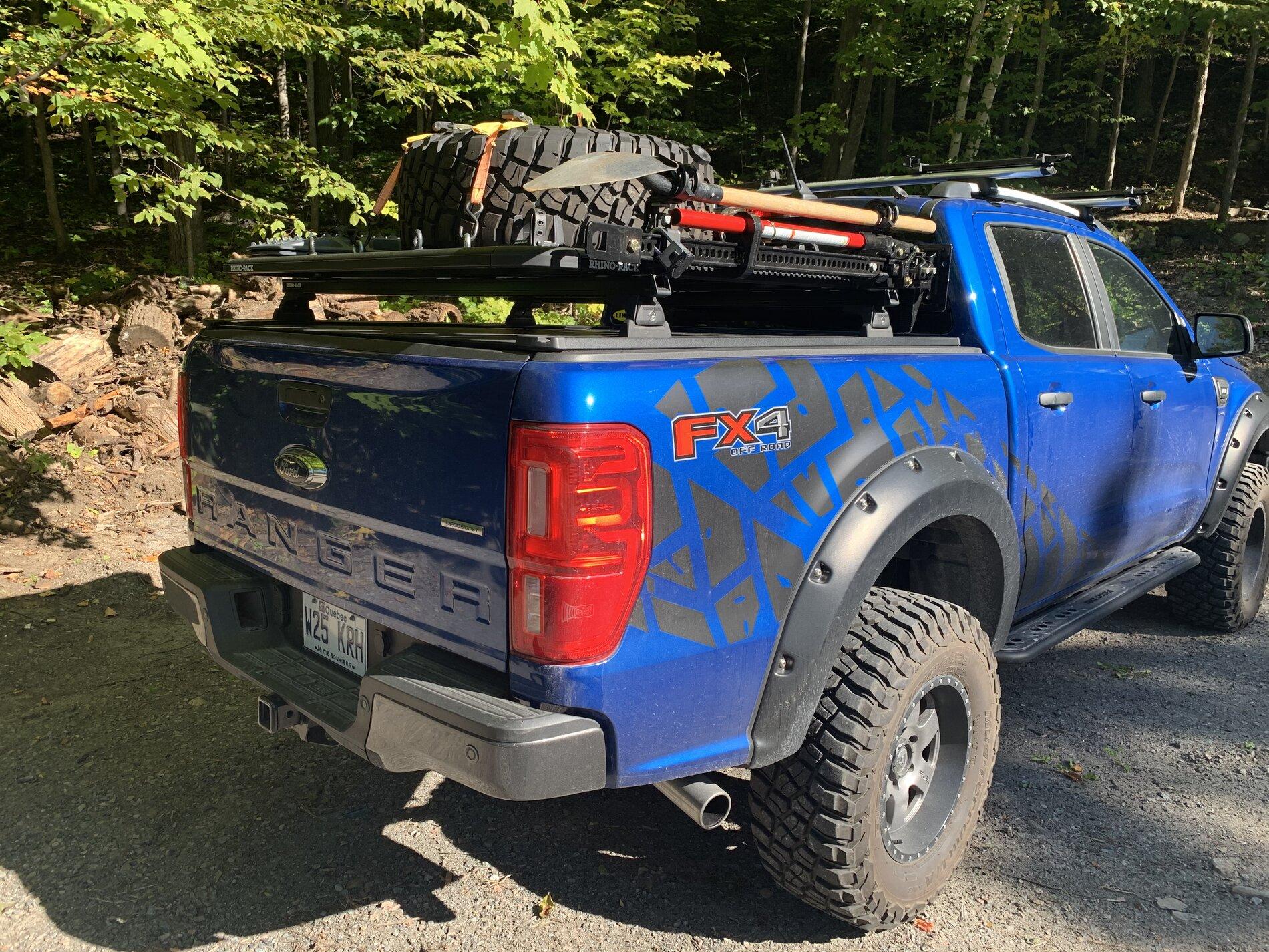

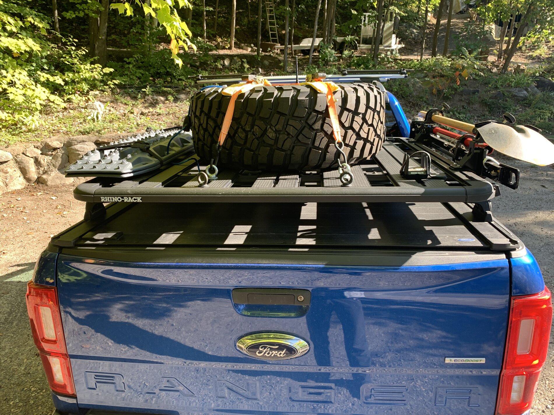

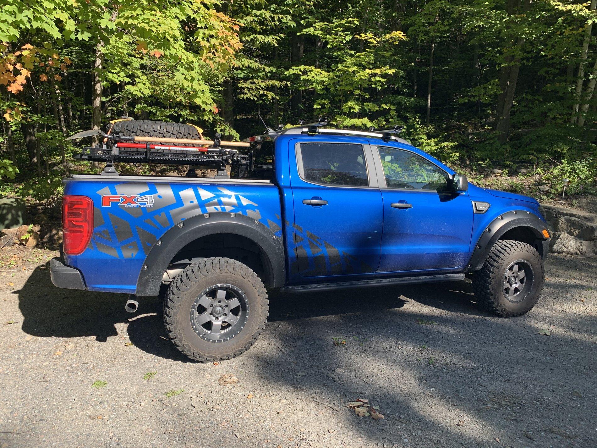

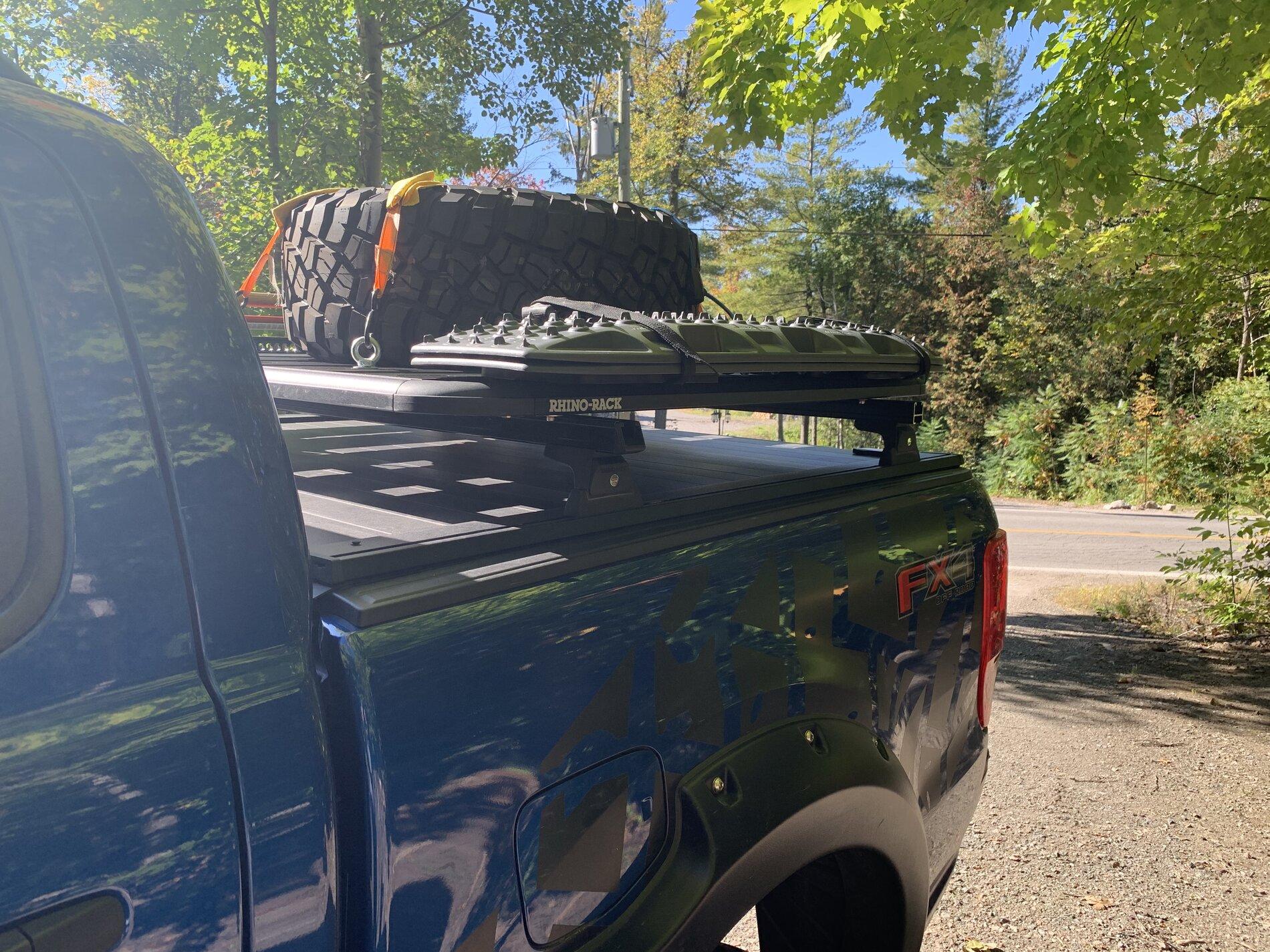

Here I go again fiddling with my bed rack system for the 100th time!. Was keeping my Rhino-Rack platform for the roof but after many months of waiting on legs to fit the Wildtrack bars turns out I was sold a “bastard” tray that can only be mounted using Rhino-Rack’s Backbone mount and I’m not changing my bars. So decided to ditch the bike racks (up for sale) and install my platform on the bed. I will most probably look into installing a Yakima platform to my roof. There are 2 advantages to this:
1- need a 54” width to fit my Thule Hullavators for my Kayak and SUP (needs to overlap the bars by 100mm to fit over mirrors when folded down).
2- wont need to run “accessory bars” for attachments like the Hullavators like on the Rhino-Racks because the Yakima T-rails run perpendicular to the roof (like normal cross-bars) instead of the longitudinal of the Rhino-Rack (Aussies are such contrarians! lol).
Will most probably purchase Rhino-Rack’s Maxtrax side mount to free up space on top of the platform but I had my Yakima mounts lying around from when I had the Overhaul HD on the bed so it’ll do fine for now.
And also my spare is finally at a height that prevents it from landing in the cab and killing us in case of a frontal collision, kind of important!
