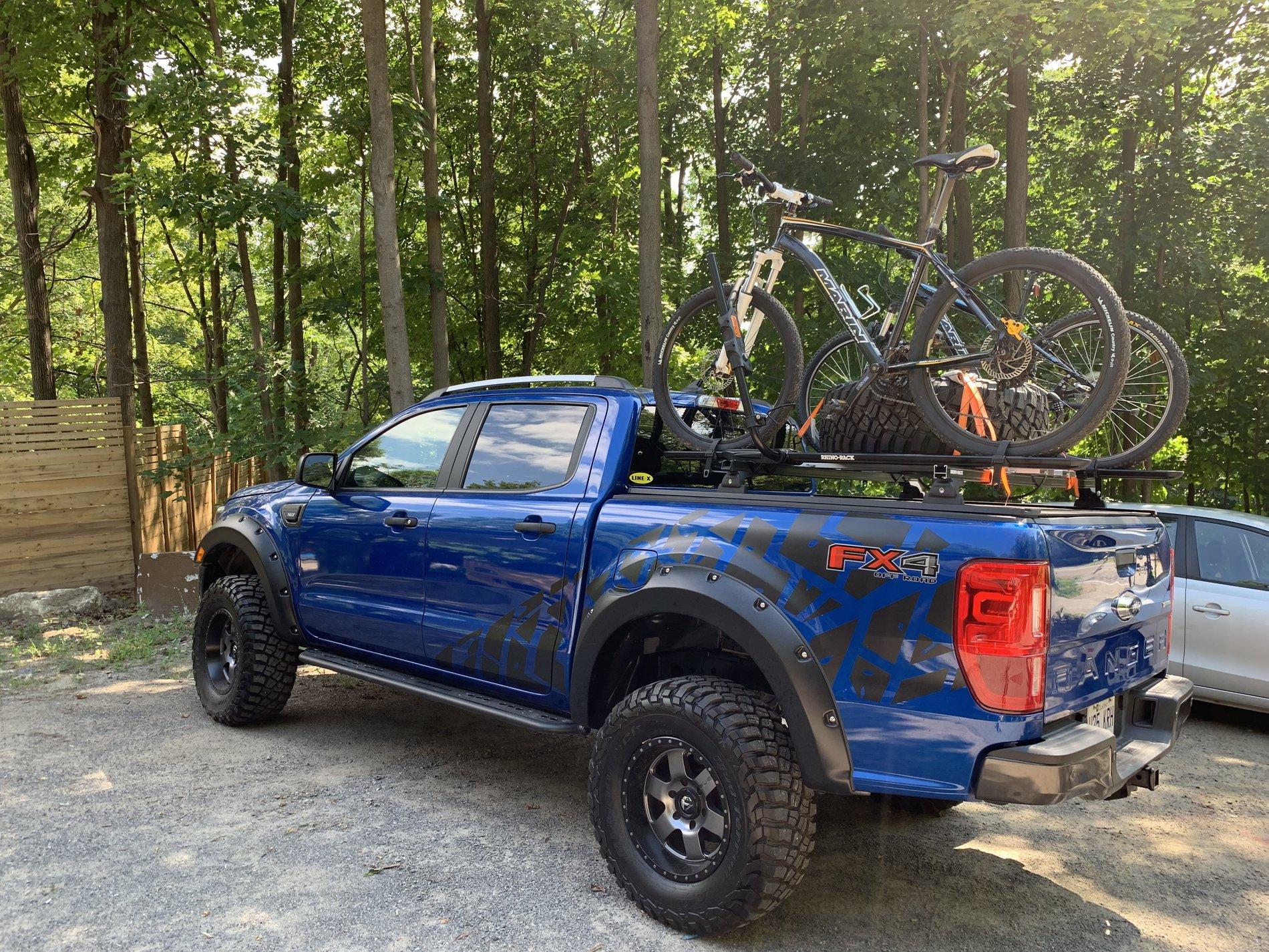

FINALLY! ... Icon 3’’ lift, Fuel wheels and BF Mud installed ... this was a textbook case of Murphy’s law! lol

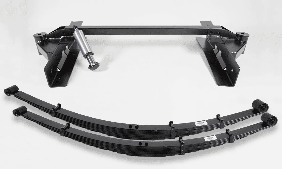

I have the Stage 2 Icon lift that includes UCAs but not the rear blocks. That was put on so that my lights wouldn’t be spotting planes while towing a trailer. Of course level looks great but wasn’t functional for me. Plus I’m still waiting on an aftermarket leaf pack that will replace both stock leafs and (aftermarket) blocks for a proper set-up.

Thanks for the info! I installed my Icon shocks on my Raptor and nothing was straight forward. Drilling, grinding, and tapering were required front and rear. I installed several UCAs and tie-rods as well. I ran an RPG Stage 4+ setup (6 shocks, Fox bump stops, UCAs, Dual-Shock LCAs, tie-rods, RPG steel frame support, and Deaver +3 springs). You’ll appreciate the new spring pack you ordered!

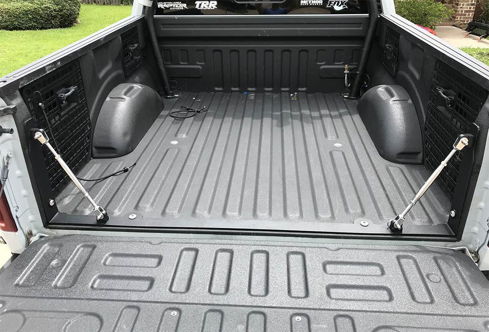

I’m not sure how hard you’re going to run your Ranger; but the bump stops, frame support, and bed braces are a must for jumping. It’s the only way to truly protect your frame and bed. A trained eye can easily spot a truck’s telltale signs of jump damage (or even donkey kicks). Ford actually stopped showing Raptor commercials that showed the truck hitting jumps.

I’ve never heard of a bed brace until right now, but I can see why they would be a good addition. That looks like a good setup, easily removable when they’re not needed.

that’s because you’re probably not a Taco owner!! If you were you’d know all about it! lol

A whole bunch of guys at The Texas Raptor Run a few years ago, started to notice large and uneven gaps on each side of their tailgates. Some tailgates wouldn’t stay closed, randomly popping open. Or some had trouble closing the tailgate. The immediate temporary solution was to run a ratchet strap from one bedside to the other and pull it tight. That’s when braces become popular; there’s many styles and even hidden ones that mount inside the bed walls. I opted for the quick release, fully adjustable TMX braces. We will have less options for a lot of upgrades because there’s no exposed bed bolts on the Ranger.

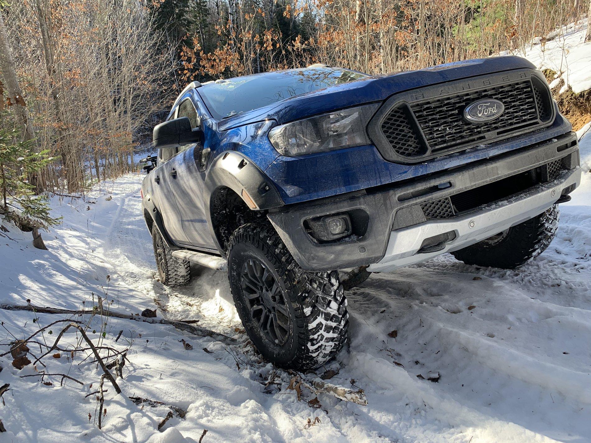

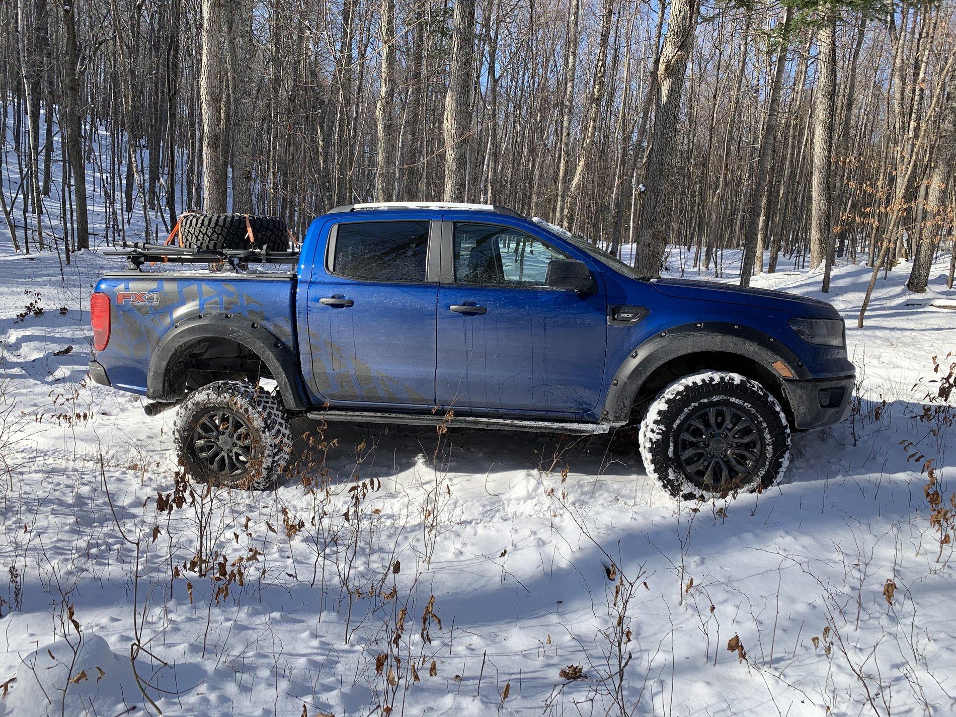

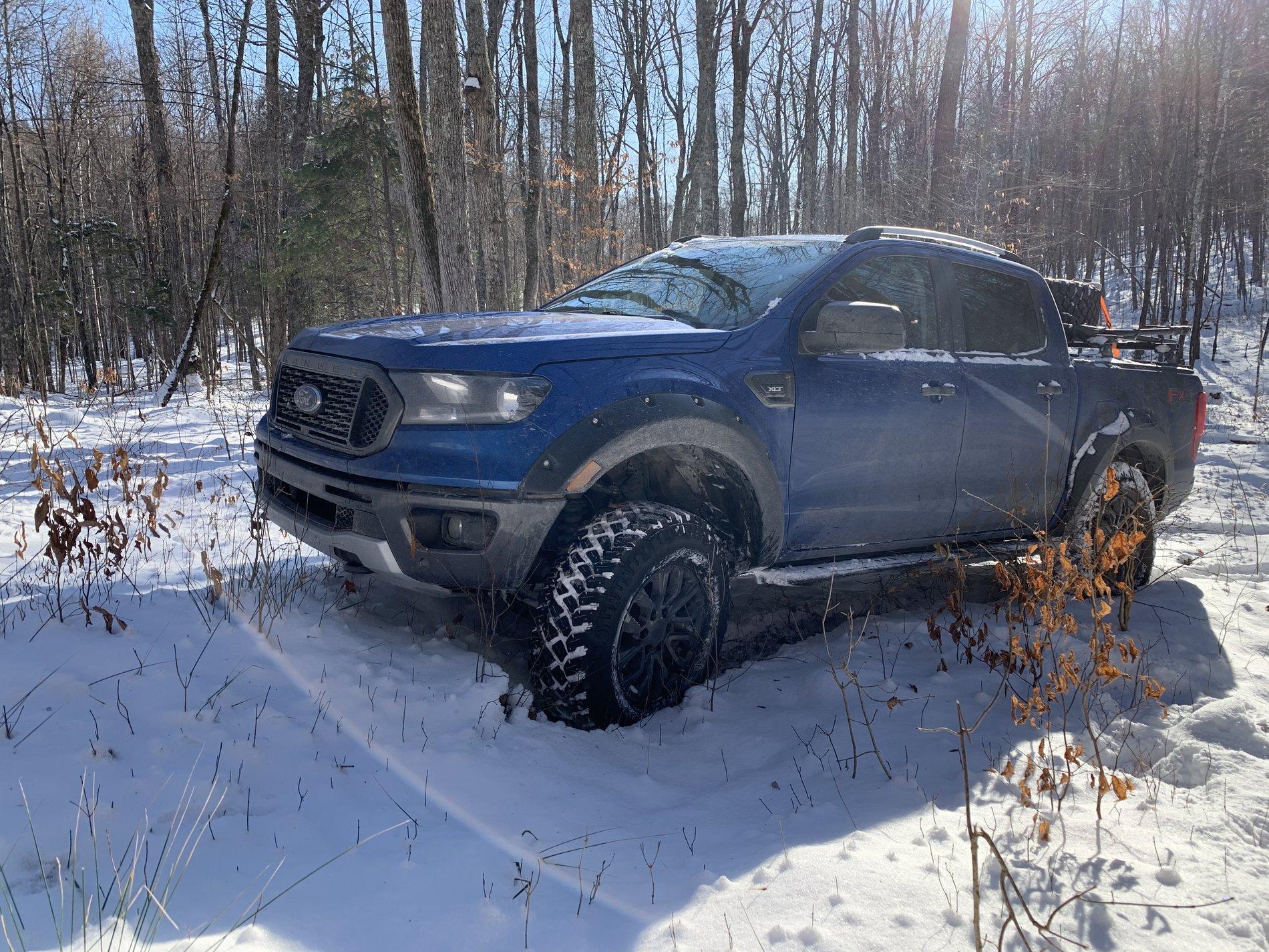

Sorry! Haven’t posted in a while. Was busy with my “other” project: turning a beat up S2000 into a track monster!
so here are a few pics of some light “snow-wheeling”. Was alone so didn’t do anything crazy.

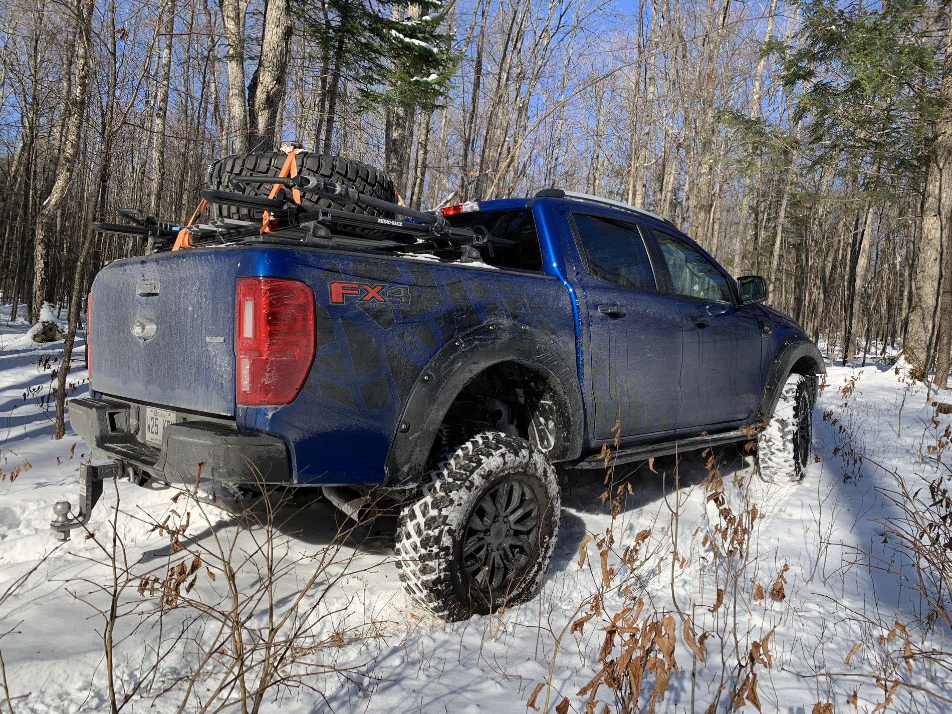

As you can see the -12et wheels push the tires right to the edge of the Bushwacker flares. Glad I found this site to help me come up with this stance: https://www.wheel-size.com/calc/ ... a little bit of luck was also involved to be honest!
Also Wildtrack bars are installed ... I find they look quite good actually! ... and next step is to get my Rhino-Rack platform installed up there.
