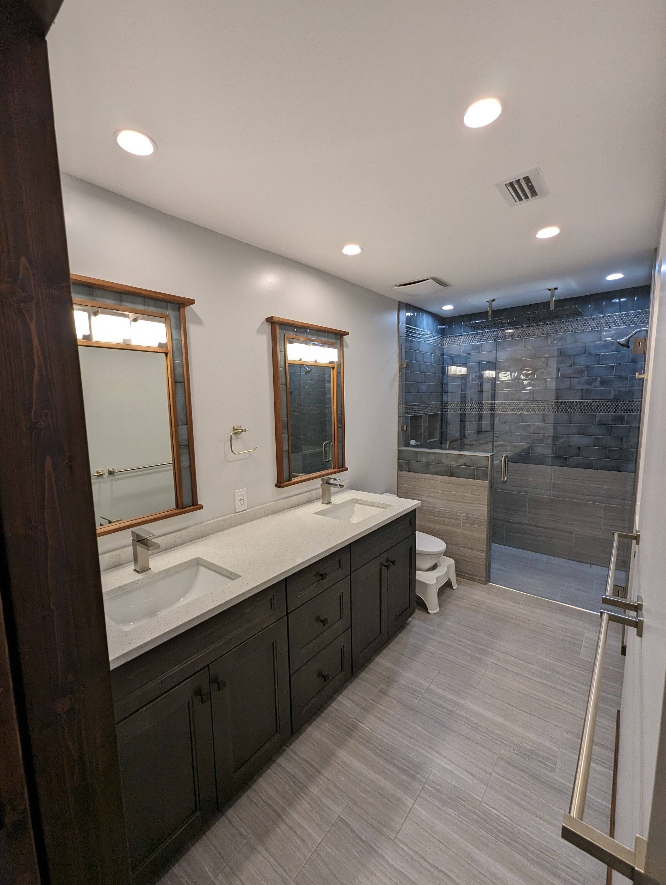

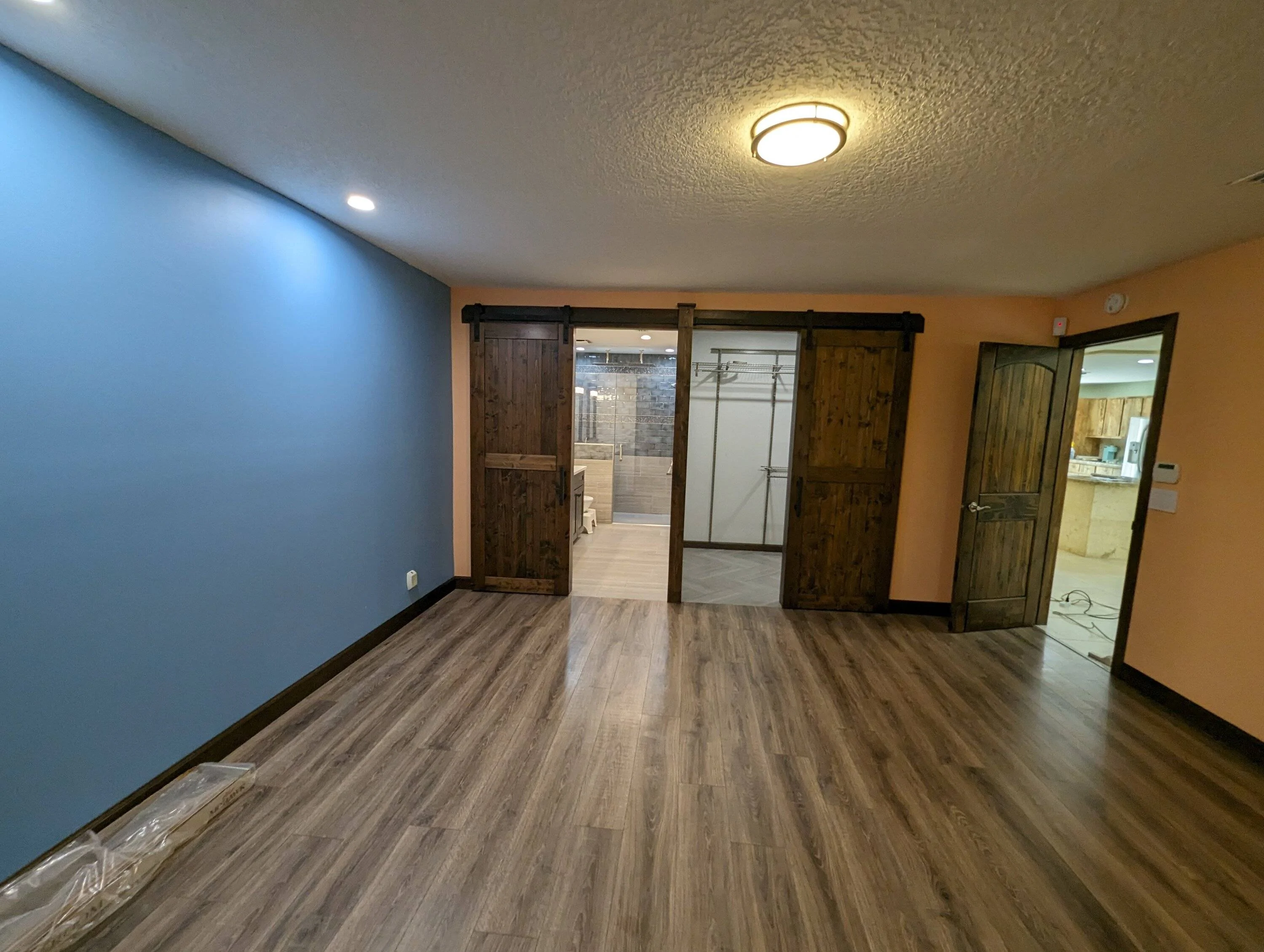

We redid our master suite in Florida - took the entire bathroom, tub, toilet, single sink etc. Hired a retired general contractor friend to do the work. It turned out amazing. We went from a barely usable bathroom, to a zero entry shower with dual rain shower heads, a normal shower head and a shower wand. Custom wood framed mirrors over a dual sink vanity, cut down from kitchen counter height to halfway between that and bathroom vanity height. Gorgeous tile laid over Schulter system... And new barn doors the matched the closet so when closed they looked like one big door...
No permits, because we didn't change anything structural. And he was so methodical... He laid all the floor tiles out and sorted them so when you looked in the lines on the tiles matched, but weren't perfect so it looked purposeful, but not cover done... ?

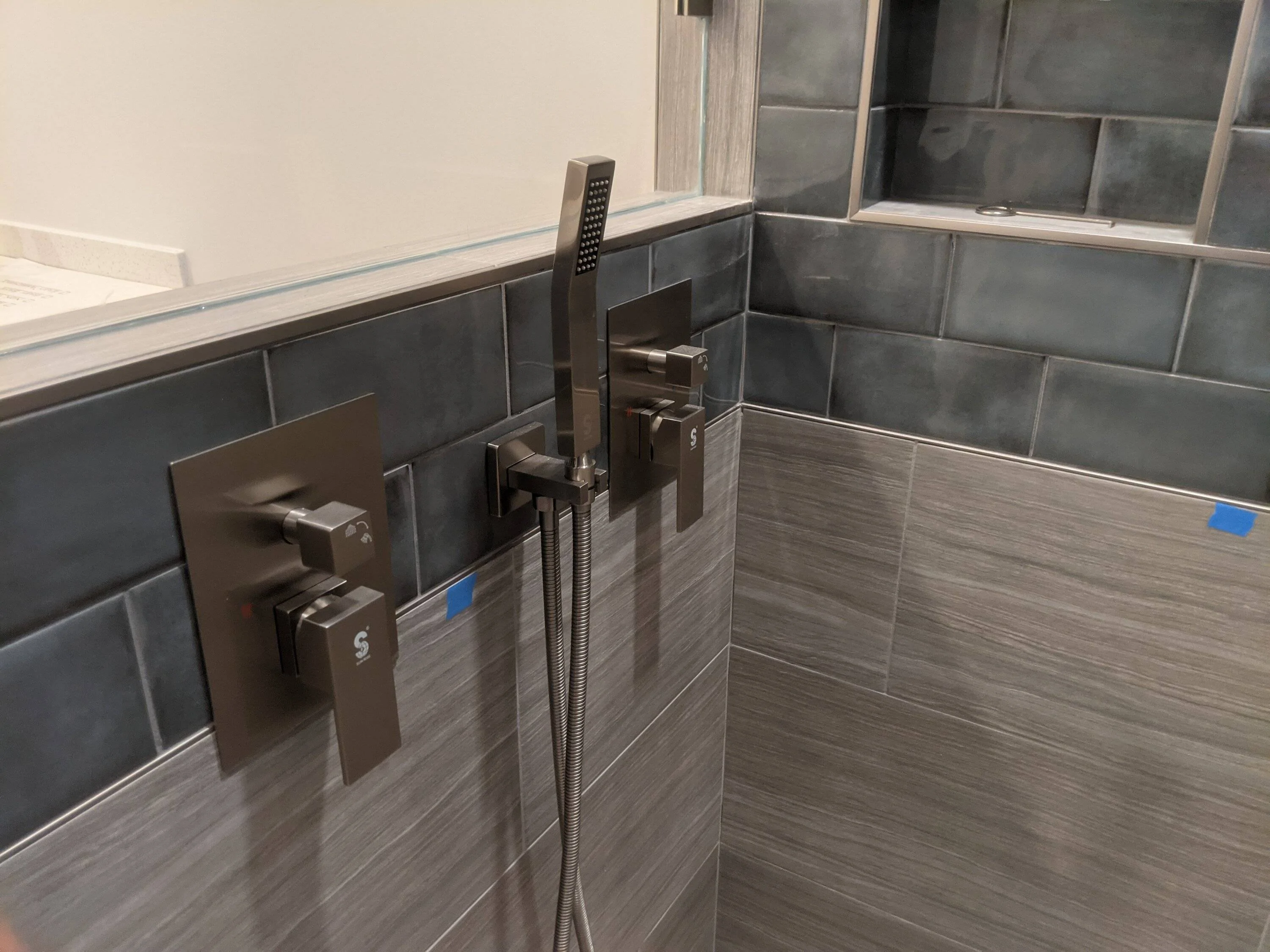

OH and all the shower controls are hidden behind that half wall so you can't see them from outside the shower. It was so sexy.

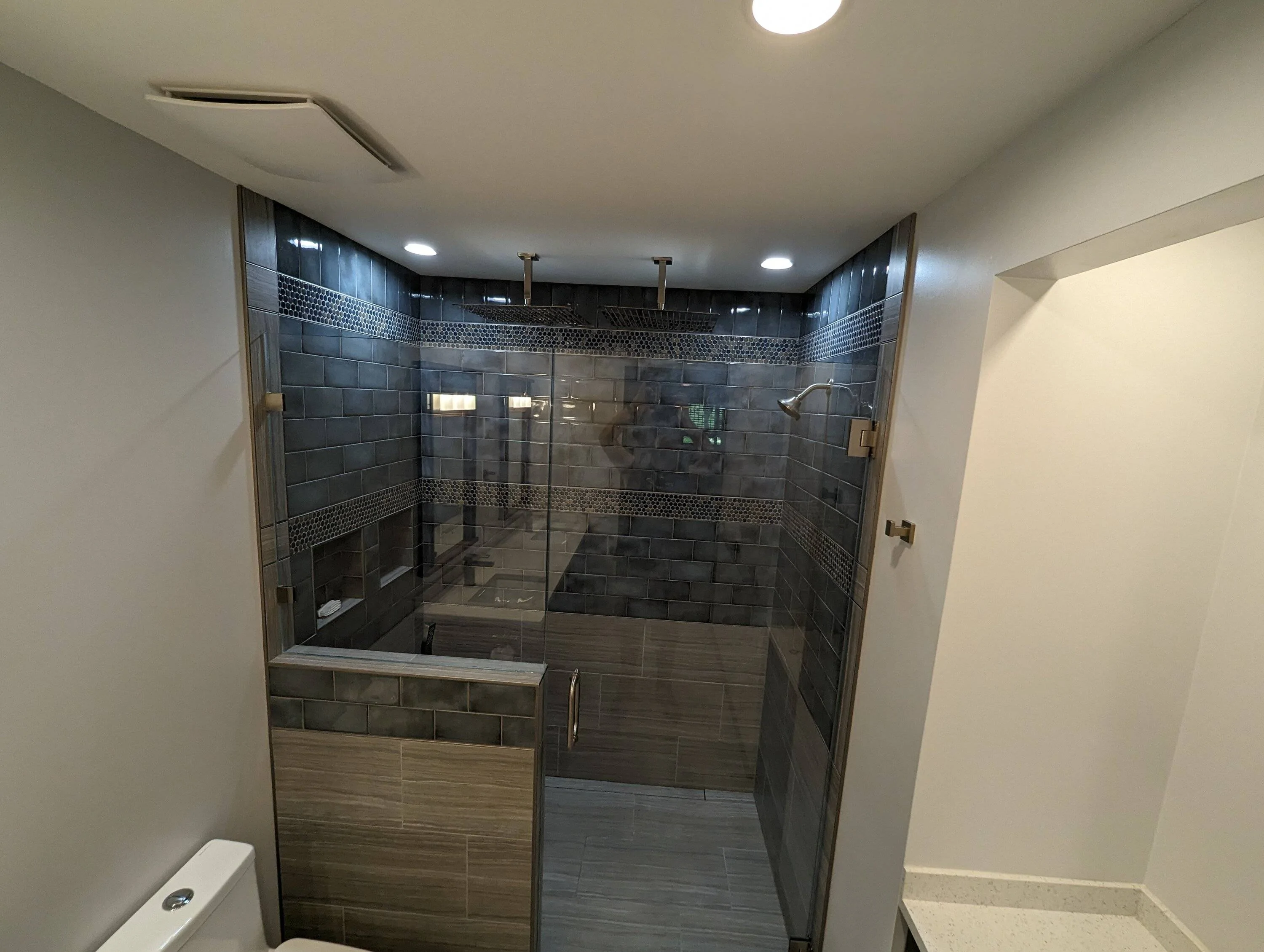

That is top shelf work! Three, maybe four different types of tile, plus those notches, which are exactly at the height of a single course of the tile below. Dry-fitting it all while installing the prefab Schluter notches. Frickin’ wizardry!
Love the Schluter system - spendy because of the labour but always worth it. On that same house I mentioned removing the wall, I hired a sub-contractor to do the tile work - Milorad, an Eastern European guy. Everything in Europe is tiled - those guys know there stuff. There was only about 25 sq. ft. of tile for the floor in one of the bathrooms - he laid it all out and dry-fit it before setting it. Total perfectionist, even on that small floor.
When you find folks like that, keep them on speed dial. ?

Ohh, he reframed the room because the block was weren't straight and the old walls would not have allowed the edge of the tile to line up with the half wall. The cabinets were set so the knobs were flush with the top of the counter tops. He installed blocking behind the drywall where the towels bars are installed...
He replumbed from the water heater to the fixtures so there was as few joints as possible and increased flow so we could run both rain showers at the same time...
