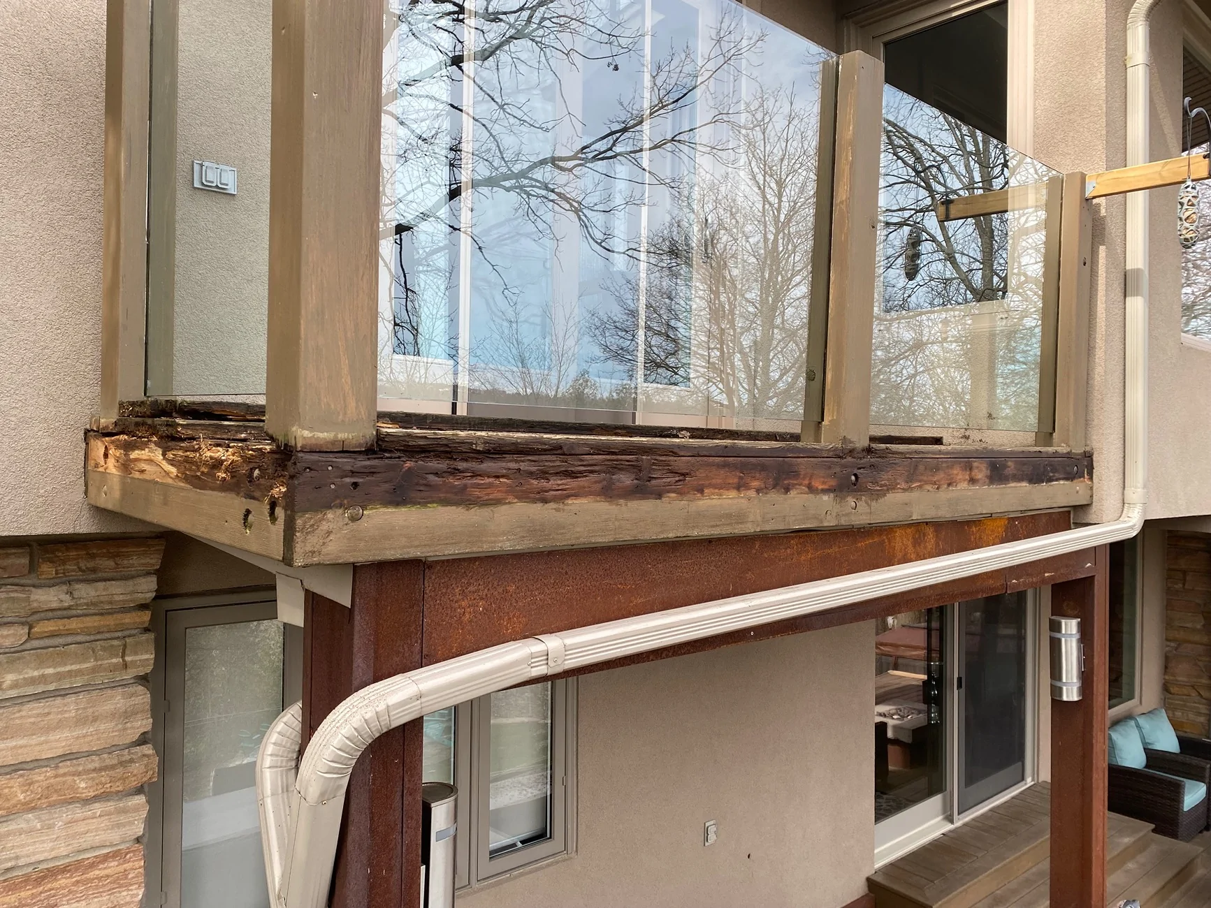

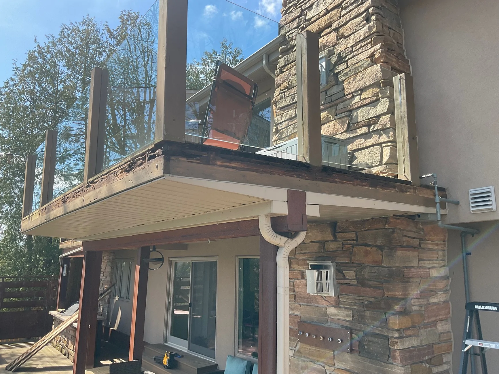

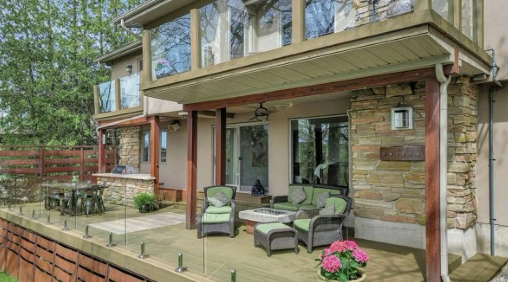

Well, I saw some water dripping from under one of the upper decks of my new place. The underside of the decks are enclosed with a system to collect and drain the water into a downspout. There are seating areas and a barbecue area under the decks so having a typical backyard deck above all that just wouldn’t work. Here’s what the two decks look like and you can see why they are not an open design….
I decided to pull up some of the deck boards and remove a couple of trim boards to see just what was going on.

Thanks, I really appreciate that. It looks way worse than it is. I got lucky this time and repairs will be very straightforward.
I really don’t like this semi-closed system because the pressure treated wood doesn’t get the same opportunity to dry out as a regular open deck does. Unfortunately, it cannot be easily converted to a sealed flat deck.
I will spend more time installing flashing and improving the water drainage system under the joists than I will replacing rim boards and rim joists.
