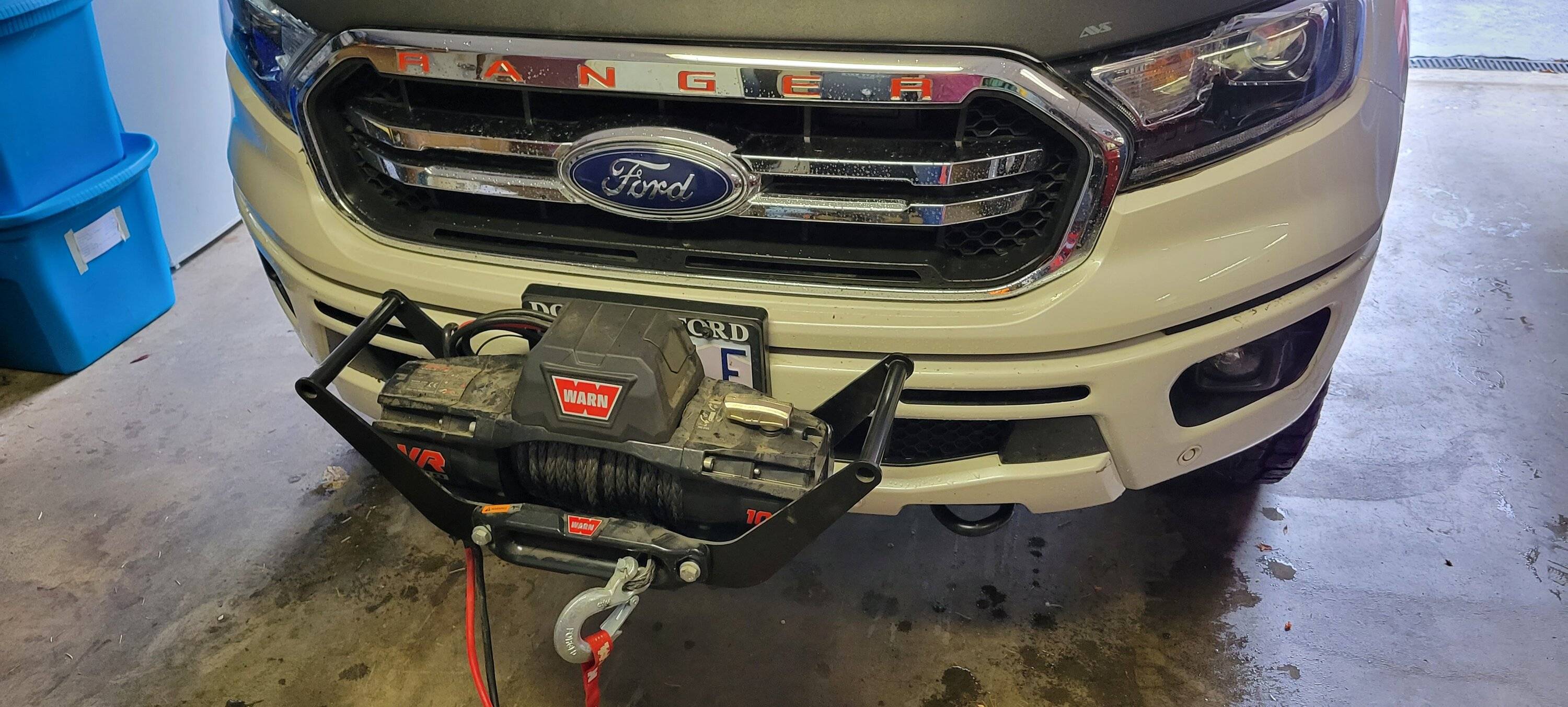

Just another data point - I was concerned about relocating the ACC sensor but thus far, I've not had any issues with it working correctly. I have to say, I still don't trust it 100%, but it is absolutely functioning as well as it did in the factory location as far as I can tell.
I really like the flexibility of being able to mount the winch either front or back as needed.

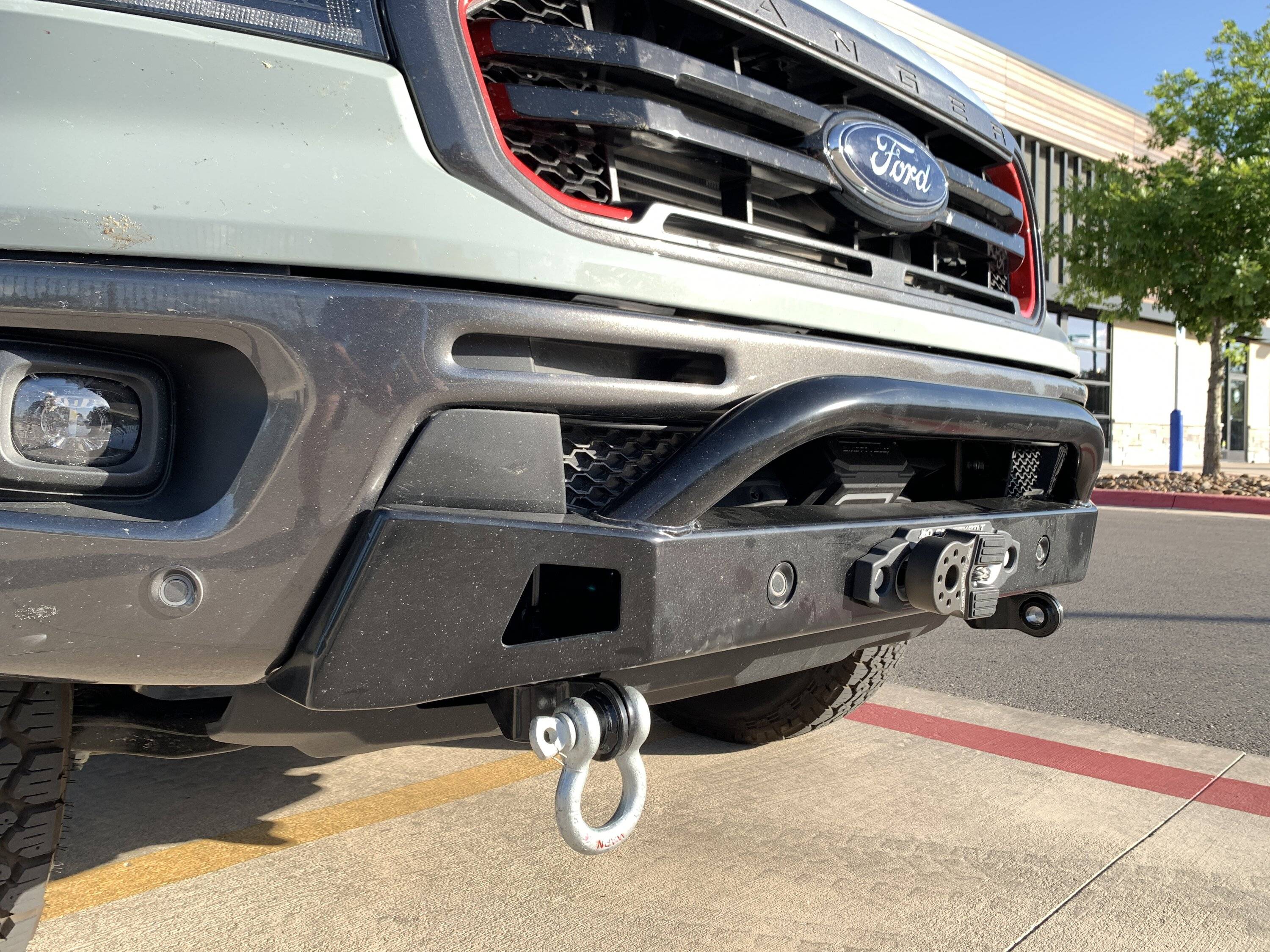

Keeping an eye on this thread for anybody who may have the ARB summit bumper. I really want that thing but need to make sure my truck will still fit in the garage...
