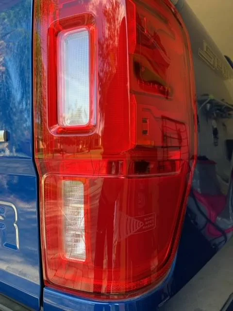

During a very low speed impact with a 2014 Toyota Four runner the Ranger got a cracked taillight. You should be able to see it in the attached photo. The cracks are over the backup light. I anticipate a lengthy wait for a replacement so a temporary repair to prevent water intrusion or other further damage may be in order. Should I use adhesive or clear tape? Thoughts?

I would go with super glue just to seal it from water intrusion. Gonna look jerry rigged, but, will seal it.
137,181
I agree I would use some adhesive (gorilla glue) to keep the water out for now. Might not look pretty but it'll do the job until you can get another one. Might want to check the junkyards too, if you have BLISS those are over $1,000.

Just get the clear epoxy in the double injector at Home Depot, it mixes as you dispense it and cures clear in 15 minutes. Apply with a toothpick along the crack lines. Will be a permanent fix, or at least until you save up the big bucks to replace it. Don't know if you need a complete assembly or if you can just get the housing and swap out the sensors and LED panels.

The housing includes the LEDs for taillight, brake, and reverse, but you have to swap the BLIS sensor over to the new unit.

FYI My insurance is paying for the repair. I'll just use the adhesive until the dealer can get a new tail light in. I haven't had any claims in quite awhile, and been with them a long time so Allstate is waving my deductible. That was a pleasant surprise.
