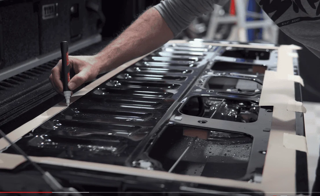

Decades ago you would never have to check this but nowadays you never know what dumb s*** manufacturers will pull.
For example my old Tacoma. Owners have bent these just by sitting on them.
Anybody has a picture like this but for the Ranger? I'm just curious what it looks like.
I've seen videos of Australian guys removing the skin of theirs to put "overlanding" tailgate covers on and it looks pretty much just like this photo.

TheDo114
Aug 2, 2020
295
746
Canada
2021 Ranger Tremor XLT
Thanks, I was able to find a picture.
Really not as bad as the Tacoma, only half is full of holes instead of the whole tailgate.

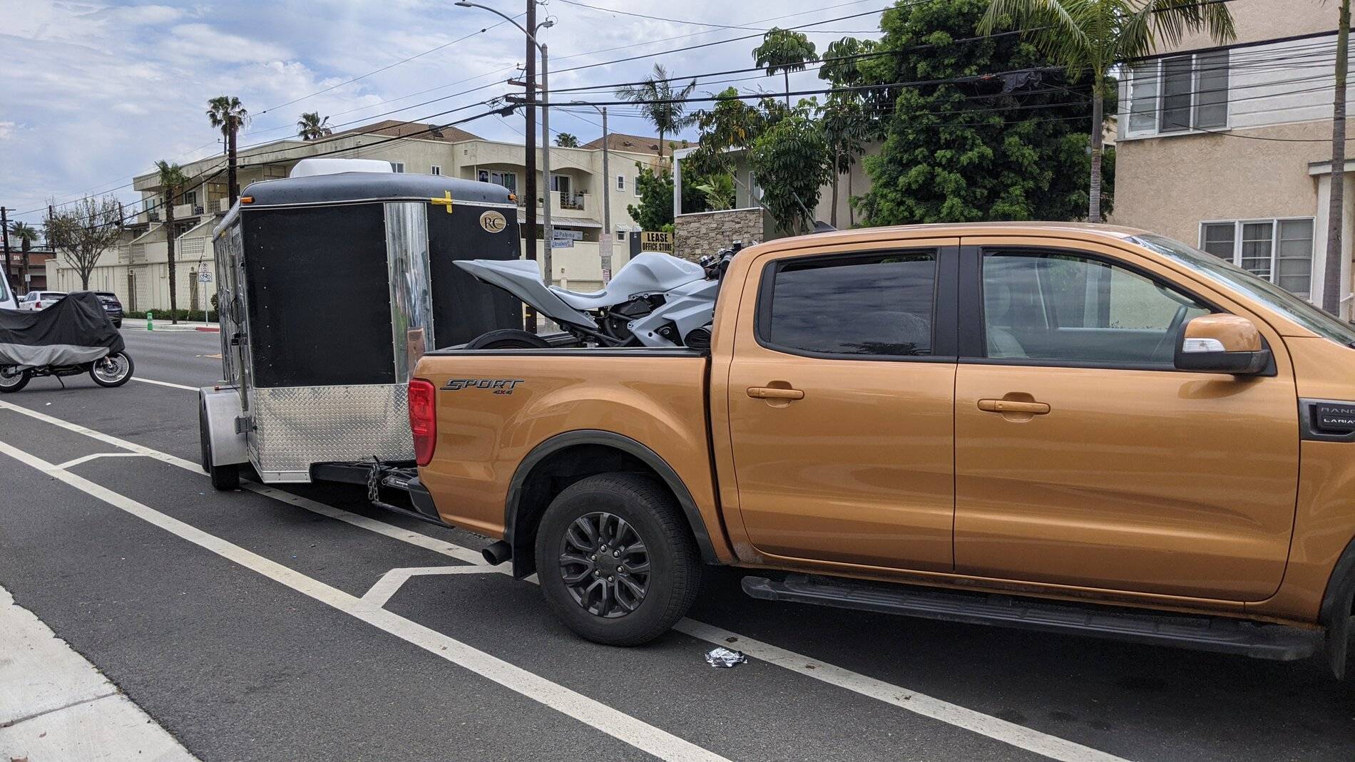

Good Morning !
New member with a question that I am sure as been asked but...
I have a 2019 STX 4 door, so 5' bed. I am going to pick up my new Honda CRF300L dual sport bike next week. Does a full size bike fit in the bed with the tail gate is down?
Thank you!
Welcome to forums. Here's a helpful tip: please do your due diligence in trying to find info that already exists on here before asking. If you were to look up THREE whole posts from the one I'm quoting you would see the picture I posted that answer exactly your question.
And to answer the question you didn't ask, it is possible to get a bike in, on an angle, with the tailgate CLOSED. Provided you do not have a drop-in bedliner.
