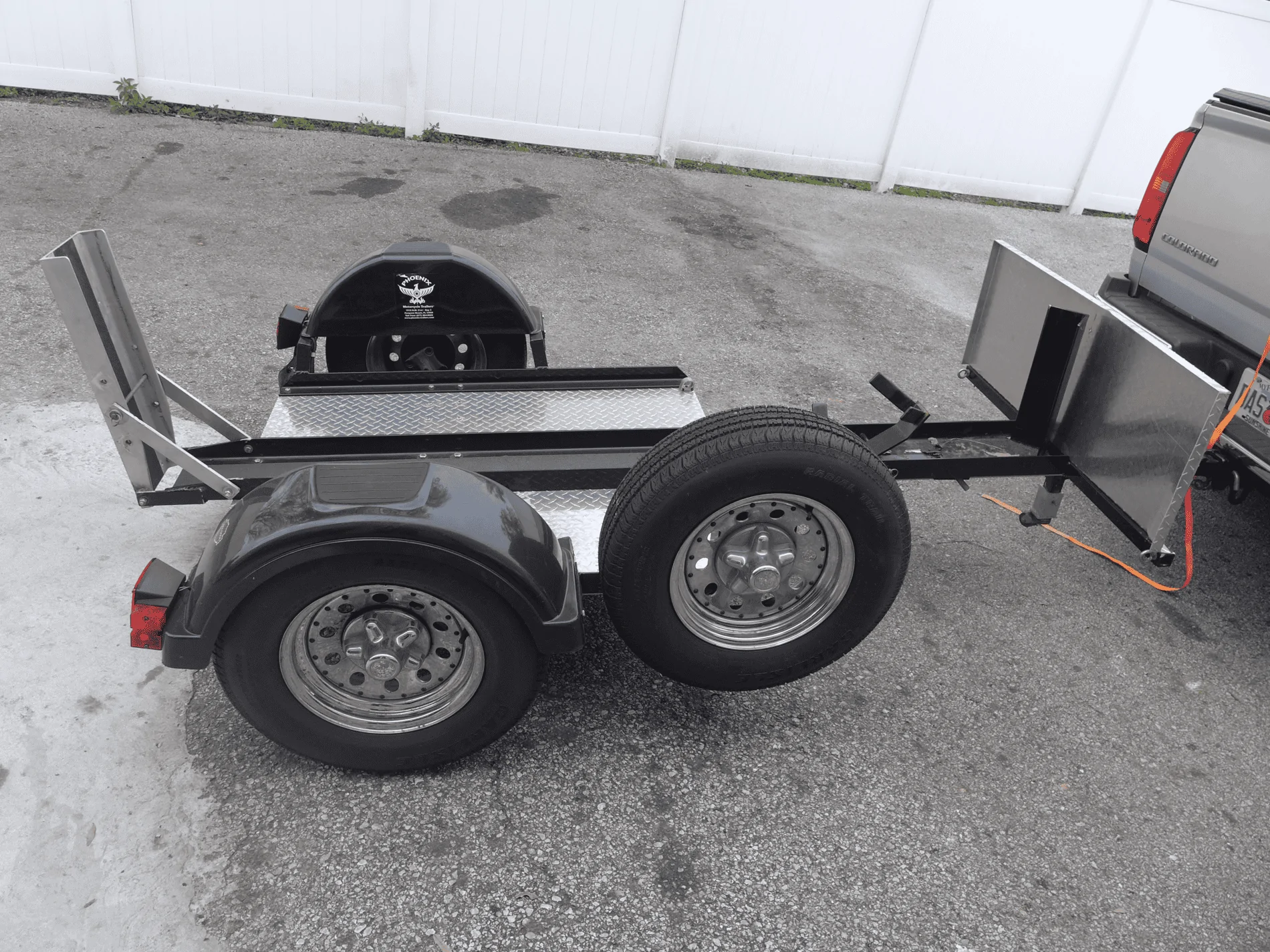

ALL I know is if I had a bike and a decent truck I'd flip for the $500 or so bucks for a better way to haul it around...
