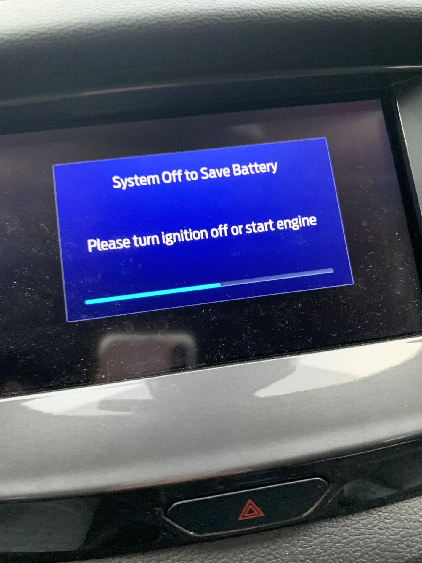

Made it home last night from my trip hoping to get auto update. Because of resets I had to renter my wife info and turn on auto update. Unfortunately, the unit is telling me it is up to date and keeps turning off auto update. Looks like a dealership appointment is coming. Too much damn technology…

Research tells me my APIM is shot or failing. I’m up to date on software after confirming last update was Oct 2022. I hate having to go to the stealership for anything!

What version do you have? Latest Sync 3 is v3.4.23188 which was just recently released. Go to the Ford website and download it and install manually (Could also try getting it from Cyan Labs and use their process instead of Ford’s process.) Sometimes wifi will say up to date and just doesn’t get you the latest.

Thanks. Hooked up through truck Wi-Fi today and is telling me my software is up to date. I’ll try the USB route. I’m under warranty so going to see what the stealership can do Before I mess with it and make it worse ?
