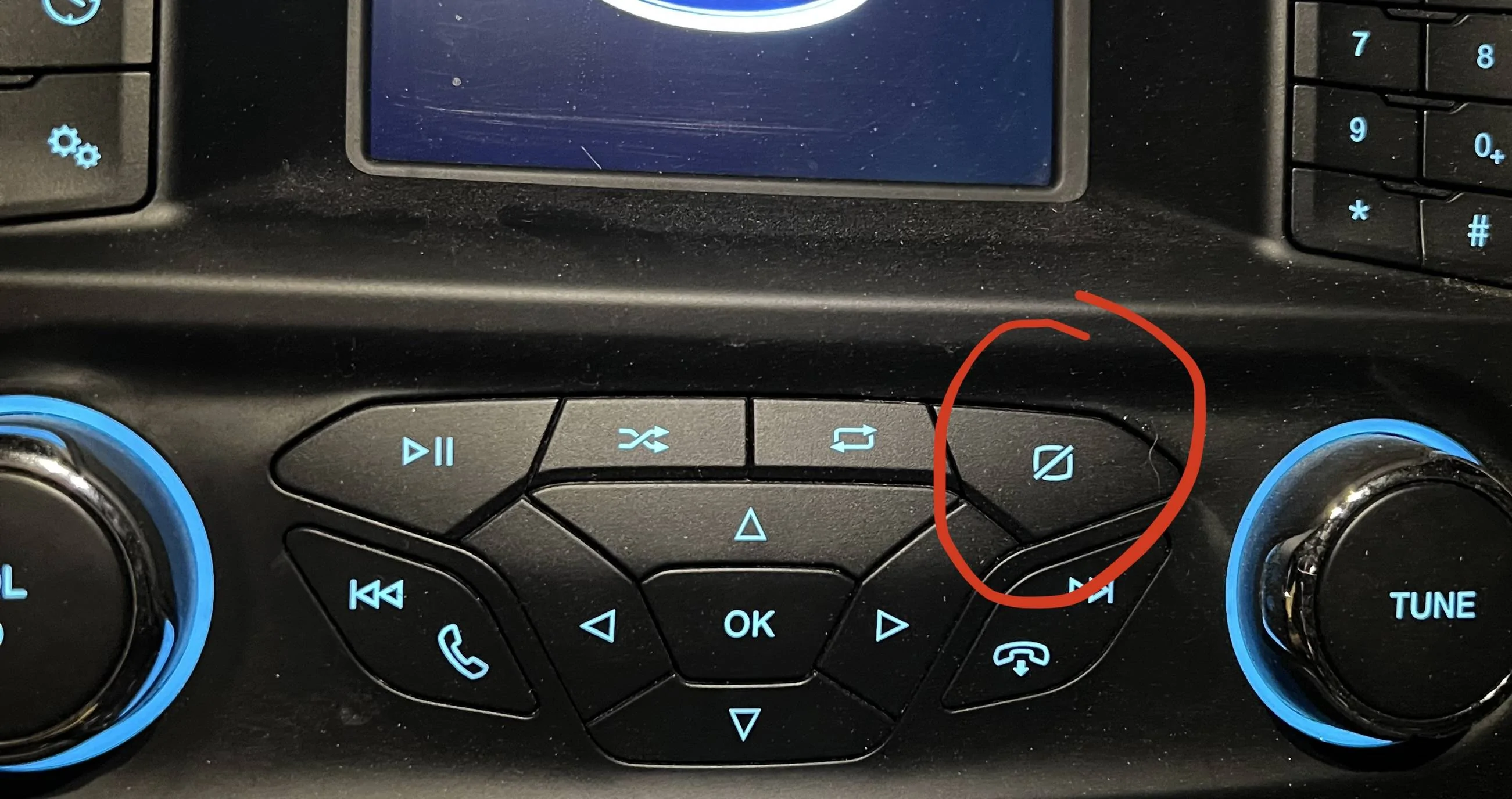

Noface
Jes
Nov 2, 2020
120
521
Mountains
Ranger
Nerd
Not sure why it goes dark but I just hit that button to bring it back.
