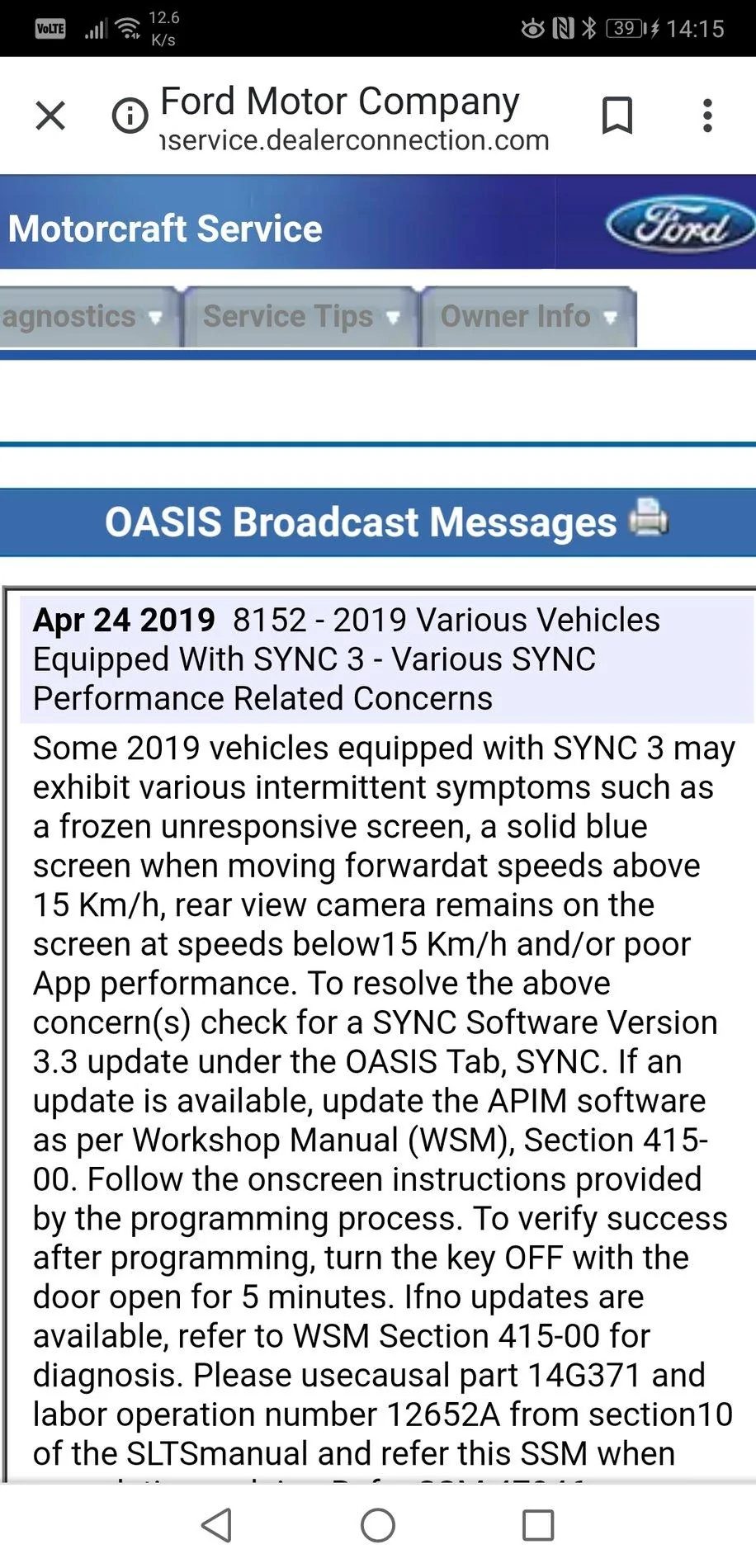

Alright I consider myself more than moderately mechanically inclined so there's that. Techy.... not even average yet.....
My touchscreen system (Sync3) keeps freezing up on me, typically at startup.
Thought, opinions, advice?

I've had it happen maybe once every 2 or 3 weeks. It seems to happen when plugging in my phone. The phone will keep switching from charging to not charging and the touchscreen will freeze. Just hold the power and skip forward button for a few seconds and the system will reboot.

I also have to reboot my system several times per week. Does Ford know about this?

Hold the Seek up and power buttons on the FCIM for 10 seconds to reboot the APIM.

I own two vehicles with Sync 3 (Ranger and Escape). Frozen, very erratic behavior on both. The only commonality was both were connecting to my home WiFi. Outside home area with no WiFi connection, perfect operation. Ever since removing WiFi connection, both performing properly.
Can't trace where problem is so until a software solution is provided, am not allowing WiFi access.
