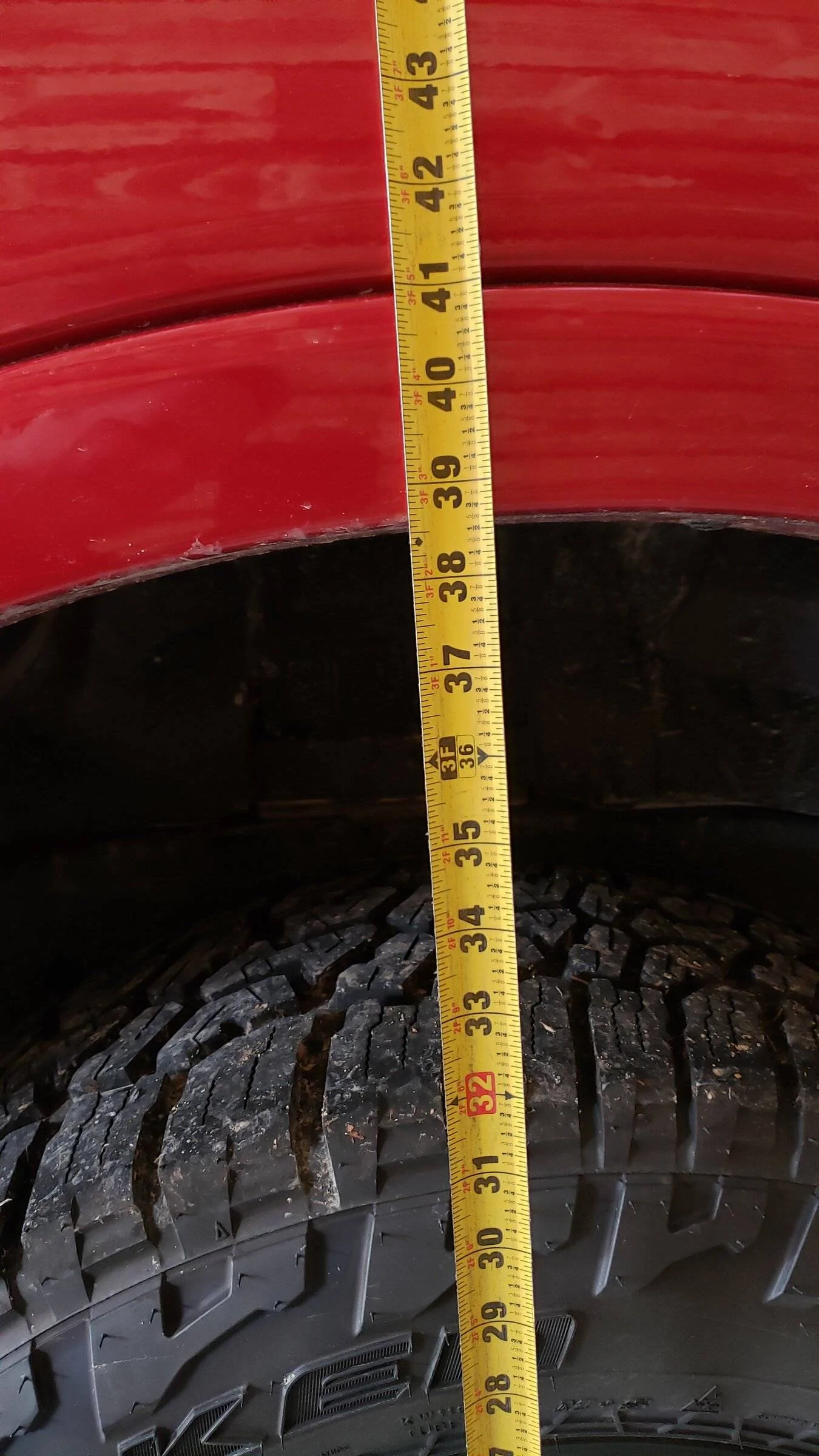

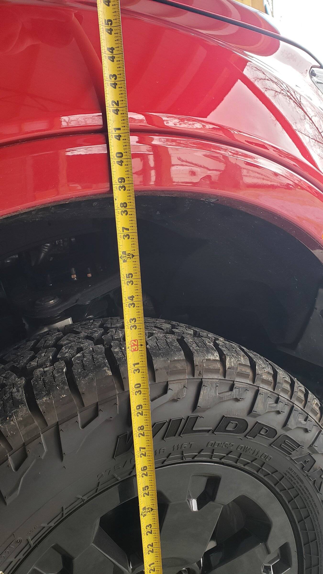

the problem i have with a 2.5 inch level is some of the pics ive seen look like the front may be slightly higher than the back, giving a slight pre-runner look. is the measurement from the ground to the top of the fender fairly identical?
Well the pic I posted looks level to me but just went out and measured for confirmation . Front /rear are less than 1/4" difference sitting in the garage with the 2.5" kit.
Thanks for posting this.
For reference here are my Tremor's numbers with a 1" spacer level:
38 7/8 DF
39 1/4 PF
My rear fenders are .5" higher, but I think the rear fenders are actually taller than the front if the truck was perfectly level.
The best way to measure levelness is the pinch weld of the cab.
