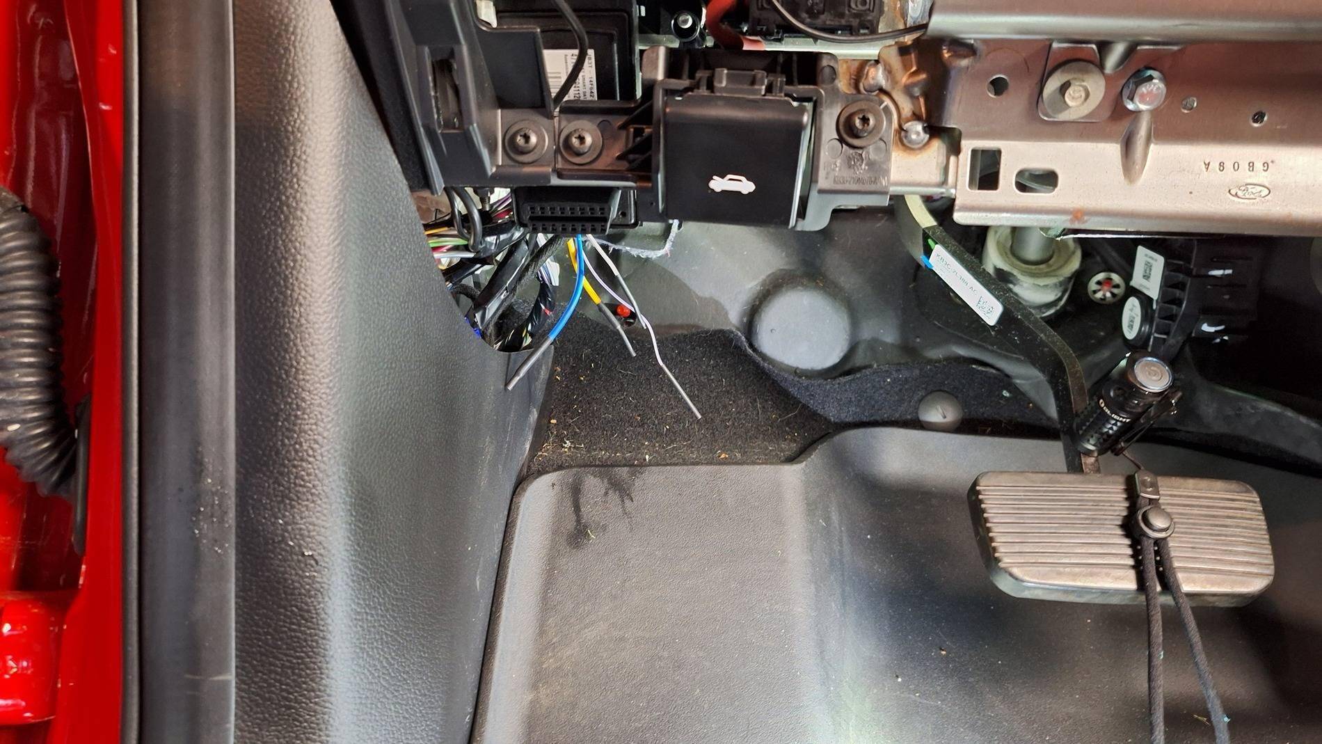

I went with the Redarc Liberty but, if I had more confidence, would have loved the Ford unit. BUT ... connecting to the high-mount brake light seemed too daunting to me.
As far as holes, there are several options for the Redarc. I went with the "factory" location but love the idea of it being centered so that the passenger could hit it too. There are folks here that replace one of the 12V plugs or place it near the gear shift.

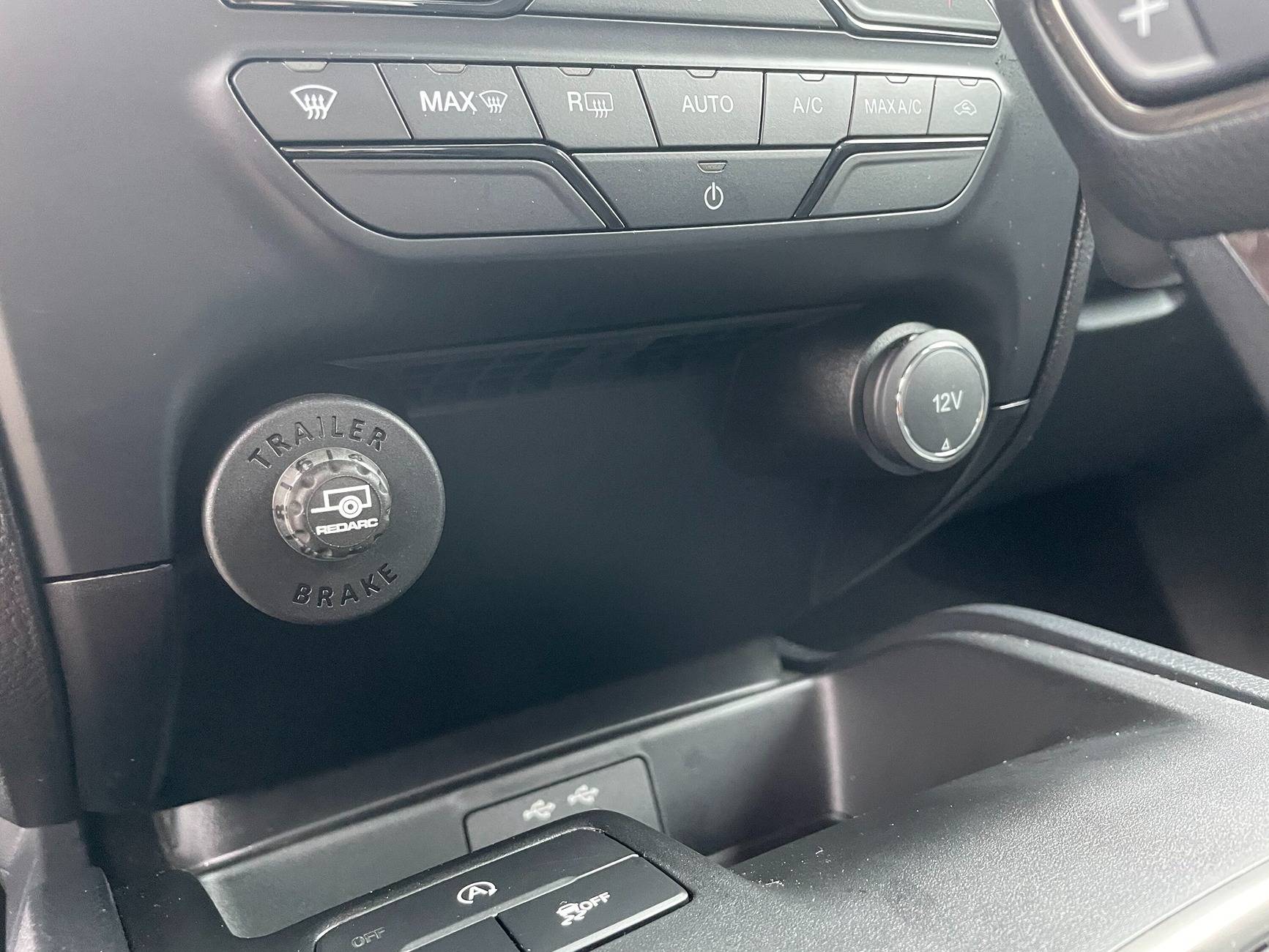

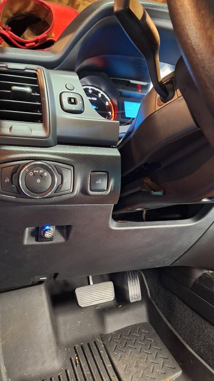

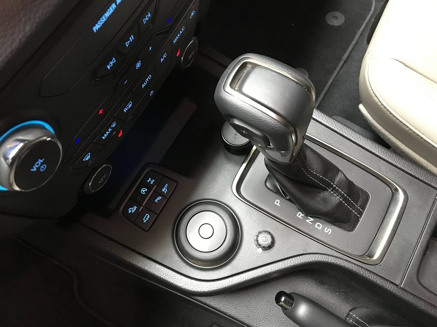

As Big Blue said, you can use the RedArc TBC, even if it's not the Ford OEM that has the Lumen module for minimalistic footprint. Here are coupe examples of where to mount it. All you will see is the dial, everything is hidden behind the dash.
Those are clean installs!
