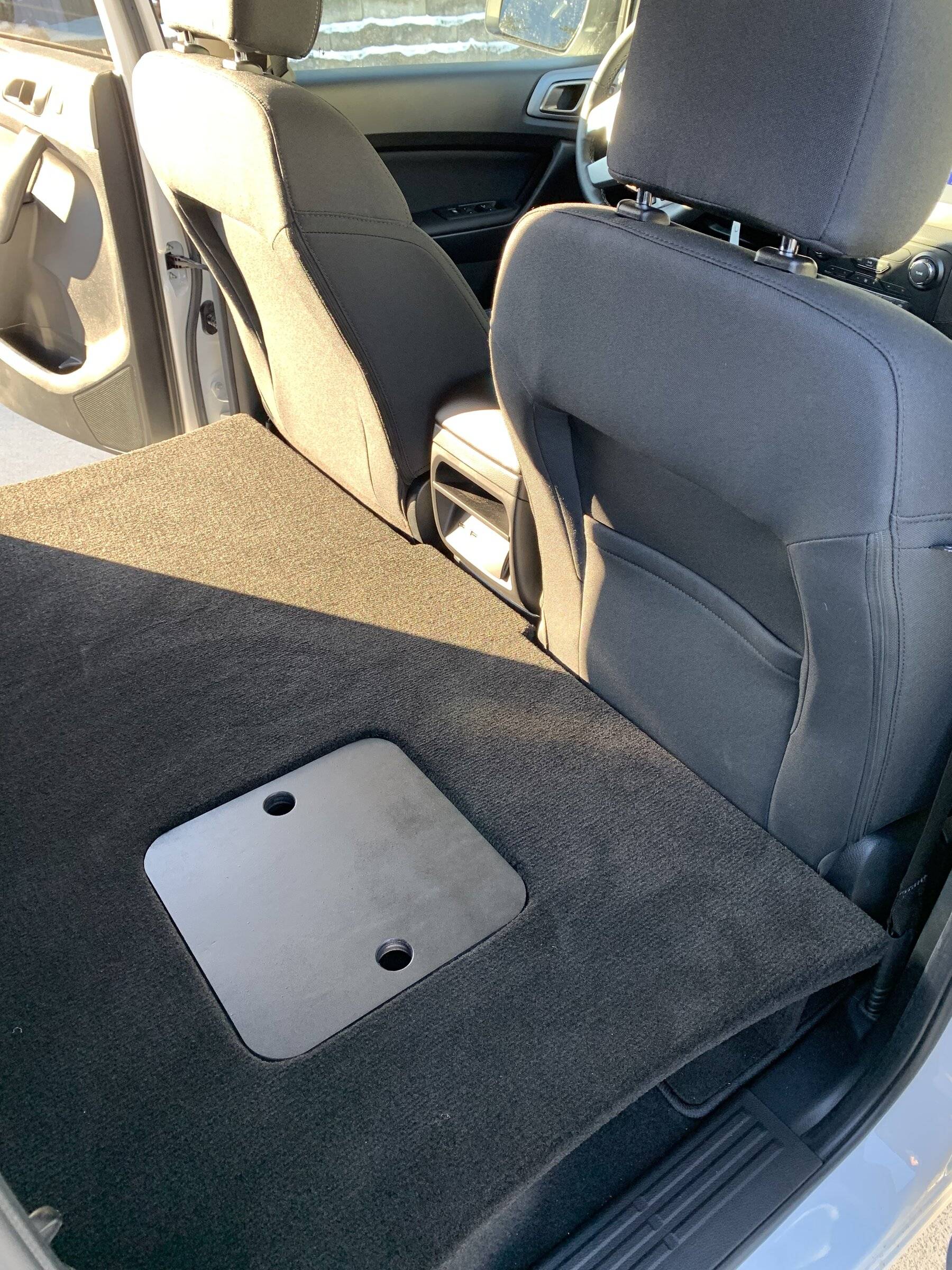

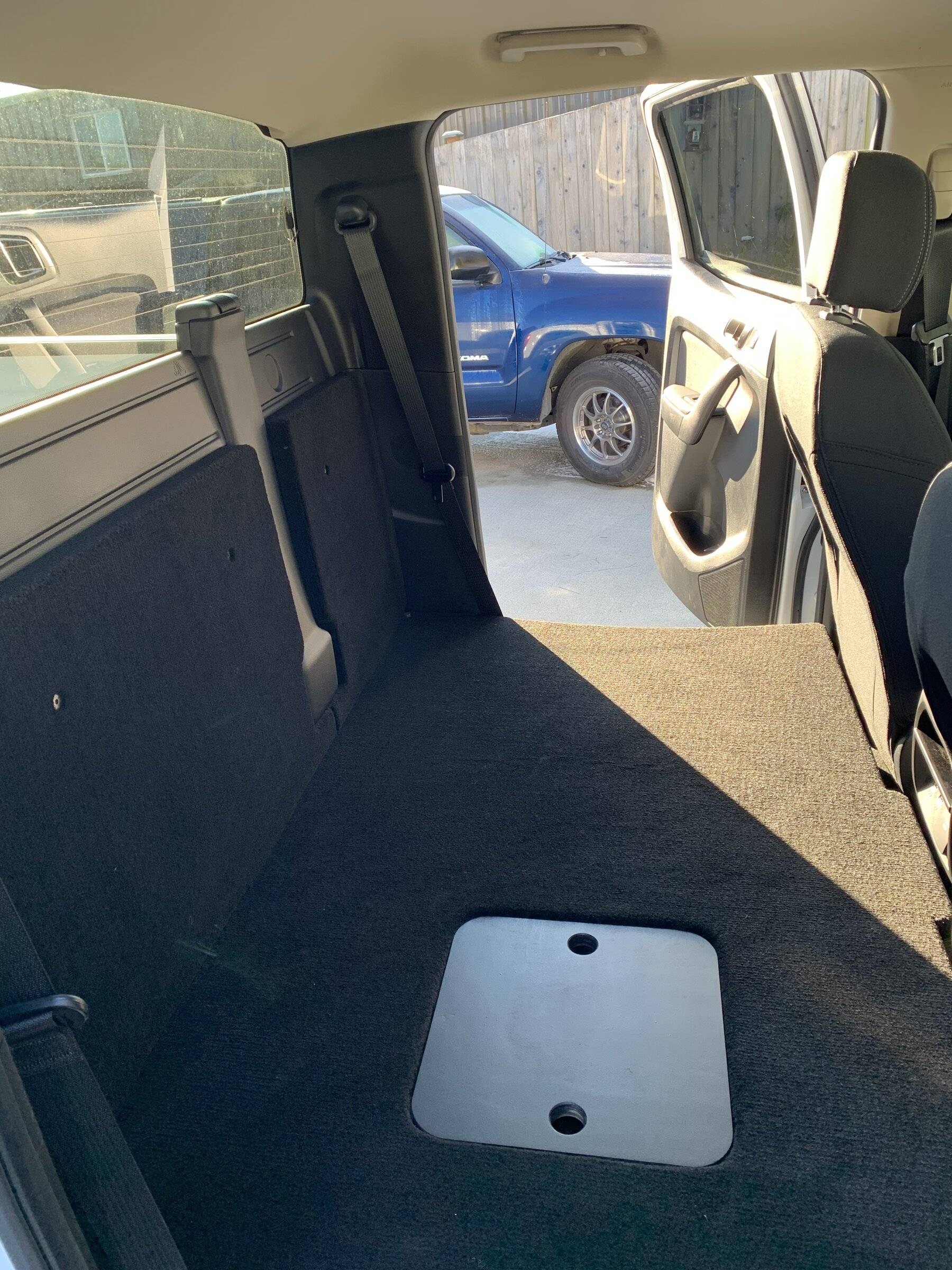

Any pics of the storage underneath, does it lift open?
Loudspeakerboy
Michael
Dec 17, 2021
PNW USA
21 Ranger XLT Supercrew Sport 4x4
That looks great. Details?

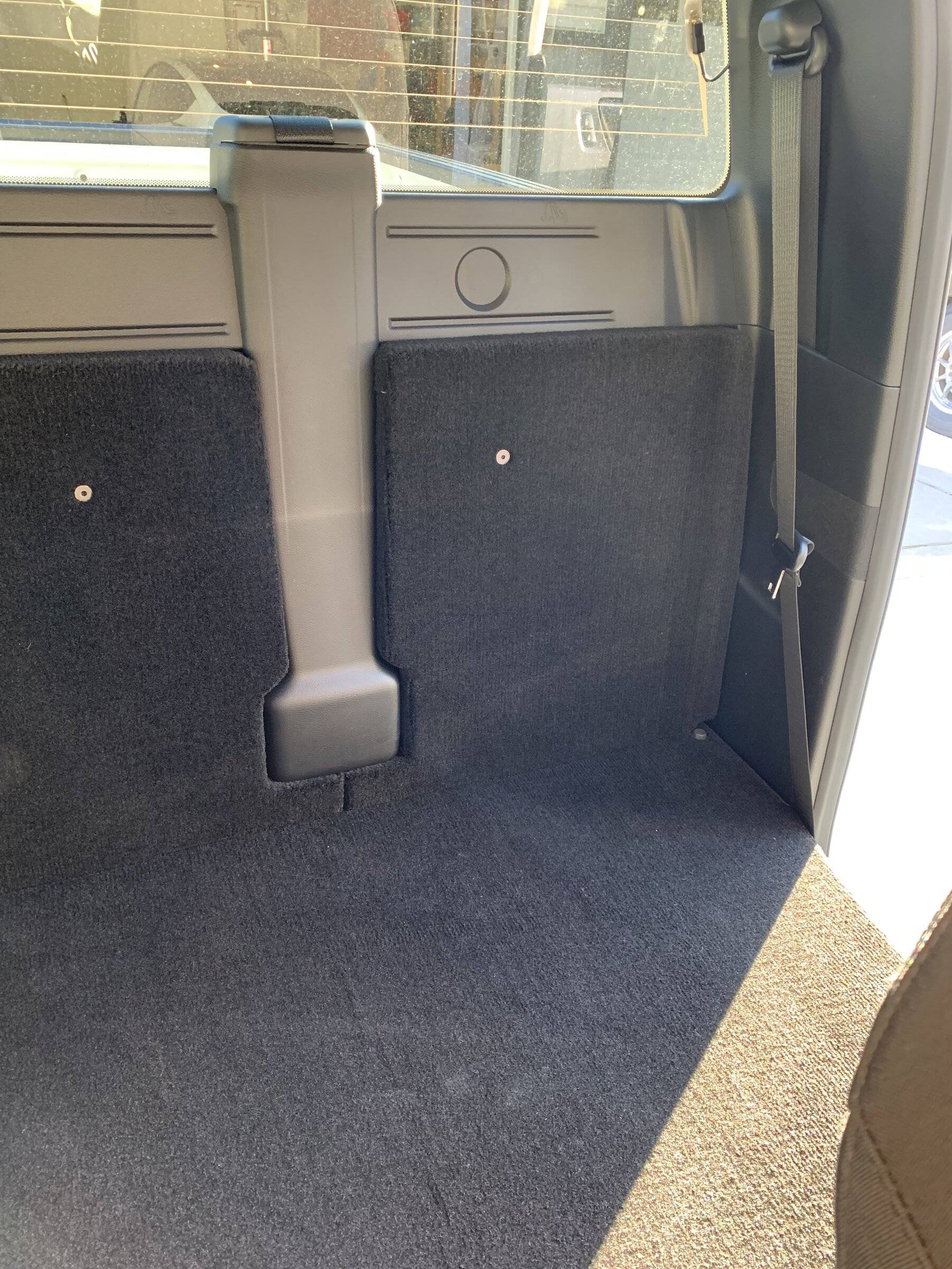

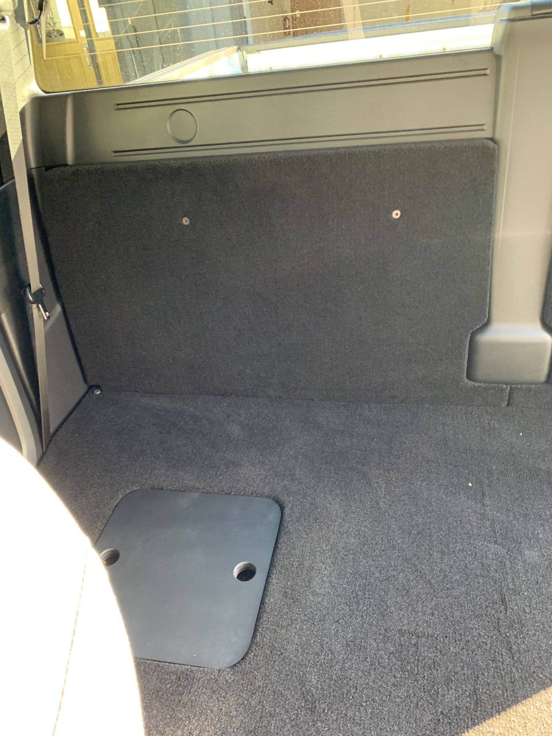

There is access at the ends for footwell storage. The deck is set as low as it will go without removing any metal. The front edge is supported by a transverse bulkhead that runs from footwell to footwell, up and over the hump. The distance from the hump to the underside of the deck is about 2-1/2”. The larger stock storage area is accessed through the deck. The small stock storage area is used to store the belts and wiring and is unaccessible. The flat deck is held using the stock bench seat anchor points. The back panels use the child restraint anchor points. No new holes were drilled in the truck. The construction is CNC cut 3/4 maple plywood covered in 20oz marine carpet. The carpet is glued on which is what took the longest. It is very solid and can be back to stock in about 20 minutes.

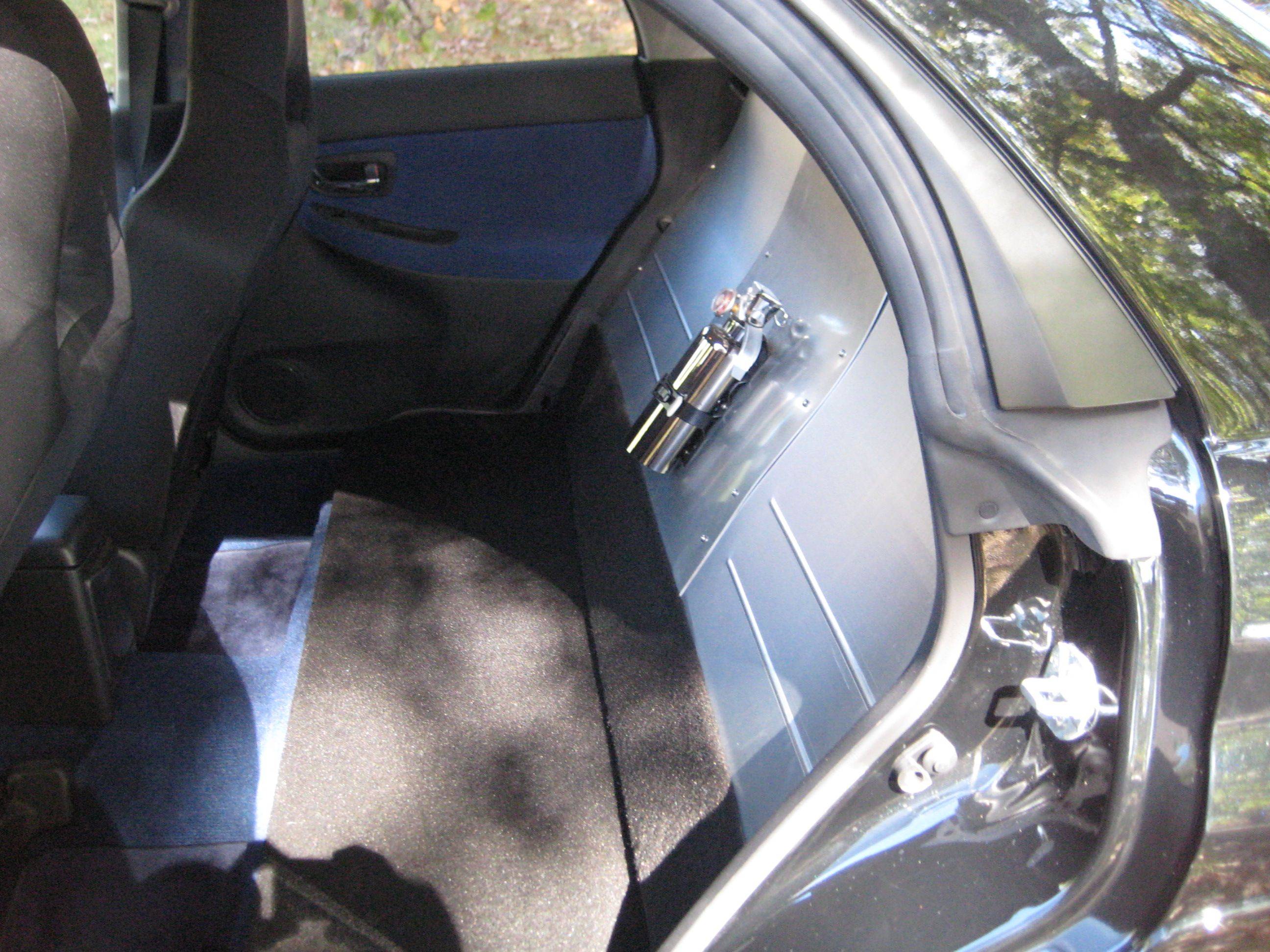

2021 Ranger Tremor, 05 &10 Subaru STI, 911, LC +2
ER Nurse/Nursing Instructor Retired
The rear seat delete on my 2021 XLT Supercrew is finished.
Good morning, Nice job on the rear seat delete. I have done similar mods to a couple of car and trucks. Have you considered making the plans and necessary component information available. Frankly I think this is a salable idea, either plans or complete product. I would certainly pay you for either. Please advise!

That's super clean, well done.
Care to share the CNC cut files or dimensions?
