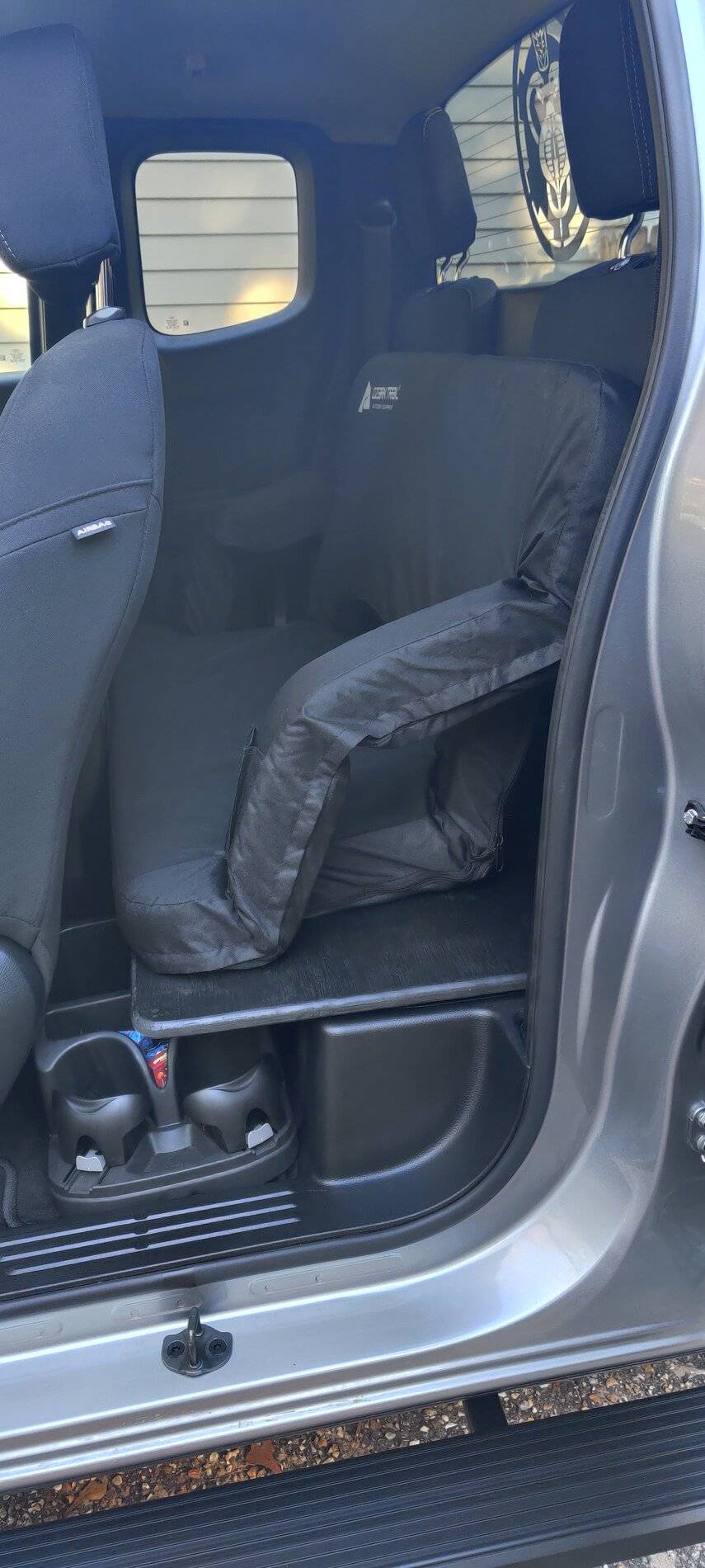

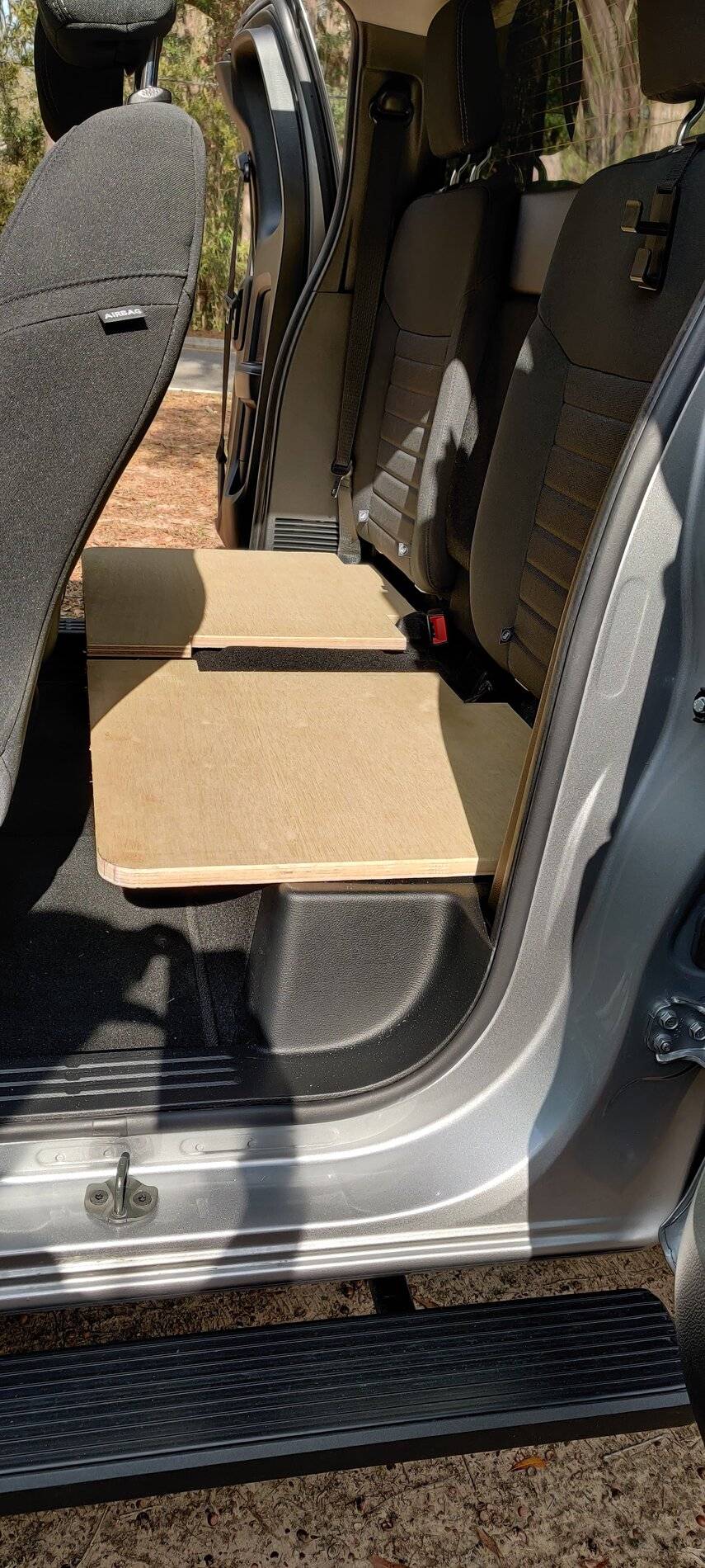

I found instructions on the forum, don't have the link, sorry. I use it for road trips, the kid loves it! The cushion is a tailgate bench I found on clearance at Walmart.

Do seatbelts work with the tailgate seat? Does the tailgate seat anchor to the platform?

I'm gonna guess no on both of those.

The seat belts can work, with a little bit of maneuvering; just a matter of sliding the tailgate seat forward a little. There's a gap where the tailgate seat folds in half, and it allows plenty of room for the buckle to latch. I attach the straps on the tailgate seat around the boards, to keep it from sliding around.

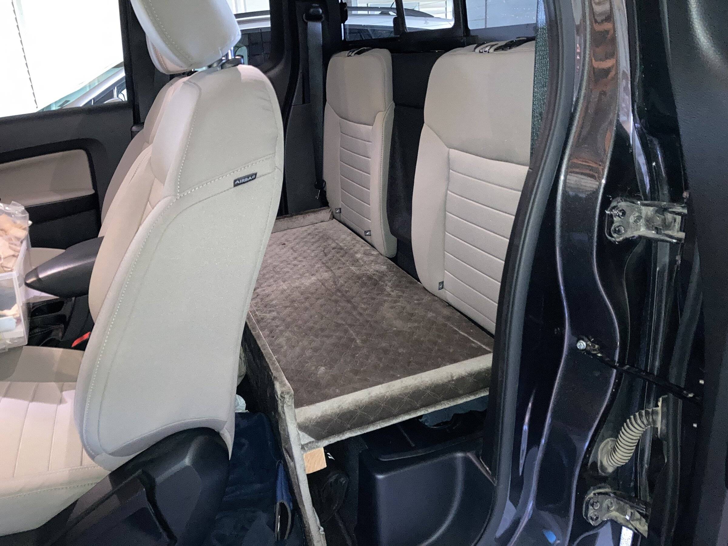

I made a platform for our pups to ride along in... it's been a success to this point as they were notorious for getting car sick in our other vehicles, but have yet to on the platform.
Exactly what I want to do for my pup. Would you mind sharing the dimensions of the board and the height of the front braces? Thank you ahead!
sorry for the delay. The board is 32” deep and the width is tapered from 52” in the back to 49” in the front. The front braces are 7-3/4” on the passenger side and 7-1/4” on the driver side.
