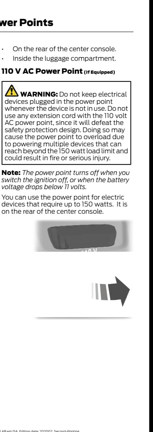

Hi,
I was reading through the manual (again) about how to use the AC outlets in the back. The USB ports for charging work, but when I connected my laptop to charge, no dice. This happened (or didn't) with the truck both on and off. Nothing specific was mentioned about their use, just plug & chug.

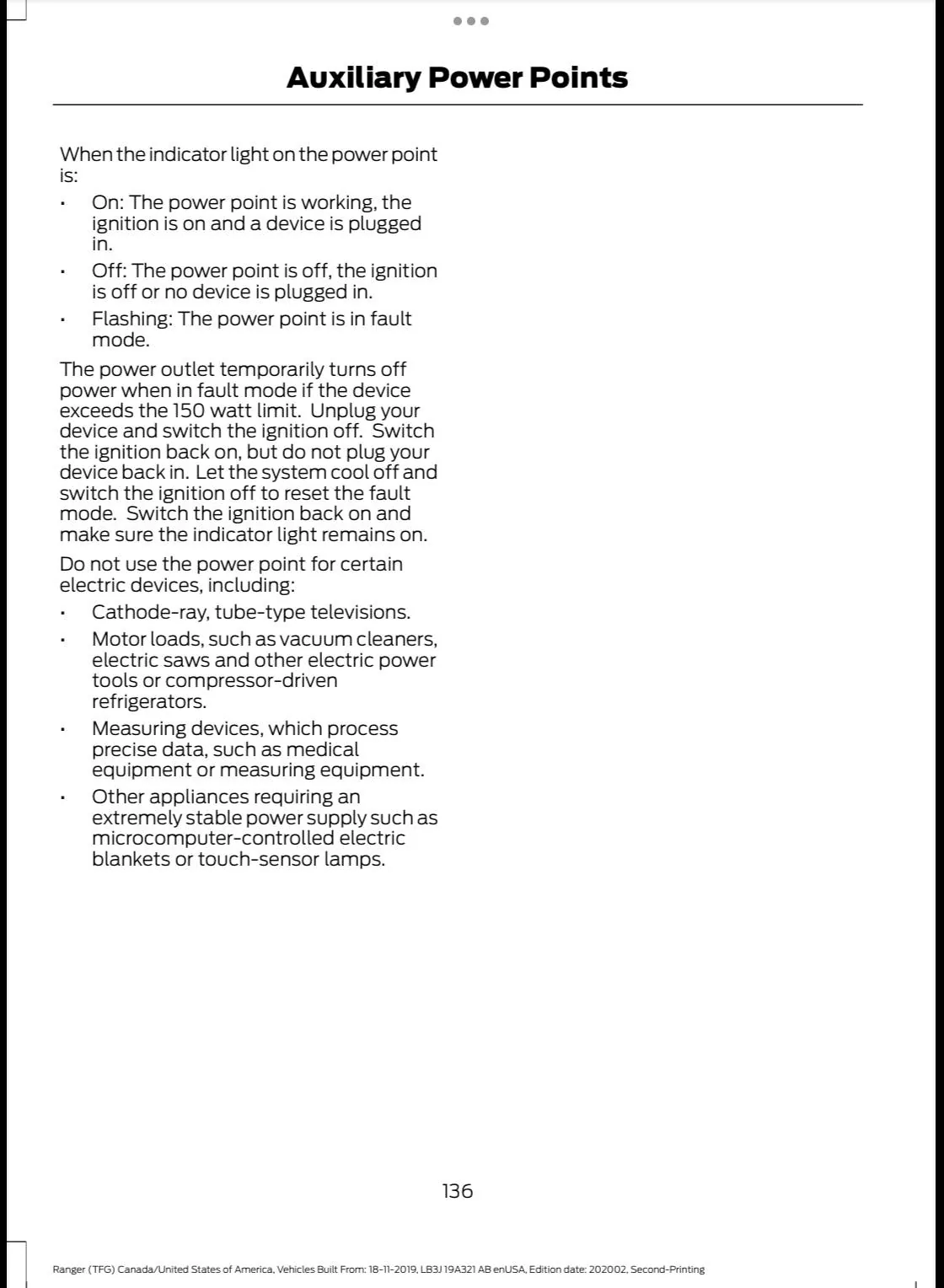

If the laptop tripped it, I think you have to let the outlet reset (I think let the truck fully power down and the try again once it is running) before anything else will get power. I know my laptop has a 180W power supply and that is too high for the Ranger's outlet.

I have two power adapters for my work computer, one's designed to be a at-the-desk power adapter, which I believe is 240W. The other is a portable one, that's 160W... Which is more than what's stated that the AC outlet is rated for. However, I have no problem using the 160W one to charge my laptop. But I tried using the 240W, and it just didn't work - I didn't blow the fuse or anything, it just said nope and wouldn't turn on. Probably some sort of current overdraw protection deactivated it.
Not saying that's what's going on with yours, but 150W is REALLY low, kinda embarrassingly low. Especially when the base F150 one is 400W, with option 2000W (and then hybrid at 7200W... but that's not a fair comparison).

Check your owners manual. Searching online, makes it look like closer to 250W draw and so the truck won't work as built. Keep in mind that with all these conversions, it's not super efficient and make draw more than you would expect

I’ve used that outlet to charge my iPhone, power my Iceco 12v fridge, and even charge my Bluetti AC50S.
Only time I’ve ever had an issue was trying to use a small heating blanket.
