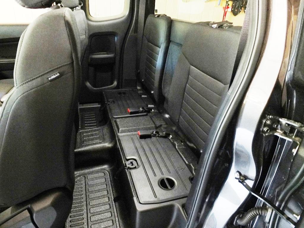

Just leaving the factory seats and seat belts in place works well. The curved seat backs help to hold items in position. Plus when you aren't hauling anything your truck still looks nice.
Be careful covering up the rear vents... they need to be able to dissipate internal pressure and help the HVAC to work correctly.

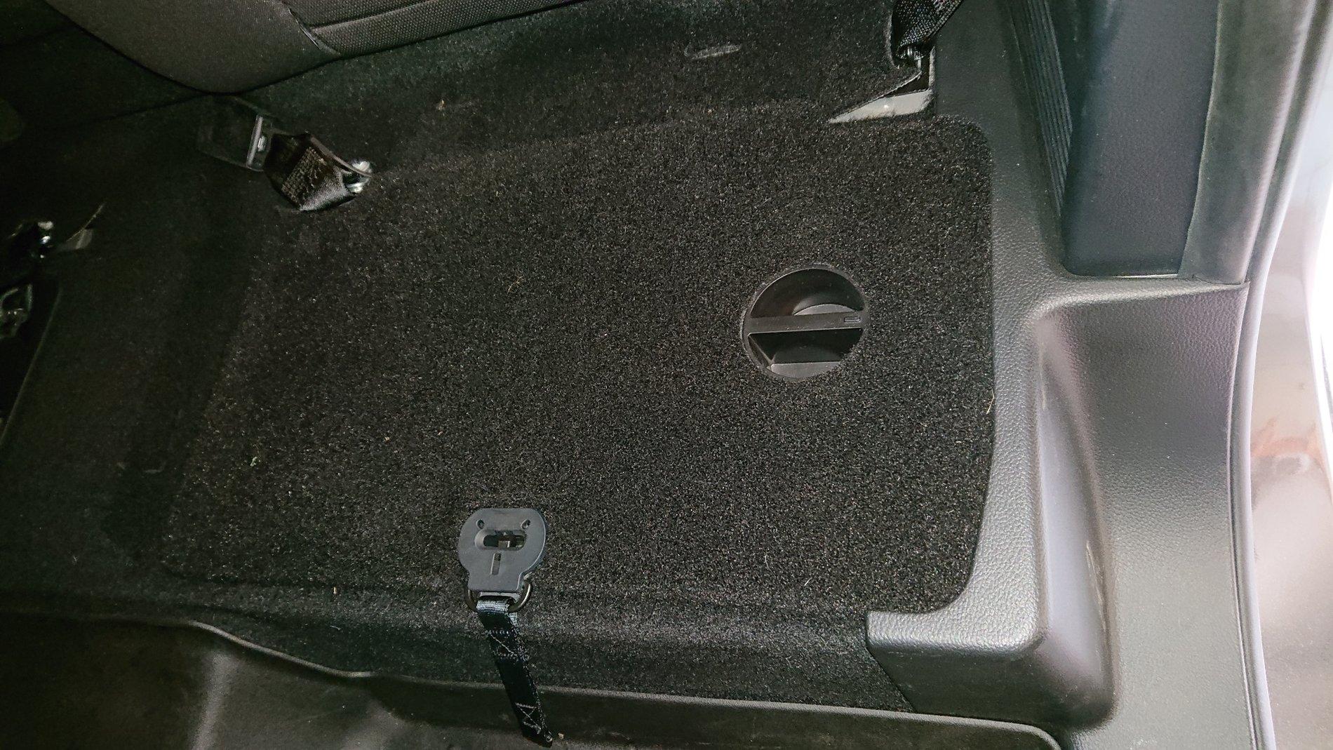

As a first step I'm carpeting the storage box covers with auto/marine carpet I found at Menards and 3M spray adhesive. I hated putting things on it as they slide off or get scuffed. The seat bottoms still attach just fine.
carpeting the under seat plastic is a good idea. ill have to think about that.

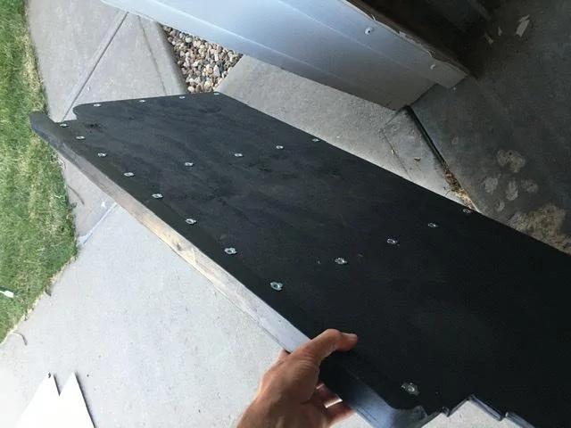

this is what my board looks like. fits well. waiting for the liquid nails to dry before i drill the holes to accept new bolts
That looks nice, can't wait to see what is looks like installed. For the bottom are you going to slot where the seat u-bolts protrude and use a wedge? I was thinking of slotting the plywood so there are fingers to slide into those. Not sure what's best, that can wait though. I just picked up some 1/2" plywood so I can start tracing the sides.
i decided to just perch the board on top of the u-bolts, not make a slot. slot would probably look nicer, but i was happy with this simplistic version and i dont envision seeing that bottom edge much as it is going to have gear there the whole time.
my plan for now is secure it with a wedge. but when i stop taking it on and off after any final adjustments i may make a lower profile fix at the bottom, probably incorporating the lower clips that used to hold the seat back.
tracing was a pain in the butt. its a complex shape. i could send you my trace, although only would work if you wanted the board inset to cover all metal, and not overlapping the plastic. for a more finished look you could have it overlap the plastic at the top sides and rout out the back side so it mates nicely.

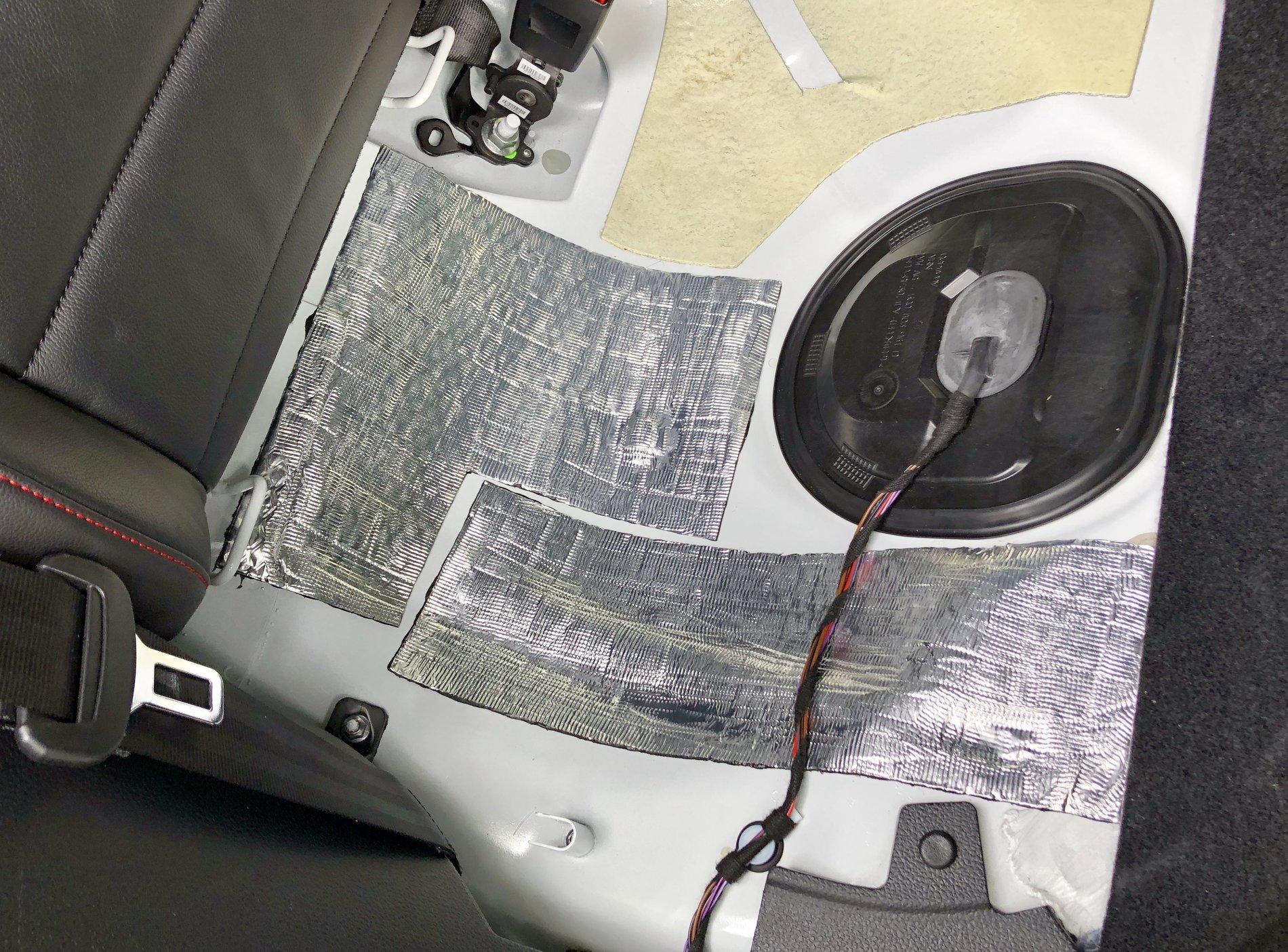

Sound proof sheets. Best for less bulk

Are the off-white pieces factory sound deadening ?
Sandman Ranger
Pete
Jun 16, 2019
876
1,273
Lead Process Engineer

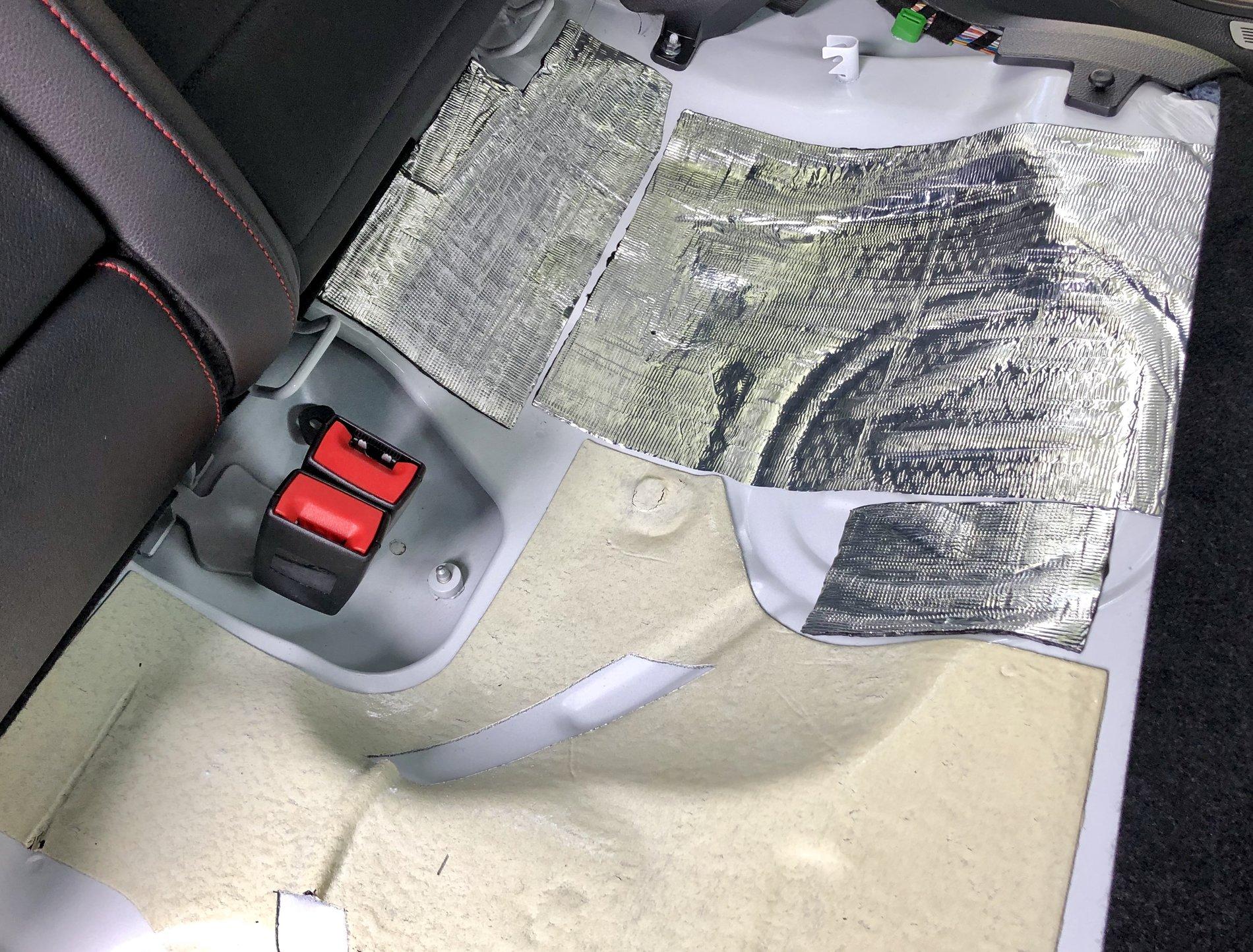

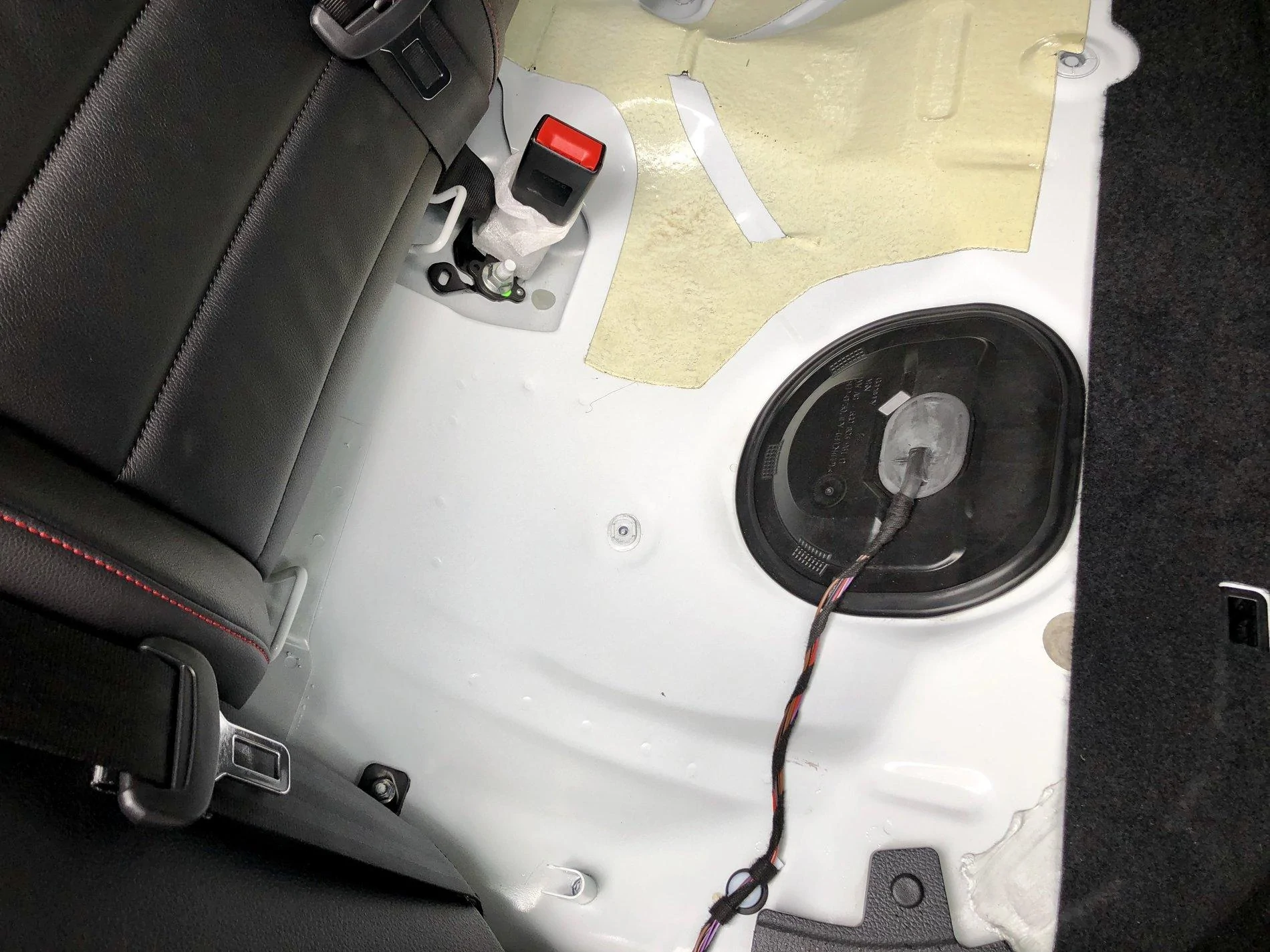

On a VW GTI, yes.
under rear seat above gas tank.
Used for example of adding sound deadening sheets.

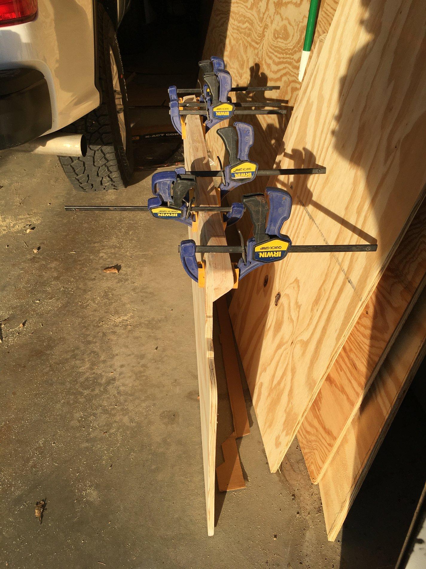

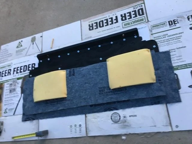

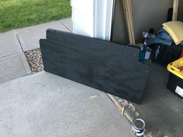

i put it together this weekend.
it’s 1/2” plywood plus a piece of pine at the top. the latter was a pain in the butt with its odd angles. the board is painted matt black and drilled with M6 t-nuts in all the holes. same bolt and thread as my roof rack and topper inside hardware so i can mix and match in the future.
the sound deadening is what i had lying around: some felted synthetic blanket and a little leftover memory open cell foam over the vents. all that is held in place with a few staples.
the board is held in place at the top using two countersunk heavy bolts in the original seat back securing bolt holes. at the bottom it is perched on the u bolts that are attached to the back wall. for now the bottom is held in place with a piece of ugly 1/2” plywood as a wedge in the u-bolt but in time either it won’t need anything because i will use straps to the u bolts to secure my cooler and toolbox which will pin the bottom tight against the rear wall, or if i don’t like that i can build something to include the rear seat clips that will look nice and be hidden. i doubt ill go the latter route- it is a nice secure fit without anything securing the bottom. i only need the bottom secured while driving, and while driving i will have the cooler and other boxes strapped against the rear wall.
to attach stuff to it i have M6 ring bolts, and various other hardware so i can attach whatever i want. i can bolt a milk crate on, or put shelves in, put ratchet or cam straps on, or screw right into the board, whatever.
so far so good. we’ll see how quiet it is when i finally get it on the road.
