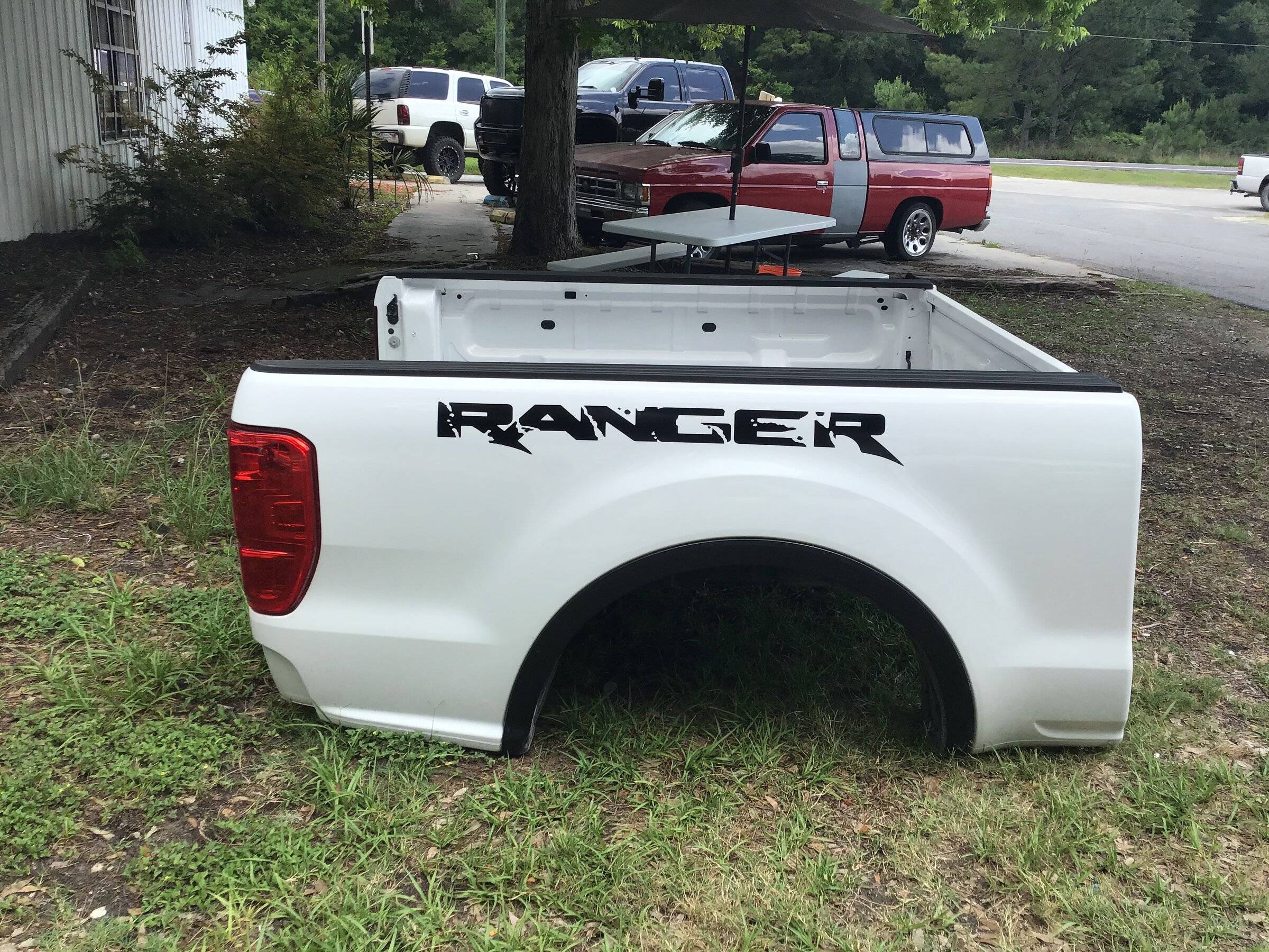

That is crazy. Do they weld the bed and the cabs to the frame so there is no adjustment. I would call BS
All Ford pickups I've owned in the past use U nuts and torx head bolts to secure the bed to the frame. If you loosen all 6 bolts you many have enough movement in the bed to get it to where you want it, the body shop should know this...unless Ford has changed their method of attaching the bed.

Yes it can be. 6 bolts from underside and you can nudge it around. The only thing that stinks about that is all the bolts need to be replaced if loosening them. That what factory says. Torque is high enough so they stretch so can’t reuse.

I had the same issue. The bed is pinned and my dealer couldn't fix it. A local shop moved the cab and now it's perfect.
Not sure what that means. Bed is pinned
The bed can't be adjusted more than a few millimeters side to side. That's why they moved the cab instead.
I checked the lot that day (pre-covid when dealers actually had inventory) and half of the Rangers had the same issue.
