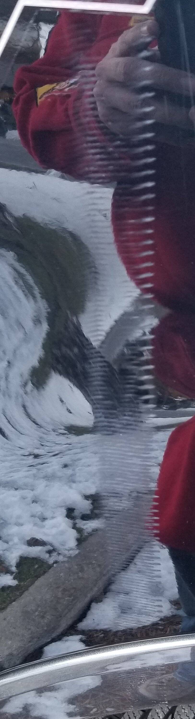

Don't use your finger pads. Use the edge of a finger nail. It will lightly drag on any slight scratches whereas a pad might not notice it. Use the least aggressive polish you can. Even some waxes labeled as "cleaning wax" have grit in them to buff out slight scratches. To test fro grit, put a small amount on your thumbnail. Rub your other thumbnail on it and you will feel if it has any grit.
I tried with the finger nail, and you're right, I feel the ridges. RE: the cleaning wax, do I want grit for this instance, or will that make it worse?
You need a small amount of abrasiveness to smooth out the scratches. A polishing or cleaning wax is milder than a polishing compound and should be plenty in this case.
Always start with the least abrasive compounds and lightest pressure and slowly increase if you don't see improvements. Too much grit or pressure can induce their own scratches.

Nu Finish is my go to.
Clean the area well. Put the polish on a microfibre towel and pat it onto the area. Let it dry and wipe it off. See what blemish is remaining that may need another application and some rubbing this time.
