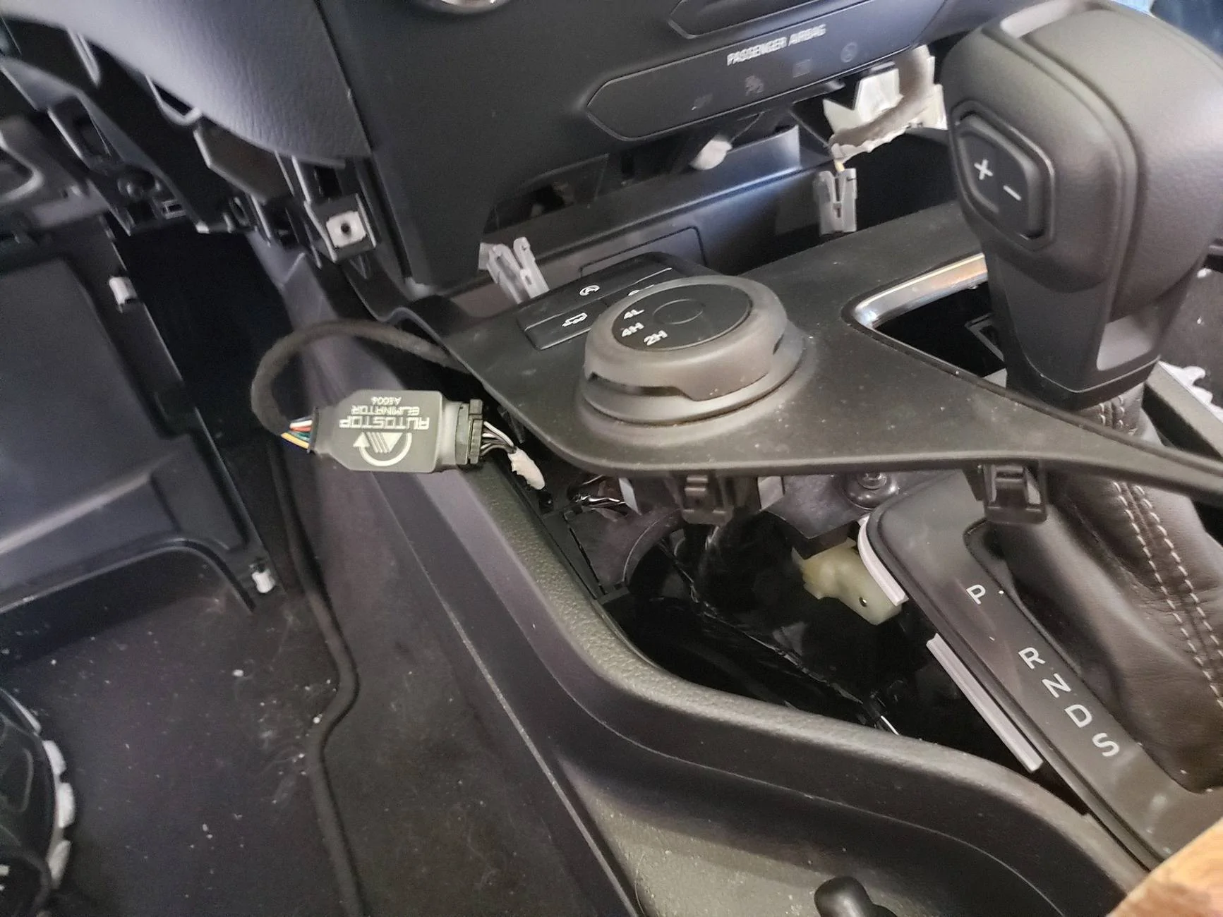

I have the 2019 and I installed that same device shortly after I got the truck in early 2020. I used the video as a guide and they do make it look much easier than it is. I think it took me about 15 minutes to install it. I do enjoy not having to push the button every time I start the engine. My wife’s car also has ASS and when I drive it for whatever reason I always forget to push the button.
