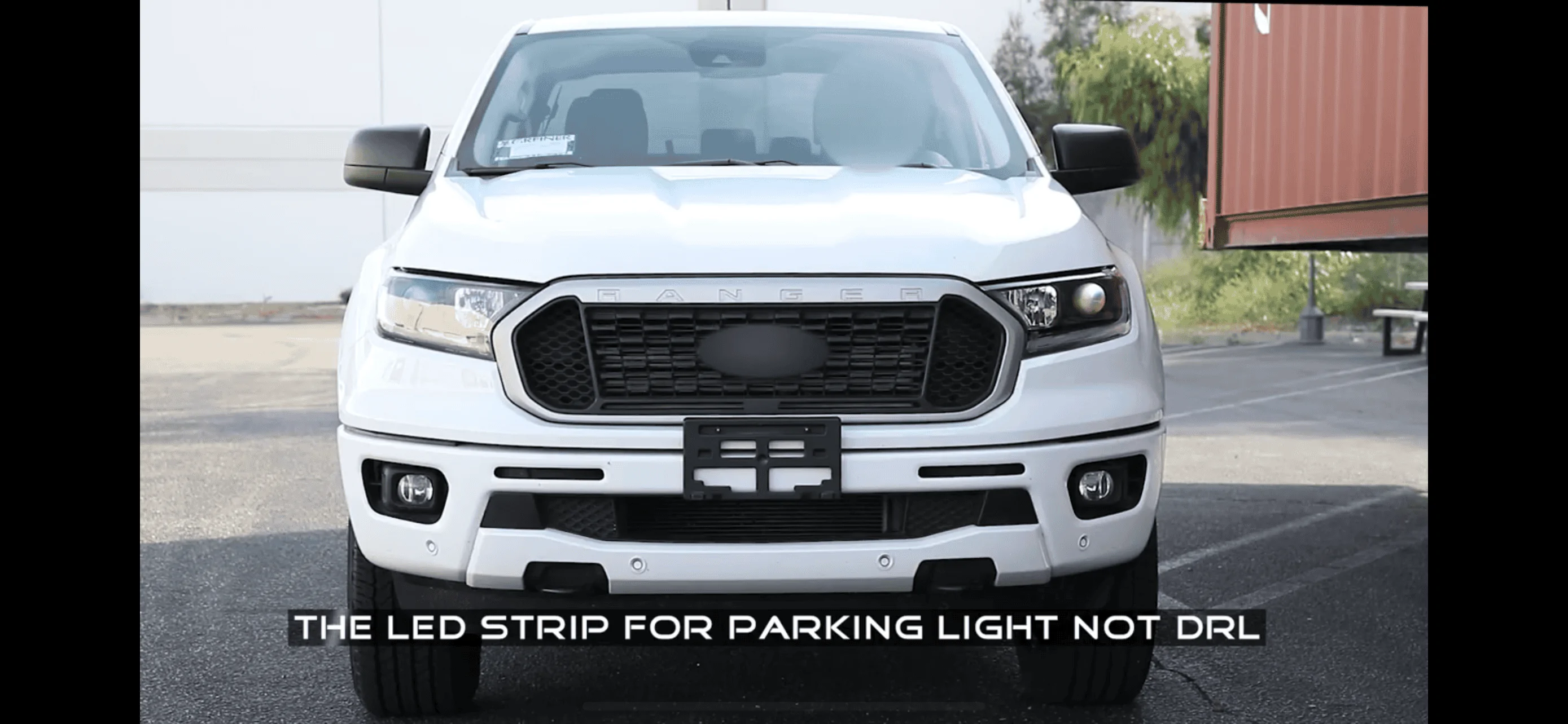

Looks like reflector low beam and projector high beam. Only thing that appears LED is probably the turn/DRLs. At least Alpharex Pros are projector low beams.
Haven't seen those before. Let us know how you like them.

In my opinion, I think if you’re going to upgrade the headlights, spend the extra money to buy full LED projection ones. Installation is an ordeal unless you have experience so it’s not something you want to do now and again later if you’re not happy with this set.

I found this video on youtube. They look okay, I’m more concert about build quality.
Gonna do more research or wait for the alpha to go on discount lol.

So the led strip is for turn signals and parking lights only? Not for the drl…pass.
Got it backwards there. The reflector is high beam on that light assembly. In and headlight assembly where the high and low are separated like such the high beam will be the inner and the low beam will be the outer.
