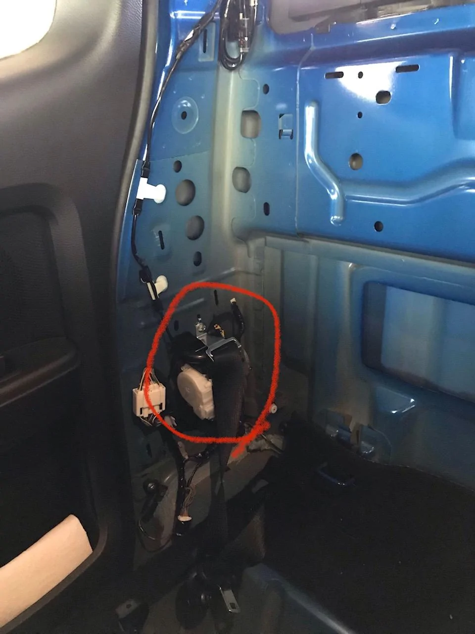

This is where the sound was coming in. Removing the plastic panels in the back corner made the sound WORSE. I had dynamat and soundproofing foam added in both rear corners and on the back of the cab. I still notice road noise coming from that corner but it no longer sounds like my door/window is open.

Interesting. I have a SCAB with the same issue. It sounds like a window is cracked in the back passenger side when driving over 60 MPH. So it was the area you circled then? Did you remove the panels yourself or did someone else remove them and do the insulation packing for you?

IQ Autoworks in Campbell, CA did the work and the diagnosis.
The noise actually comes from both sides of the truck, but you can only hear the passenger side while sitting in the driver's seat.

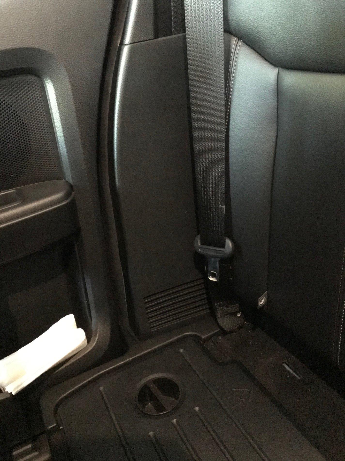

Here's a pic of the truck reassembled. The noise comes in from the vent next to the seatbelt. Remove that panel and the noise will be much, much worse.
