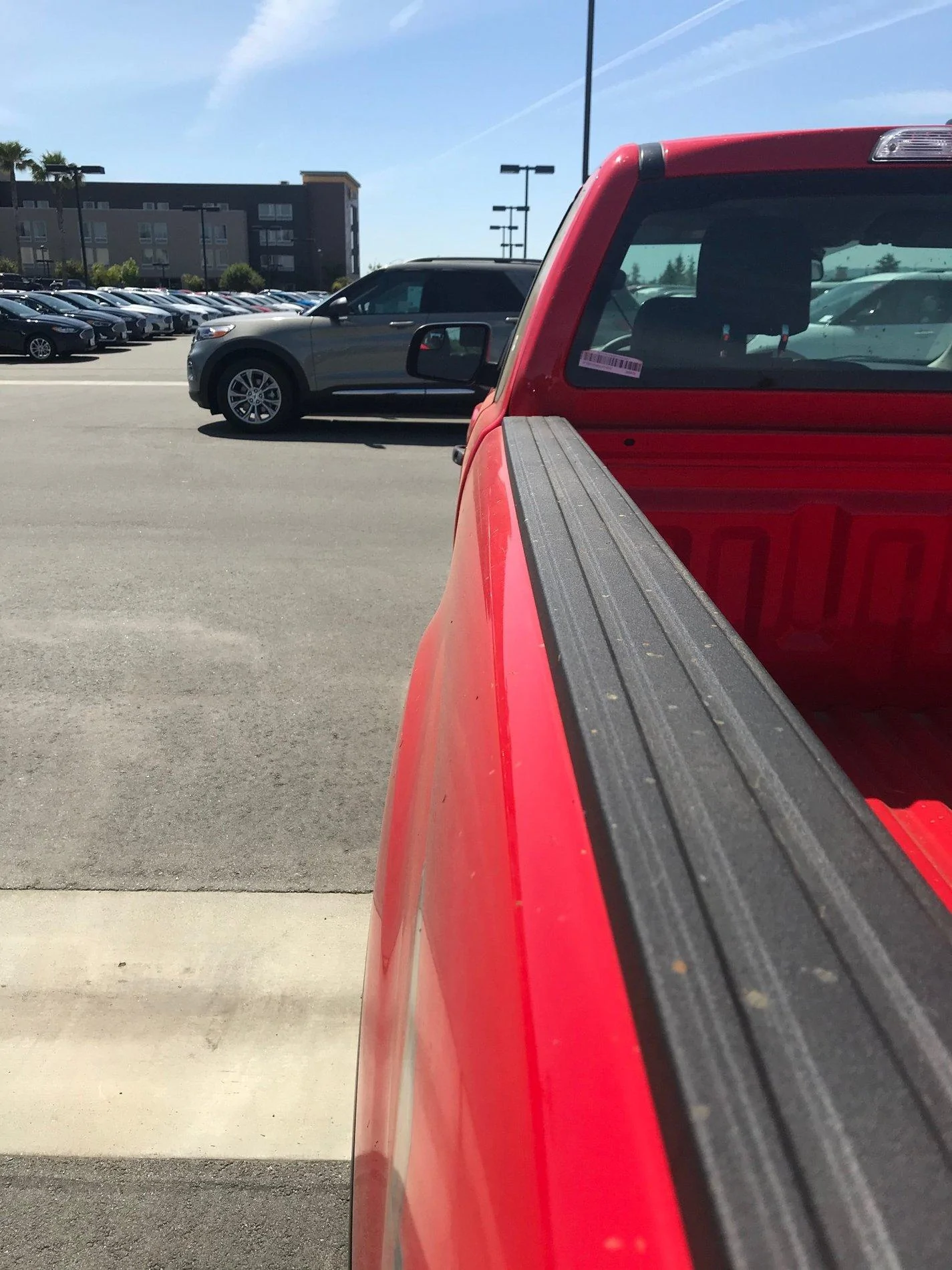

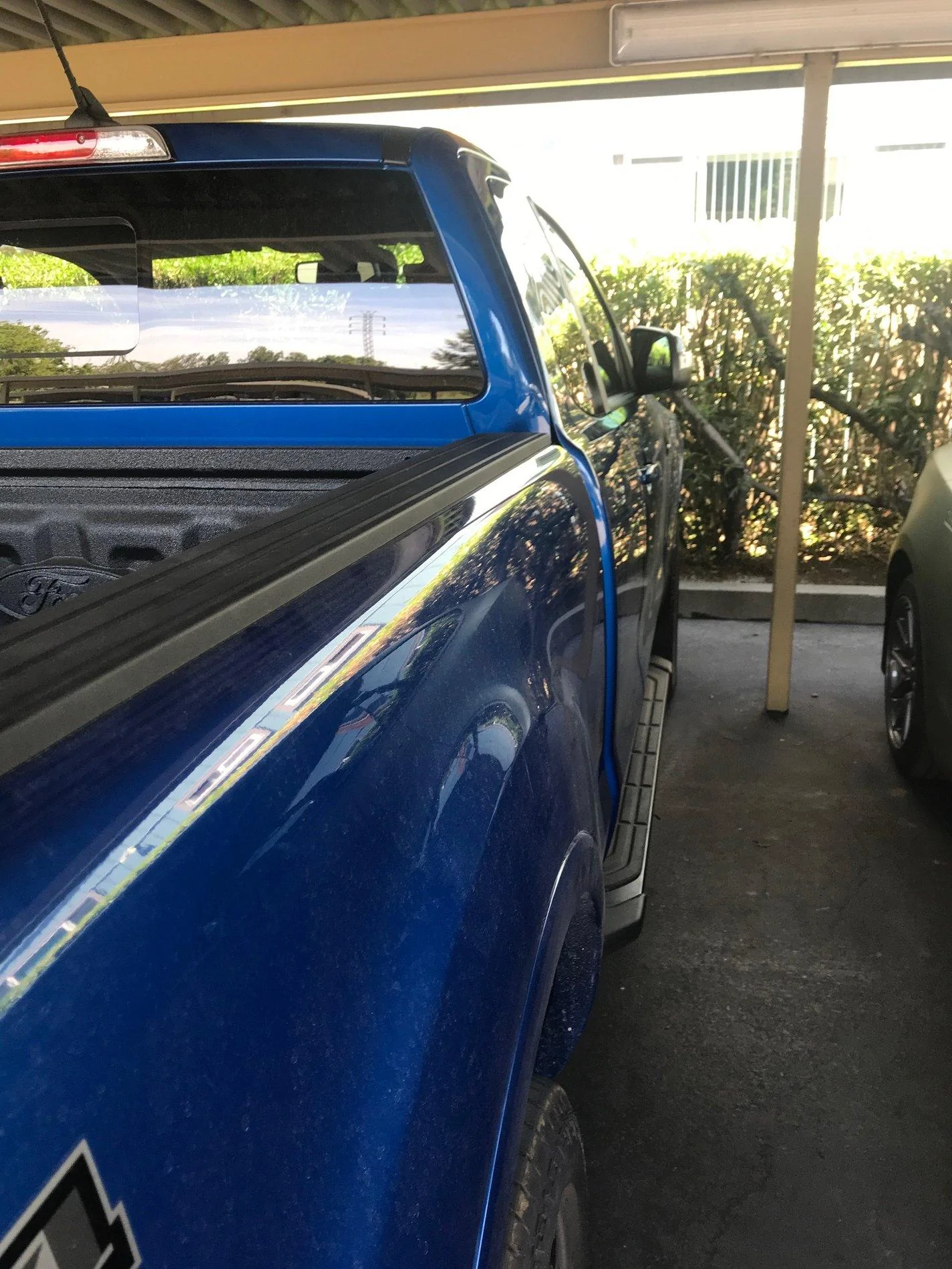

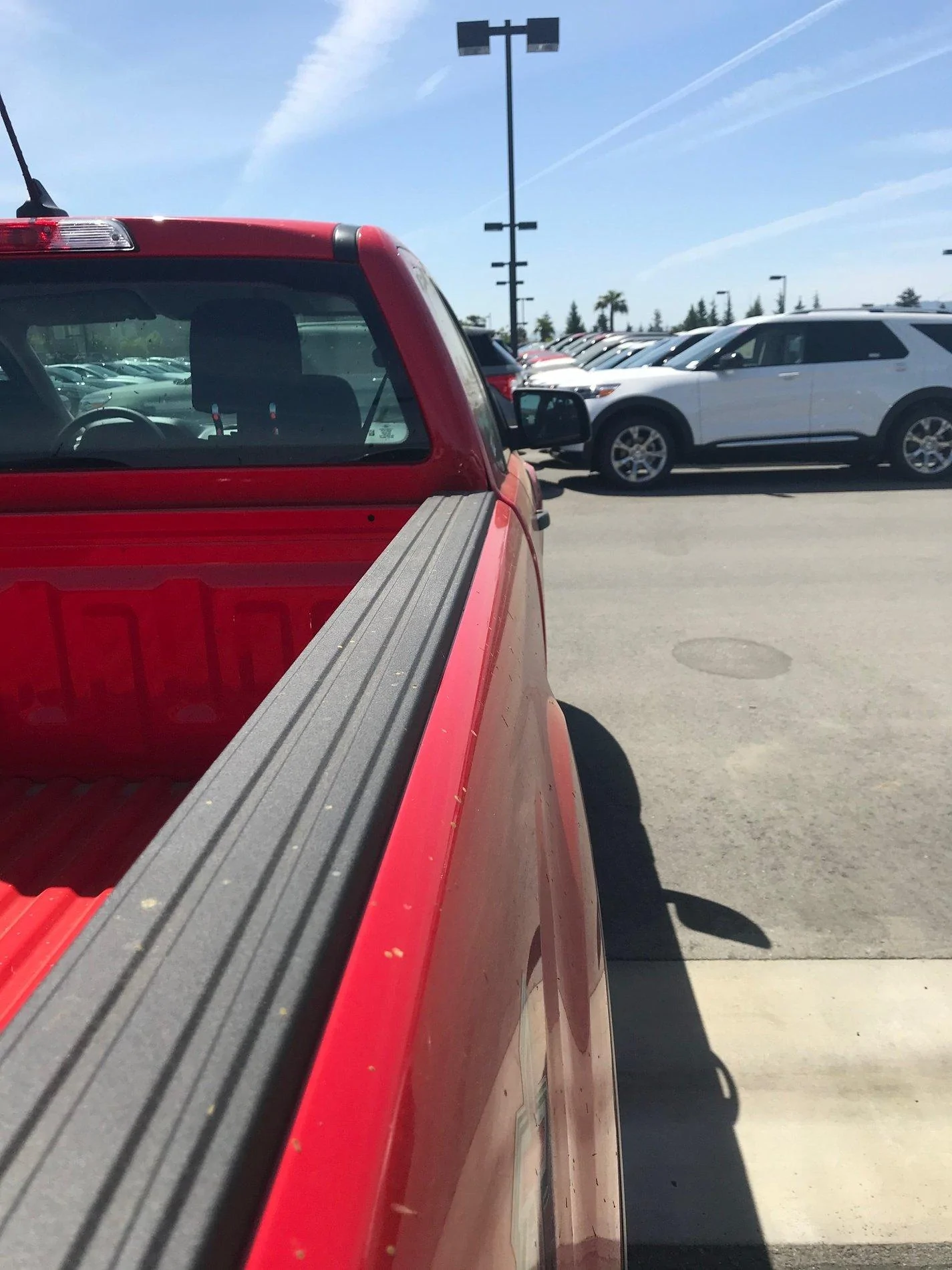

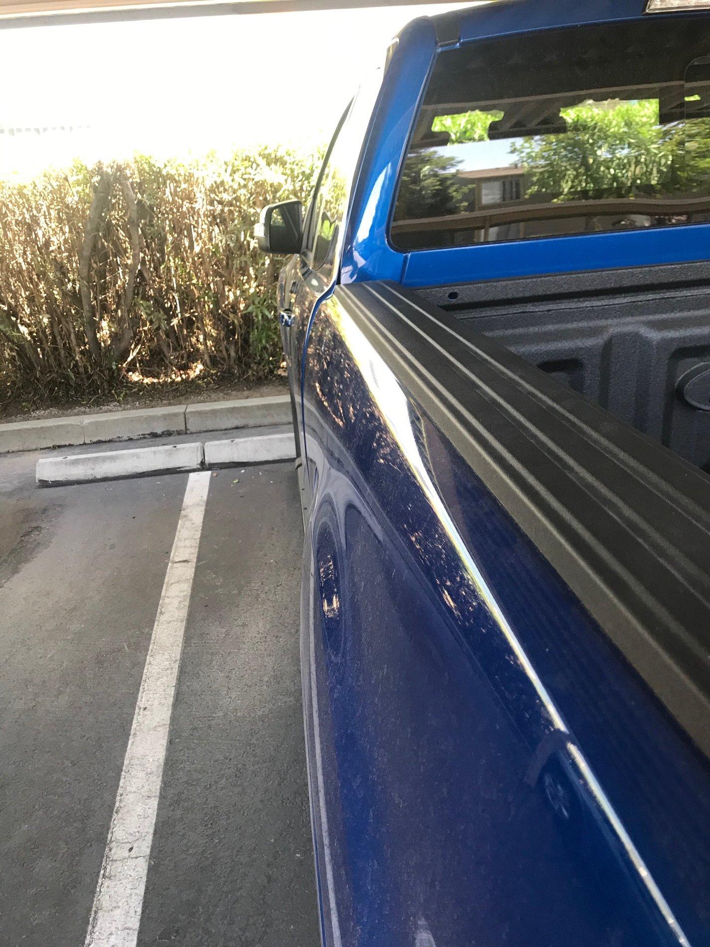

The latest on my wind noise search:
My truck - 19, supercab, Lariat, 10/19 build date, wind noise from passenger rear door.
So far I've replaced tires, front/rear weather stripping, and the front window run channel with no luck. All of this was out of my pocket because my dealership has been horrible to deal with. I've also had the doors adjusted (gap between the doors was 3x the drivers side) and the door tilted in (door stuck out the top much more than the drivers side). Every window edge has been taped with no change.
I left my truck at a local body shop all week and they noticed the the cab and the truck bed don't line up on the passenger side of my truck. Standing behind the truck you can see on the drivers side, the rear door and the cab are flush. On the passenger side, the bed sits in about 3/4" compared to the door.. They noticed this when I shorter driver adjusted my mirror and couldn't see the truck bed. They taped off the gap between the door and the bed and said there was a noticeable difference in wind noise. They loosened the bed to adjust it and noticed it was pinned in place with no side to side way to adjust. They said they'll either need to drill the bed to adjust, or move the cab. Since they have no other Ranger to compare it to, they asked me to go to the dealer and take pictures to compare. This isn't a cheap repair, so I'm hoping I can convince the dealer to pay for it.
I'm going to my dealer later to compare my truck against the ones on their lot. Fortunately, they have a lot of supercabs to compare my truck to (supercabs are rare around here). I'll post what I find later, and a few pictures if the trucks on the lot don't match my truck.

On my new 2020 SuperCab I noticed that the passenger rear door sticks out like an inch further than the bed . I noticed right away wind noise from that side . Took to dealer and they sent to their bodyshop and they only I would say brought it in 1/4 “ . The rear passenger ajar light would come on when you made a hard left turn . They were able to fix the warning light . I read somewhere else where there’s an exit air vent behind the rear passenger seat . When traveling at freeway speeds I noticed if you push in the cabin air recirculating button it does quiet it down a bit . Love my new Ranger for a lot of reasons but they really need to work on quieting the cab and I can’t believe Ford is putting out new trucks with body panels not aligned !
