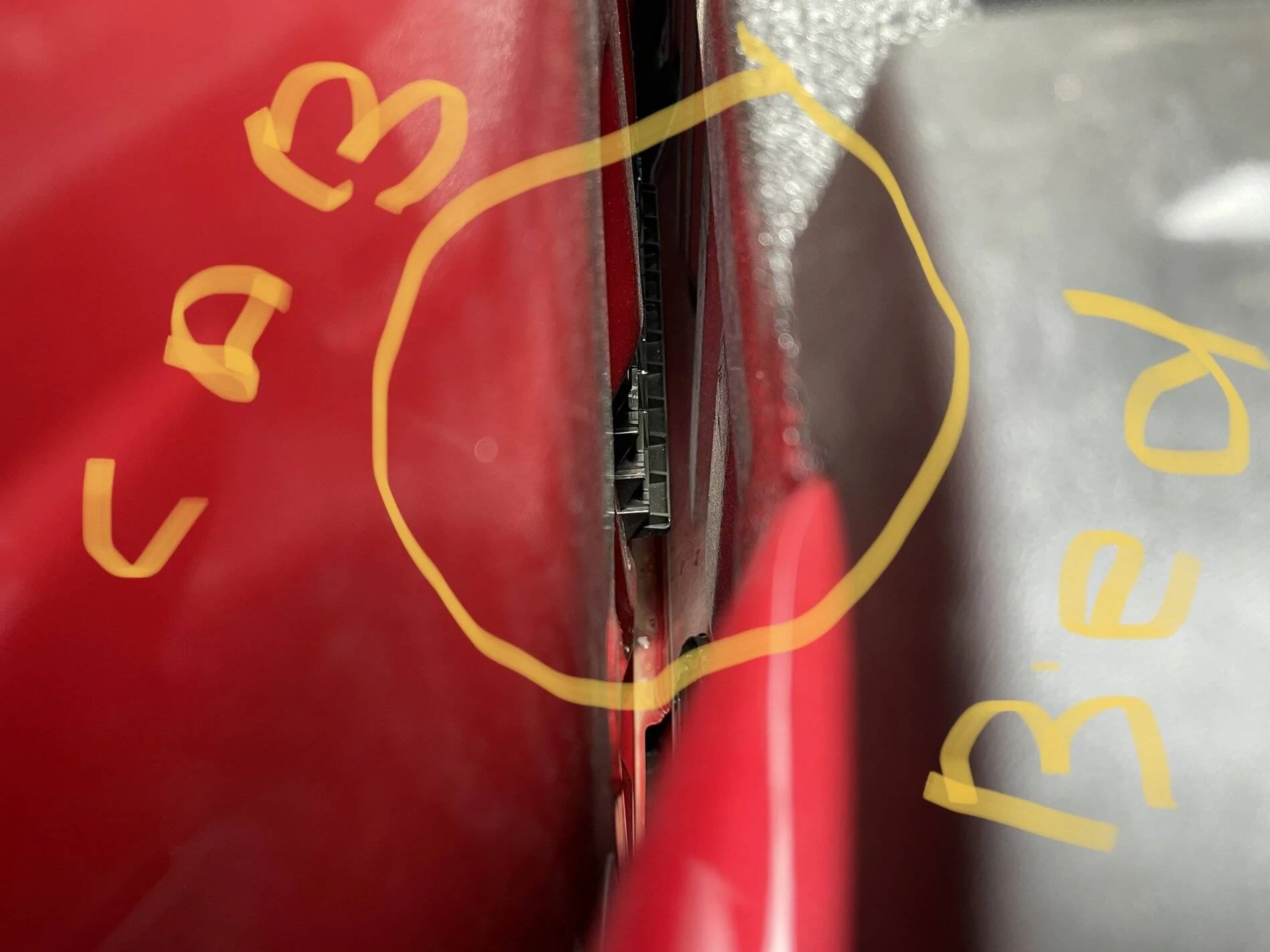

Someone posted that their cabin air vent (behind rear seat) was installed backwards and allowed water to enter and dampen the carpet. He even posted photos, look between the bed and cab and if you see a small black 'shelf' that may be the issue. You can't see them from the inside without removing the sound deadening material.

Here’s a thought Bret…
Others have noticed a felt-like fabric sandwiched between the cab and bed that collects all kinds of leafy debris. If you have that same thing, it could be letting the odour in through the vents behind your seats whenever it gets wet.
It’s worth a look.
It’s worth a look.
Do you remember what thread that was in?
