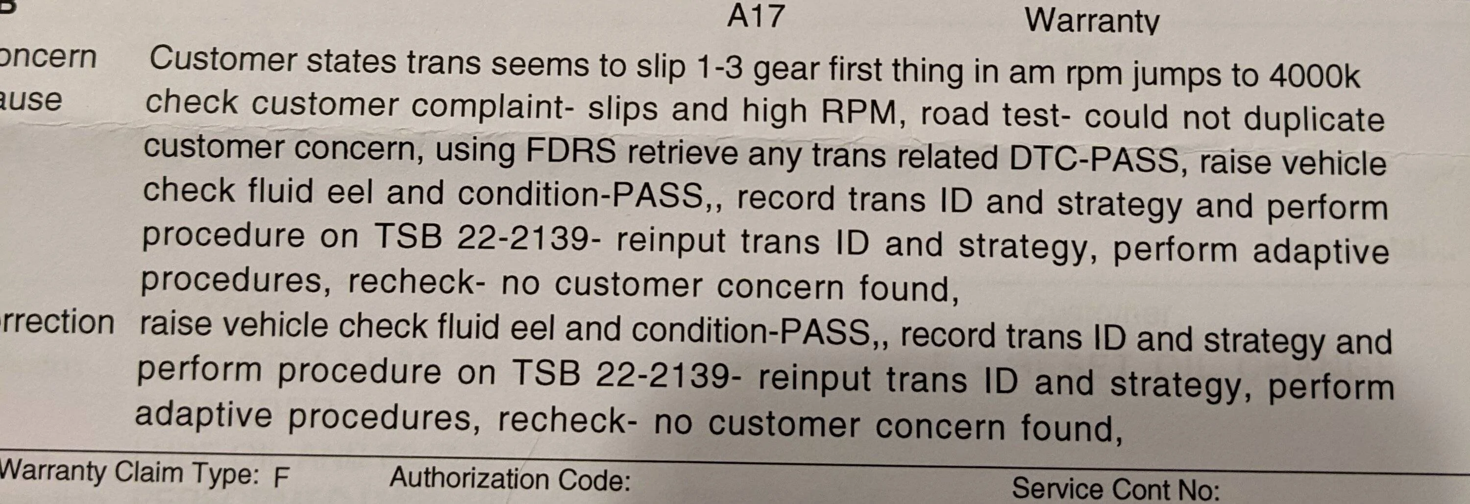

It's still in adaptive period. Mine was fine until around 10k miles. Then I got the skip second shudder. There's a TSB on it. They reset whatever controls the shift points. Now I drive less Granny-like and I'm at 17,000 without a repeat of the issue..
Can you please list the TSB number for the 2022 year? I would love to have that TSB done. So are you saying it should not skip second gear? I have never see a transmission do that before so if there is a fix that will correct that I want to have it done ASAP. That can't be good for the trans or the engine.

Mine only did it when cold. Once warmed up, the issue went away. I assumed it was trans fluid level but they checked it and it was ok. Since the TSB everything has been great but I didn't start experiencing it until 10k miles and I haven't reached another 10k since. The real tell will be whether or not it returns before I reach the second 10k.

It's is normal for automatic transmissions to skip second gear (or any gear) under the right conditions but not every time. Mine was jumping 2nd when it shouldn't have and was causing what you described.
