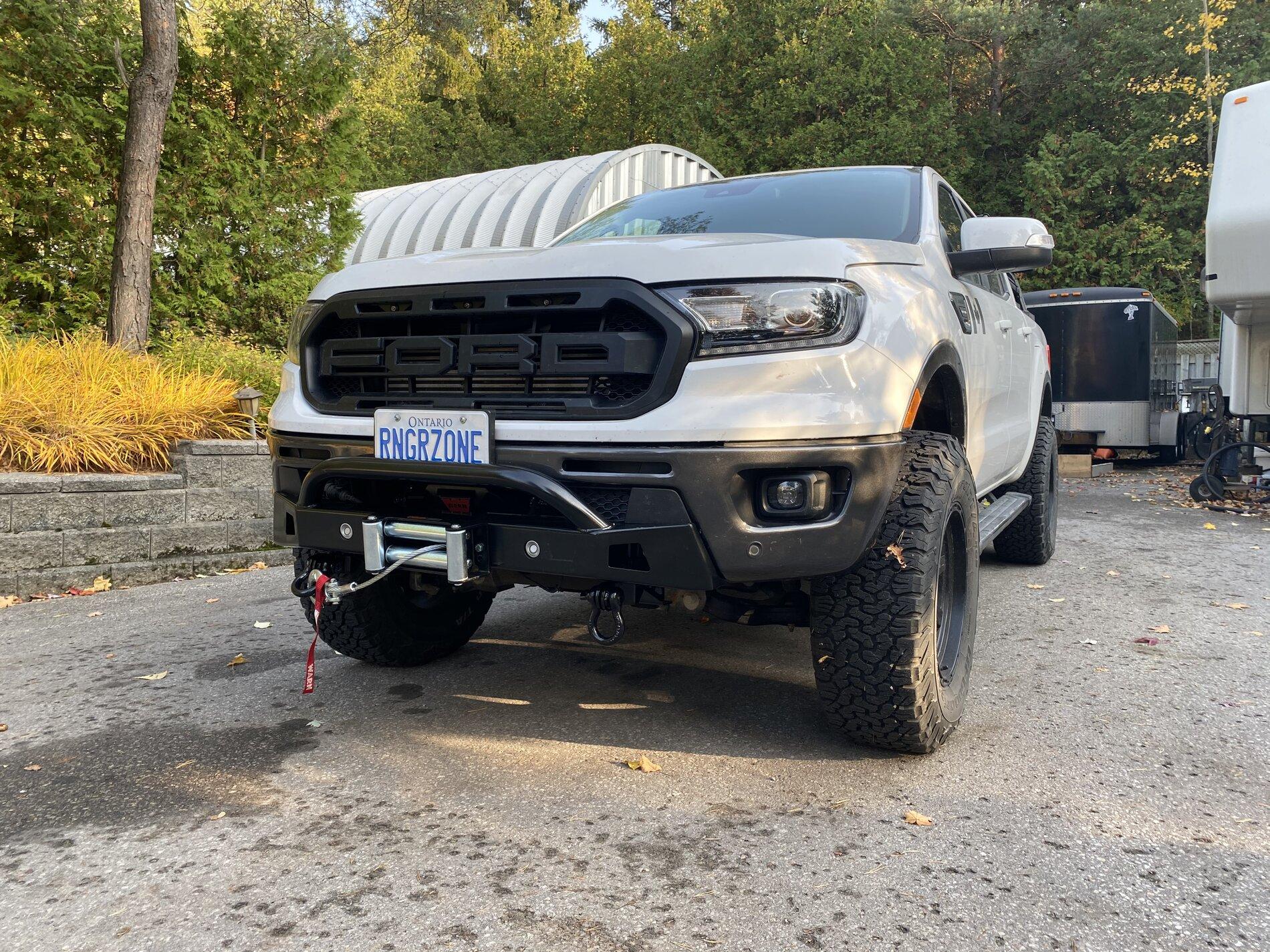

I got mine this week and installed yesterday. Took a lot of effort and the instructions are not great. Had to redo some work I could have avoided with the right order of operations.
I paired it with a warn Xeon and it fits snugly. I had to mount it on the plate before lifting it into place because the winch wouldn’t pass the front plates. Very happy with the quality.
Also it definitely sits closer to the bumper then I thought. Mine squishes the license plate.

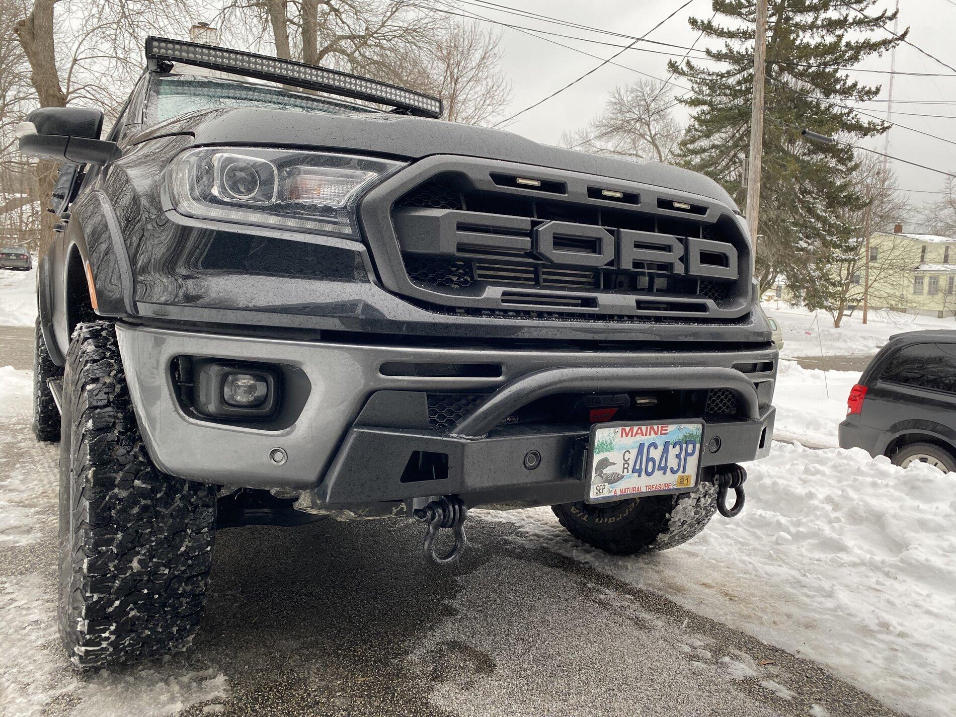

Hiding the winch cable behind your licence plate? Hows that work?
No sarcasm. Thats a clever way to partly stealth away your winch.
Shrockworks’ license plate bracket is quick release, fairlead behind there. There isn’t a ton of room so I keep the winch hook in the truck and pop on as needed.

@rngrzone , Is there a dealer in Canada you purchased yours through OR did you get it direct from the US?
direct from the US. they hand make them by order. shipping was $131 It came over UPS and I paid ~$250 in taxes/duties.
