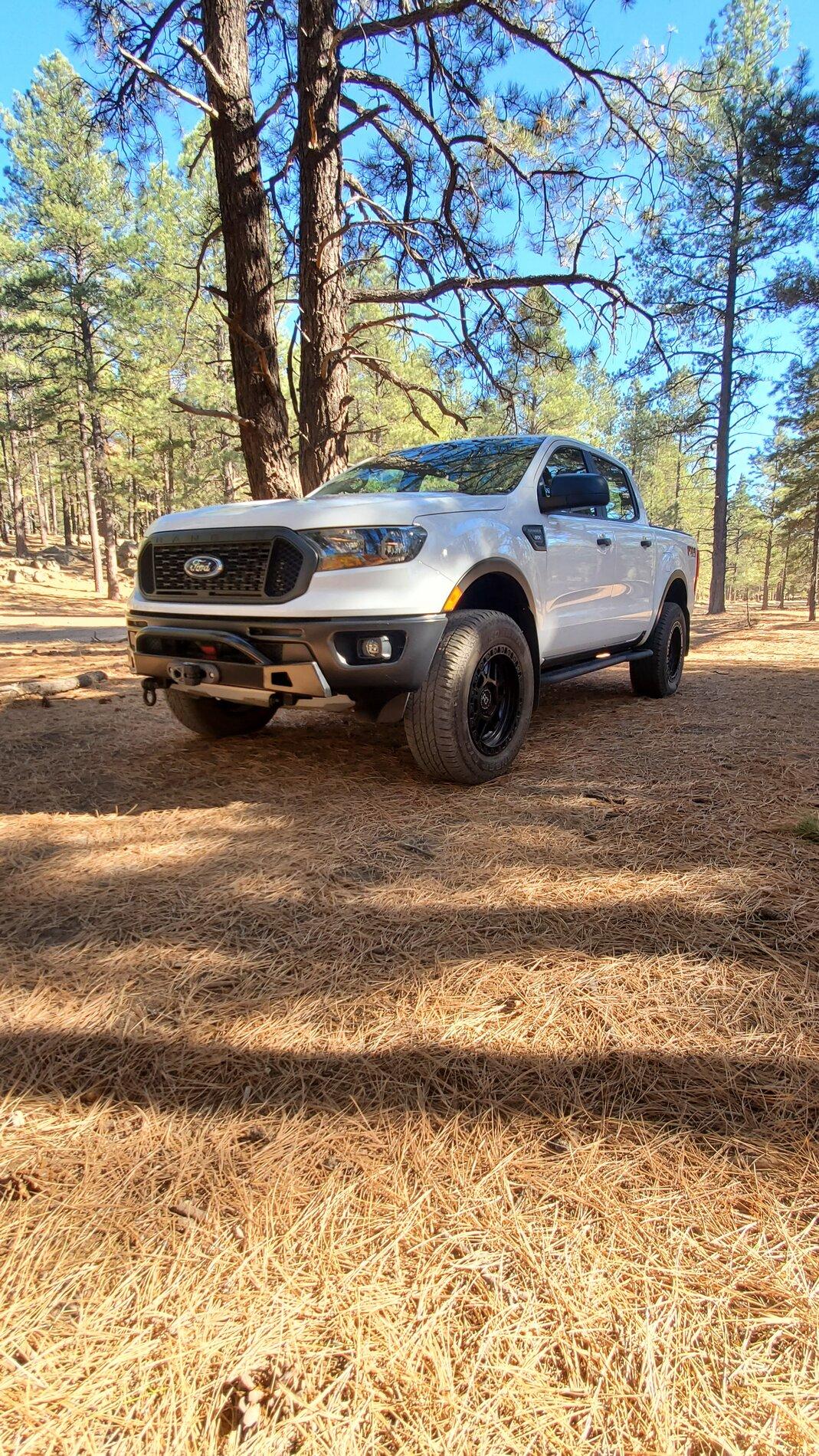

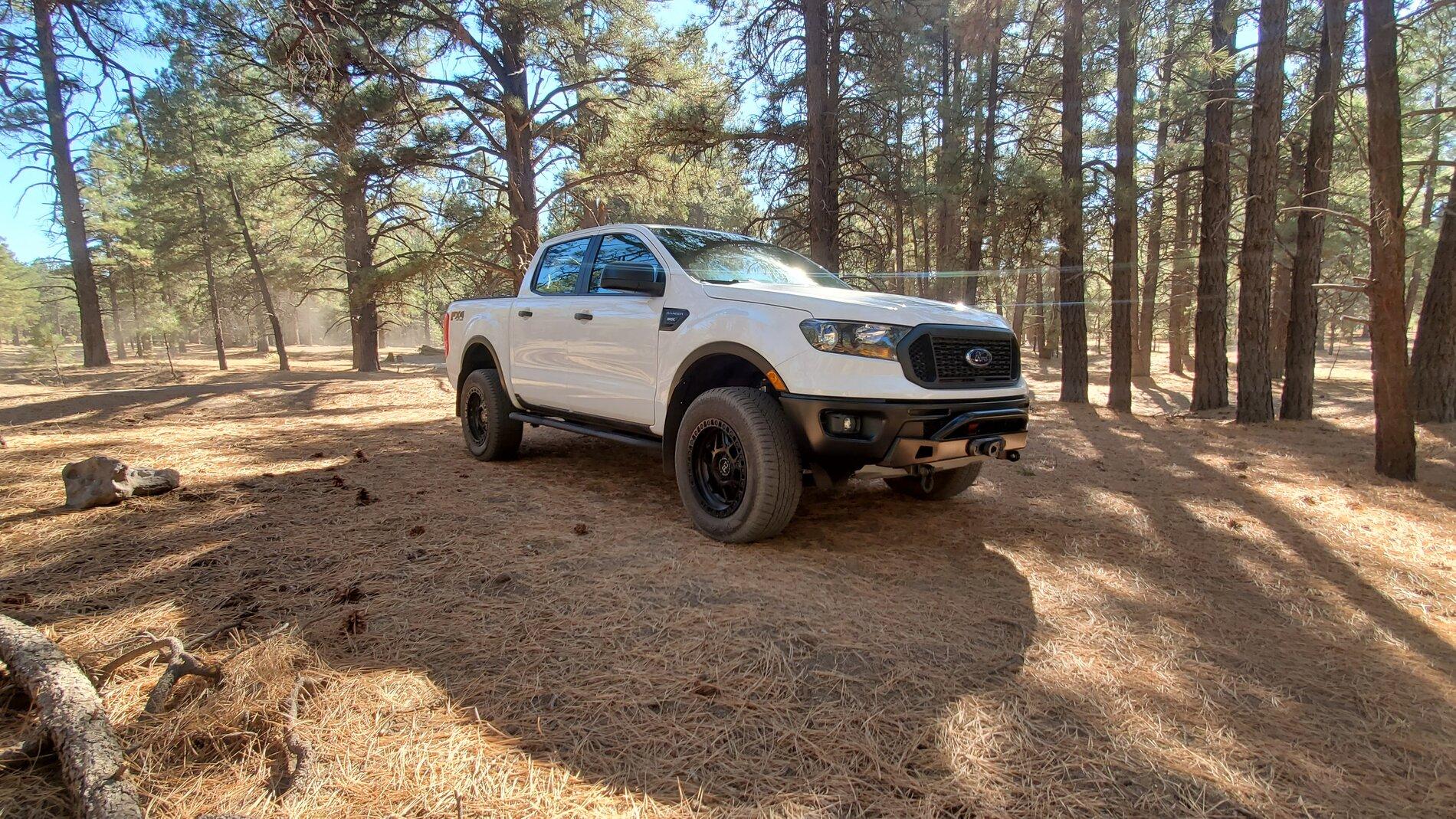

And yes, I put a fairlead on!
Overall happy with the look. The install wasn't that bad and would go much more smoothly with a smaller winch. The instructions could have been more clear, but I've seen products come without instructions completely, so at least they provided some.

Man that looks great. So well tucked. Been drooling over this. Now I am twitching.

If those pics weren't enough... :) Im very happy with it
That just looks awesome. I can feel my credit card jumping in my wallet. Nice rock sliders too! Did you do any skid plates?

So far so good... I live off a cinder road so its hard on the paint. We'll see how it holds up over time, the body paint hasnt held up so well haha
