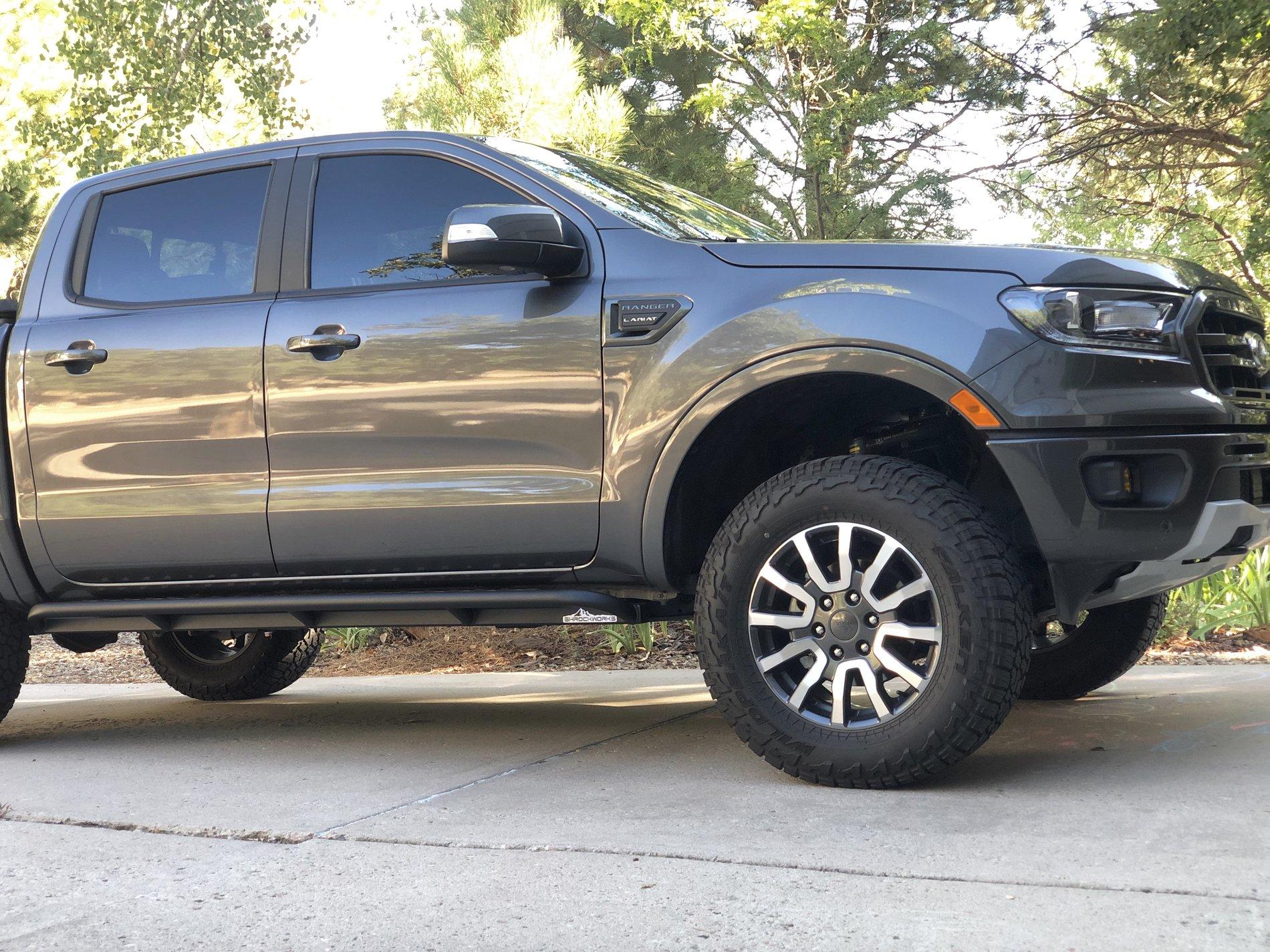

Not a bad price for sliders. Are they robust enough to actually act as a slider or are they just a step.
I wasn’t exaggerating when I said “it’s probably the most sturdy part of the truck now.” What you’re looking at is thick-walled tubular and square steel. The frame will bend before these sliders do.

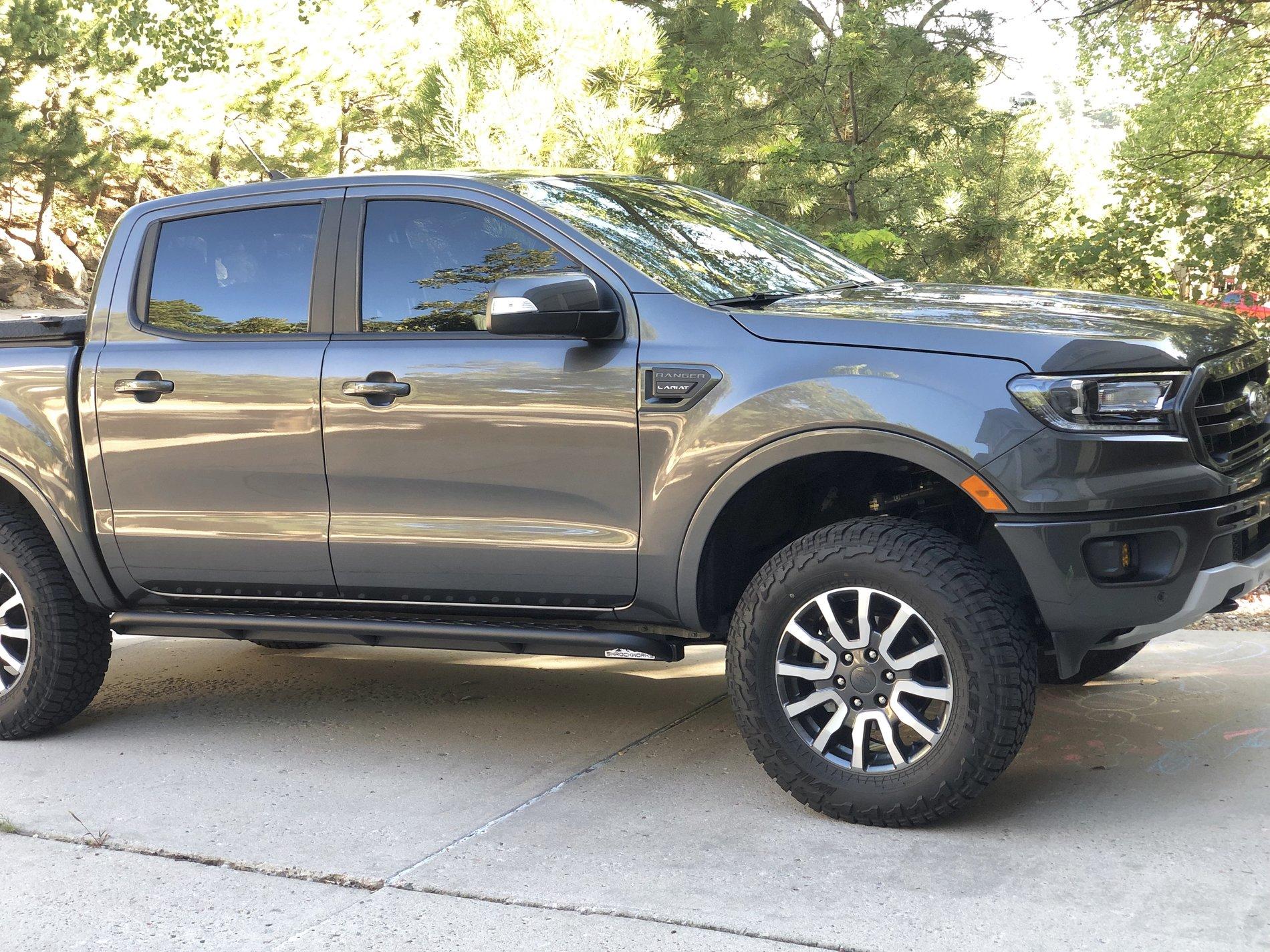

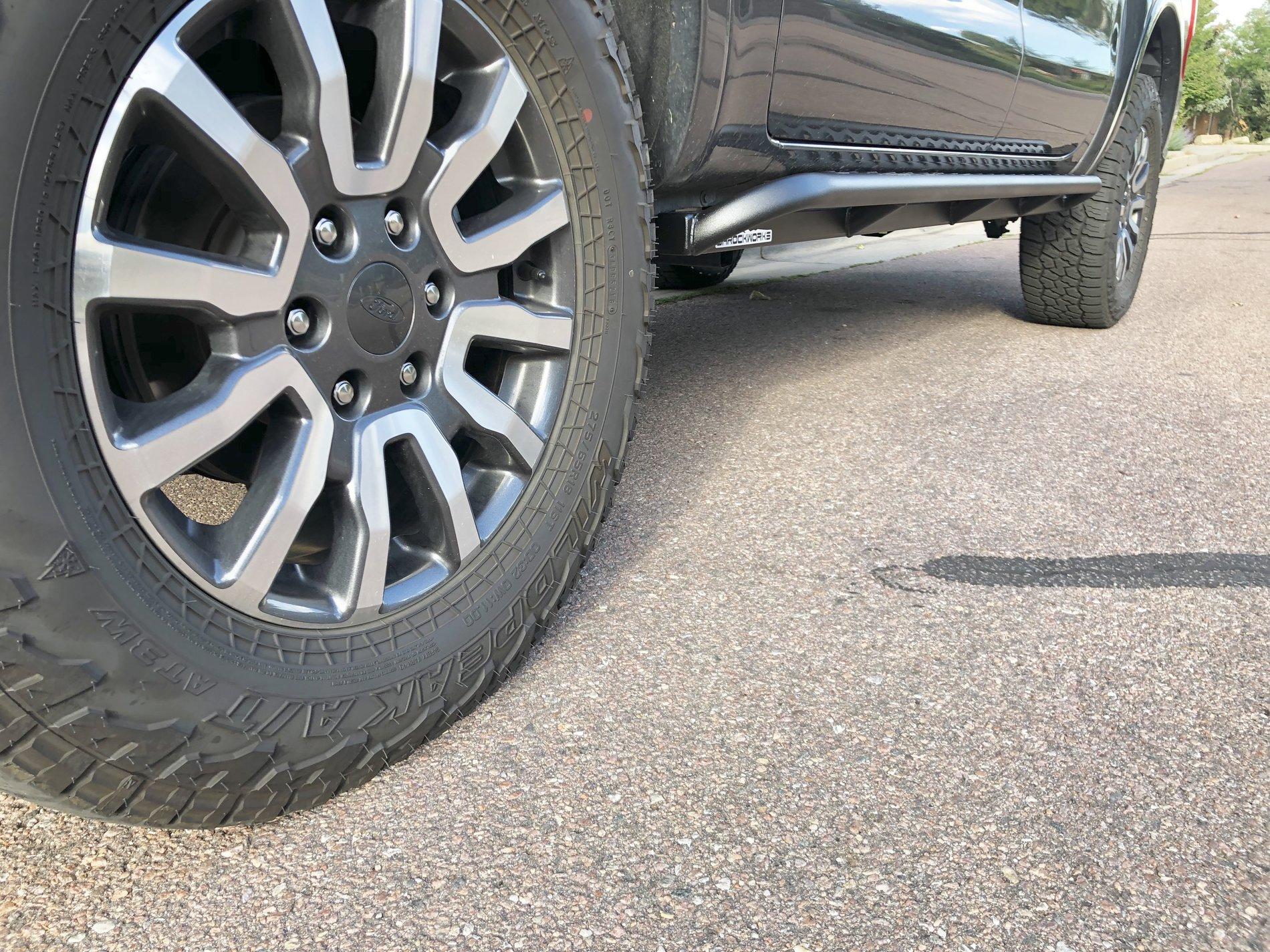

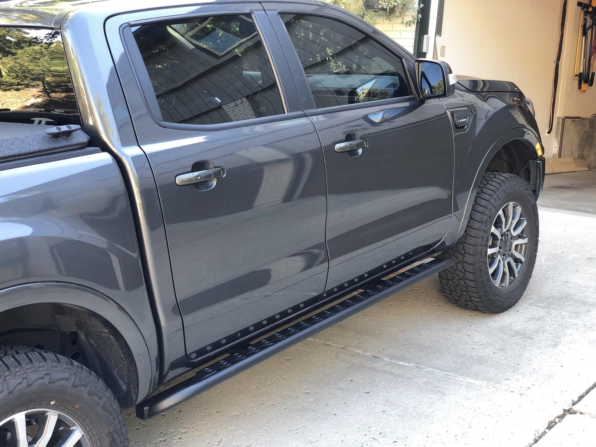

Alright truck is washed up, here’s some more pics. I took some pics low and away so you can see the underside of the truck. The sliders are flush with the frame so they don’t cost you an inch of ground clearance. And they do a nice job of cleaning up (covering up) where the body meets the frame. The Shrockworks decals didn’t come installed, and I’m not typically a decal guy, but I thought they have nice logo so I thought I’d try it on.

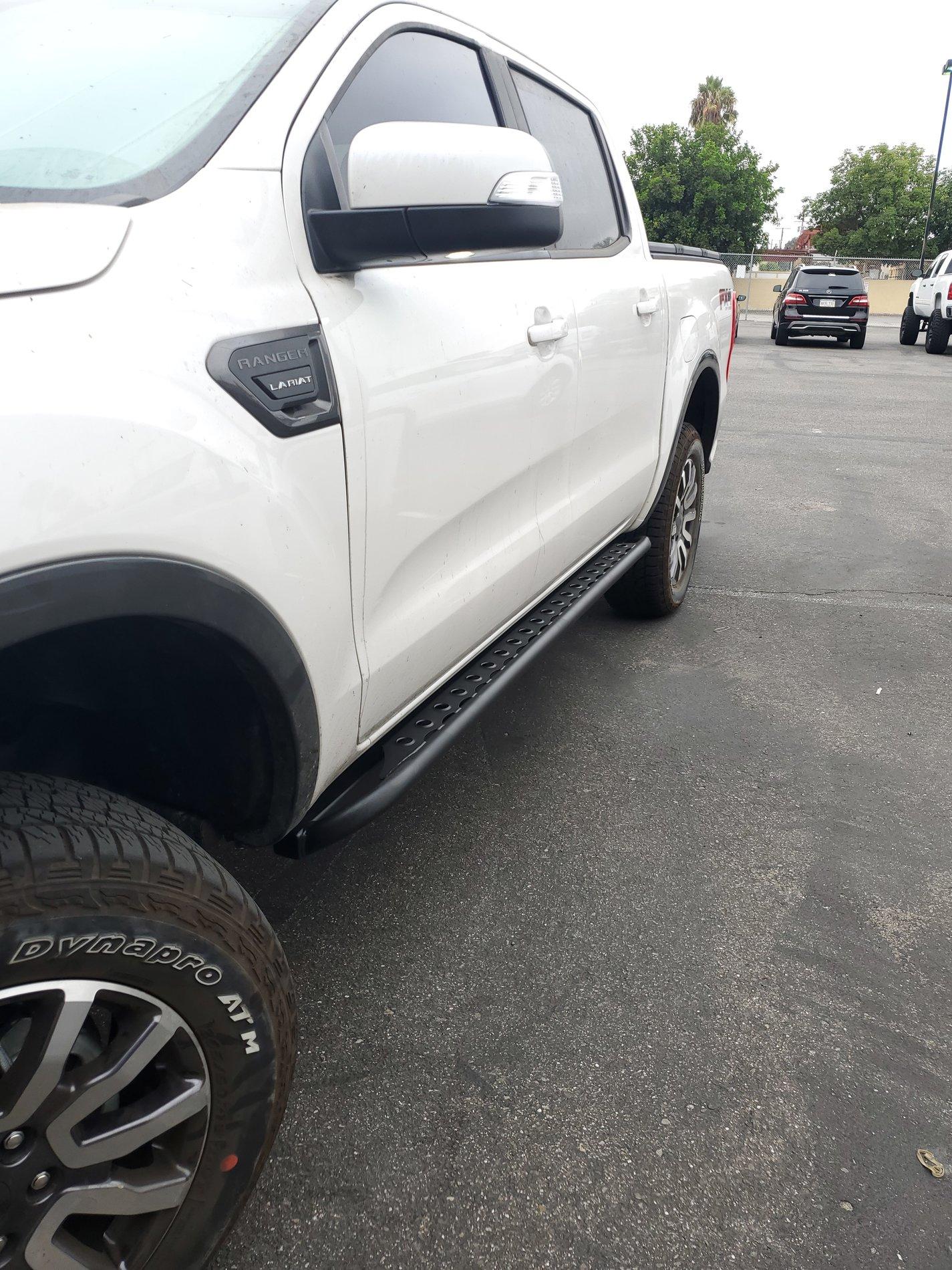

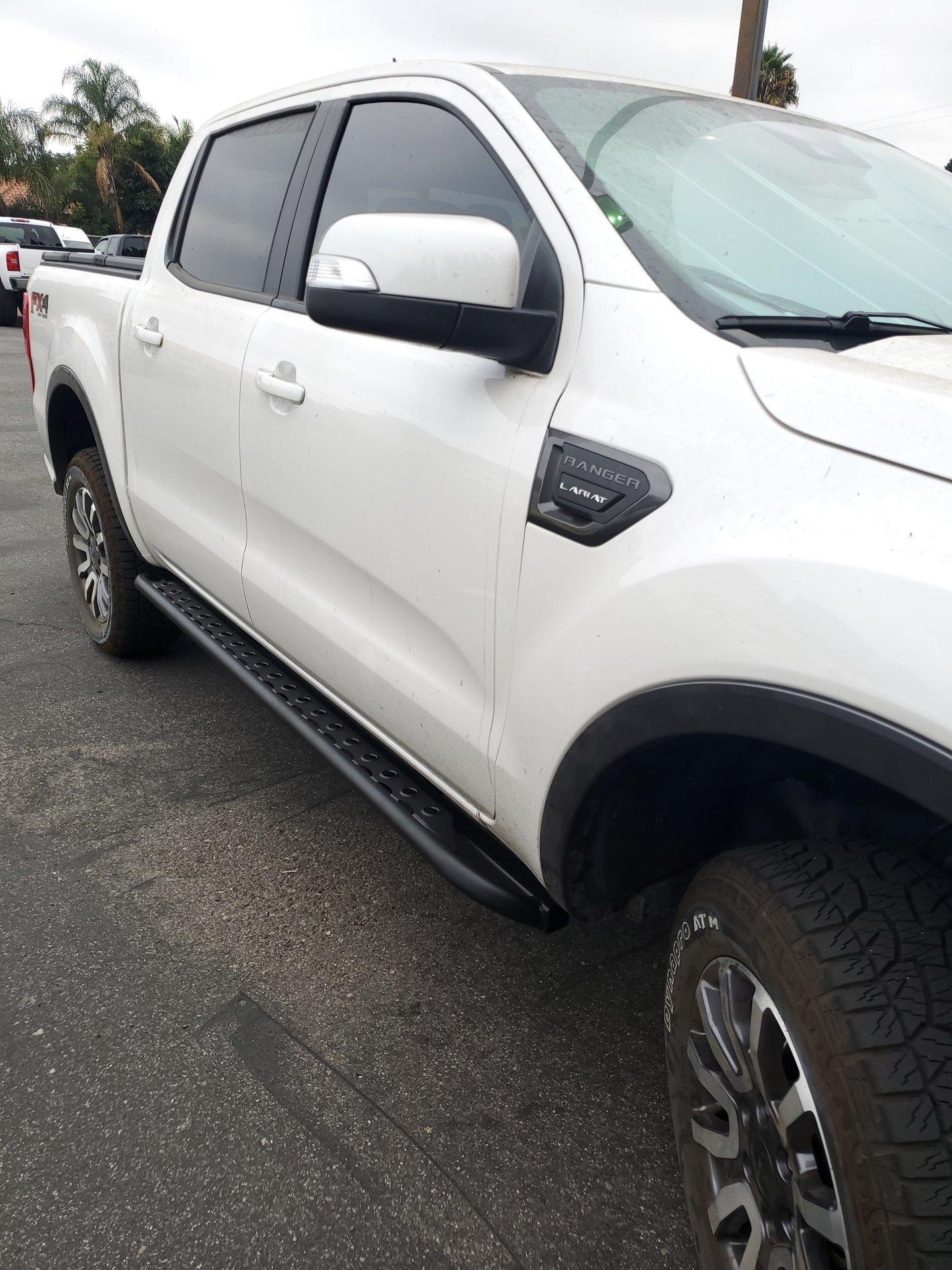

Just installed mine. Customer service was A++, the quality was perfect, and the install could not have been easier. These are hands down the best sliders I have ever installed.

I bent the tabs in towards the frame and backwards so they wouldn’t catch/collect anything and also centered inside the oval hole so they wouldn’t chatter against the frame. So long as they don’t chatter I’ll leave them alone, but if they do I’ll use a small screw to secure them to the frame.
