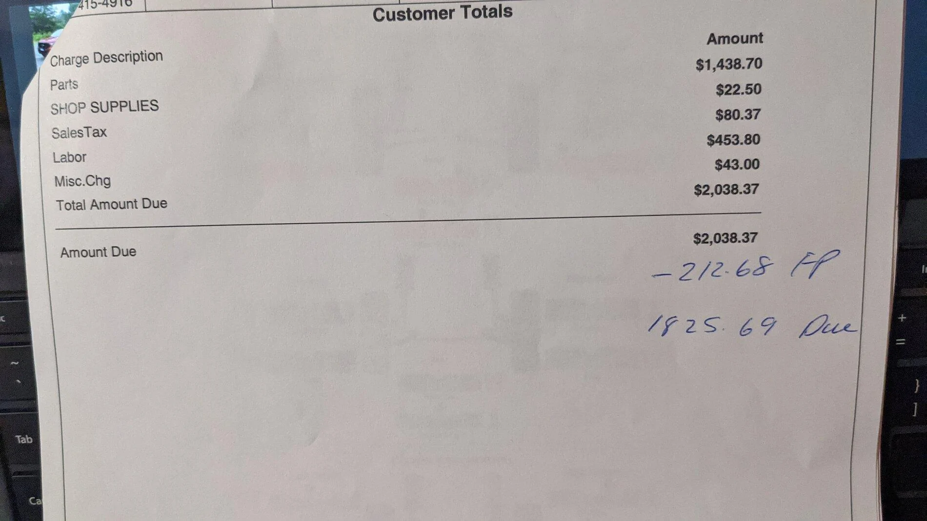

From my understanding of FPP, the dealer has to be an approved FPP dealer. I had my FPP Fox shocks installed today. I had to drive 30 minutes away to another dealer.
It is a noticeable ride difference. I didn't mind the soft suspension. I didn't particularly like the wallowiness, but it wasn't a deal breaker. I didn't like the nose down stance, the way it comes from the factory. I like the way it rides better, now. On the road, at least, its better. The dealer I purchased the truck from wanted $3000 for the same thing. The above price included a 4 wheel alignment for $100.
Worth it, so far.
