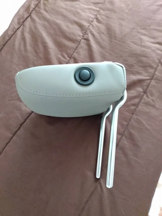

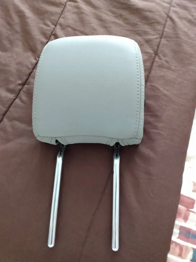

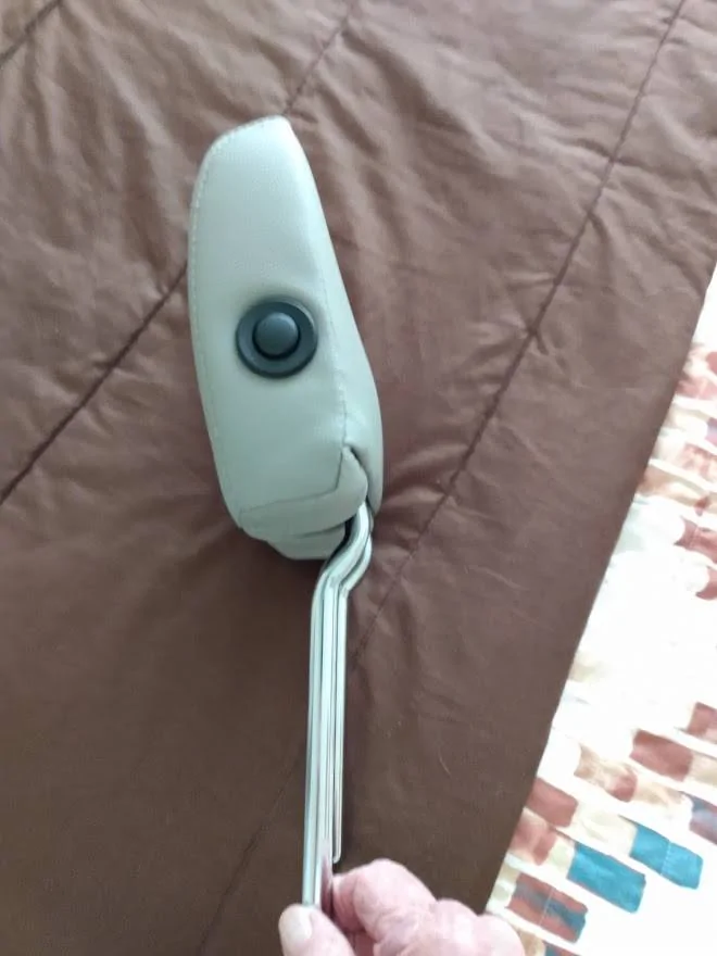

Interesting. So -- what's the difference with the new headrest? any photos?
These replacement head rests can be adjusted up & down and also removed by a button located on the plastic base that is attached to the top of the seat. They can be tilted by a button located on the head rest itself :)

Had my recall done several weeks ago, new head rests were ordered and came in a week later.
Have em stored as I did a rear seat delete, but here's pic's of what they look like...
