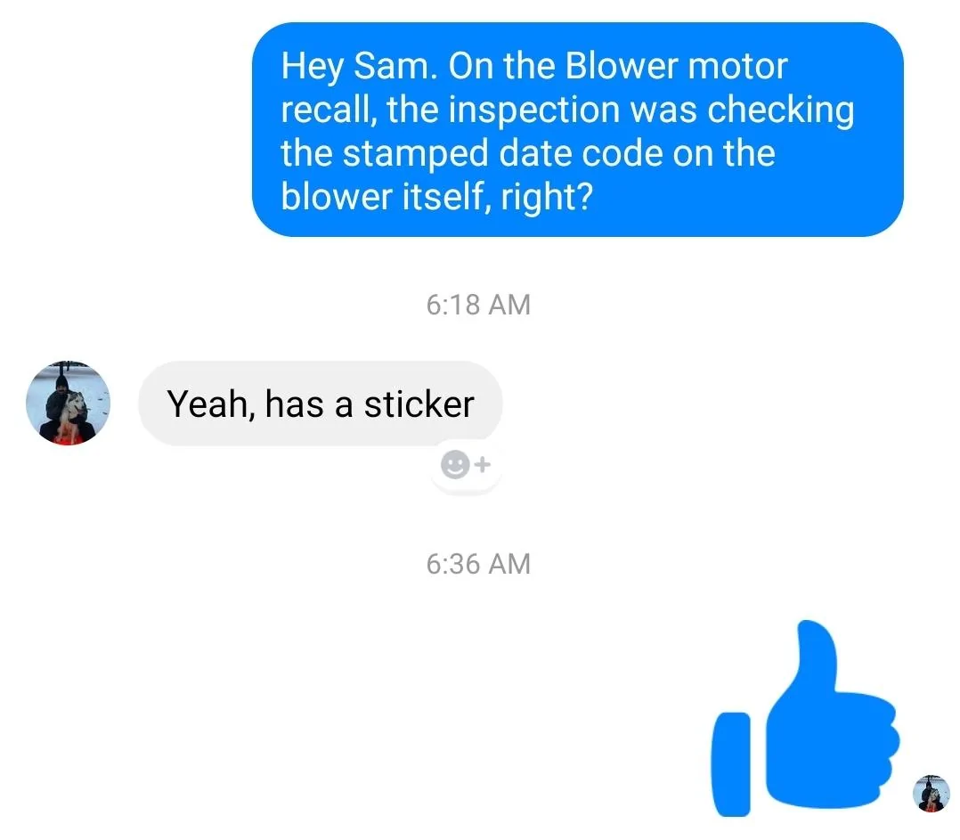

This is not true. It's based on the stamped date on the motor itself. I don't think you even have to remove the motor to see the date code. You should be able to stick your dome and a flashlight up under the dash and see for yourself.

It's a visible sticker on the outside of the bottom of the blower. This is the tech who performed my recall.
