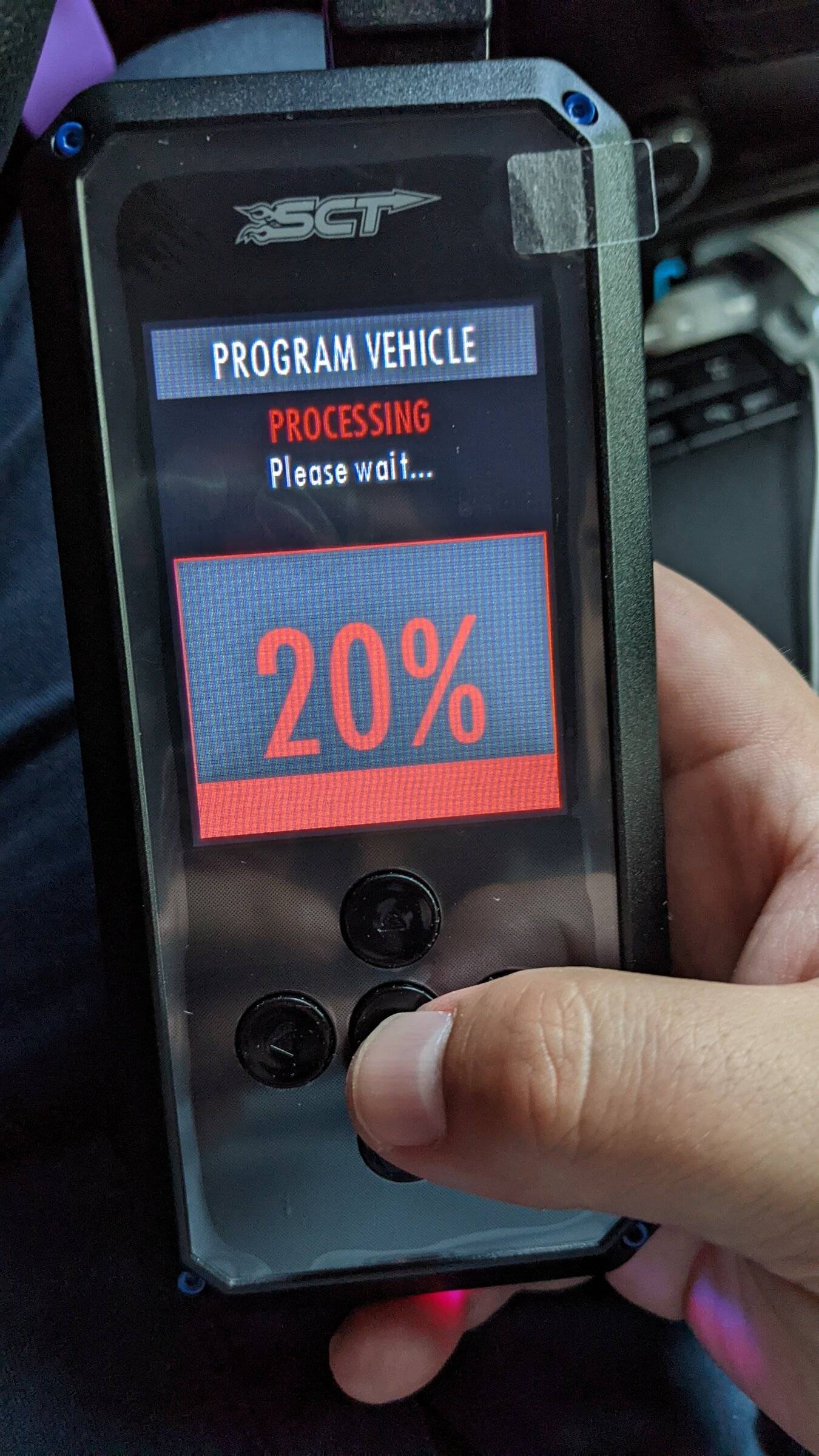

SCT just released an update for the SCT BDX. I updated my SCT BDX. I loaded the 91 Octane tune & WOW what a difference. It feels like a different vehicle in a very good way. Very happy with the update !

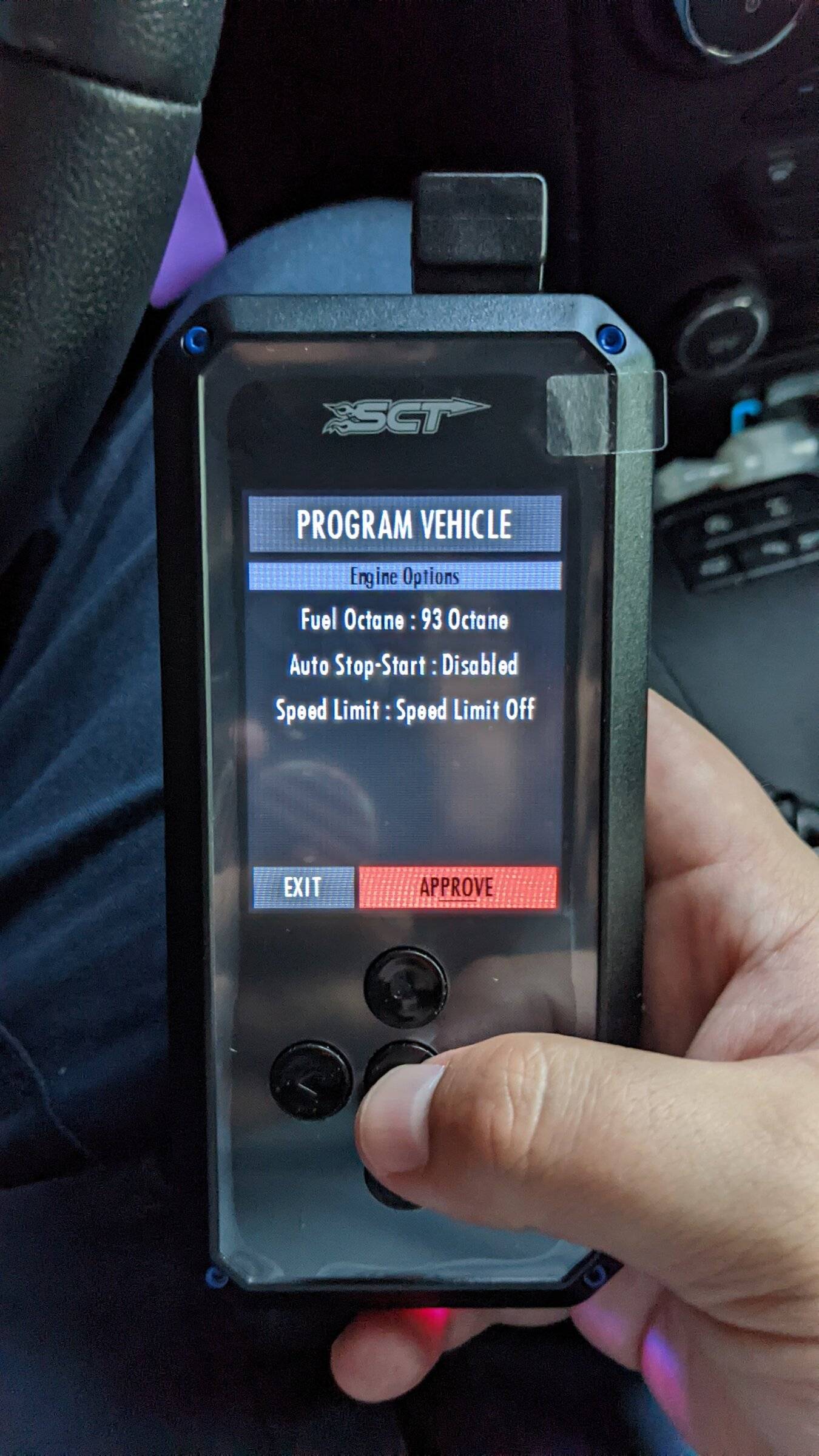

So I just used my BDX for the first time today and loaded the 93 octane tune. Only drove it in drive and it didn't seem much different it actually held 10th gear easier I guess to save gas maybe? And first wasn't this long rev like normal it was quicker I liked that. I'll throw it in sport tomorrow and see how it goes.

Is the red part of the update? Every picture I saw showed blue and the box showed blue letters.
Edit: after messing with the settings I found where I could change it to blue.
